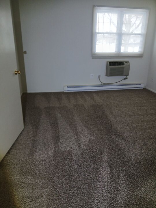

Looks good for what it is, but calling that “extraction” is doing a lot of heavy lifting.
Two bedrooms, hall, living, dining on 3 gallons total isn’t flushing soil, it’s lightly dampening fibers and moving stuff around. True extraction is about rinsing and removing suspended soil, not just scrubbing in encap and wiping the tips with a bonnet.
VLM absolutely has its place, maintenance on CGD, interim cleans, etc., but using it as your only method on residential and comparing it to HWE is like using dry shampoo and calling it a shower.
I always chuckle when VLM guys use terminology like “extract.” Smear, disperse, or hide would be a lot more honest. 😄

Your VLM picture doesn’t prove what you think it proves. Sure, there’s a visible difference. But is it actually clean? No. I can vacuum a hammered room and have the homeowner walk in and say, “Wow, it looks amazing!” and I have to tell them, “We’ve only vacuumed, we haven’t even started HWE yet.” By your standard, that’s done, because it looks better and the customer doesn’t know any different. Just collect the check and move on, right?
Like I’ve said repeatedly, I’m not anti VLM. We use it. It’s a tool. It has its place. It’s just not the magic answer to everything, and it doesn’t replace proper cleaning.
The carpet in your pic is disgusting. I’d hate to think there’s a baby crawling around on that, VLM clean, but I’m guessing that doesn’t bother you much as long as you didn’t have to buy a truckmount and the profit margin looks pretty.

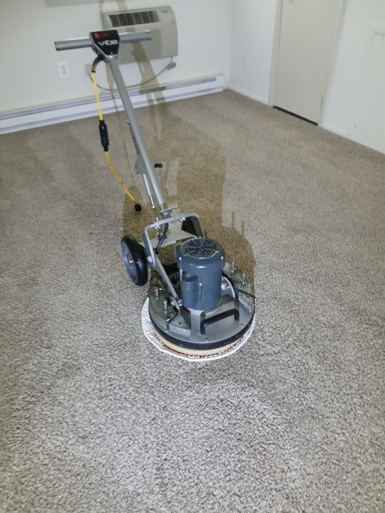

IMO it does need the Weight Kit and Malish Driver for more head weight and the Maish Driver makes it more aggressive
I use 3 weights on each side adding 24 pounds of head weight for cleaning Residential carpet and 4 weights on each side adding 32 pounds of head weight for urine jobs

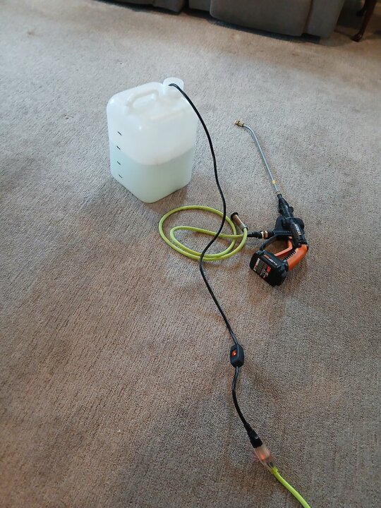

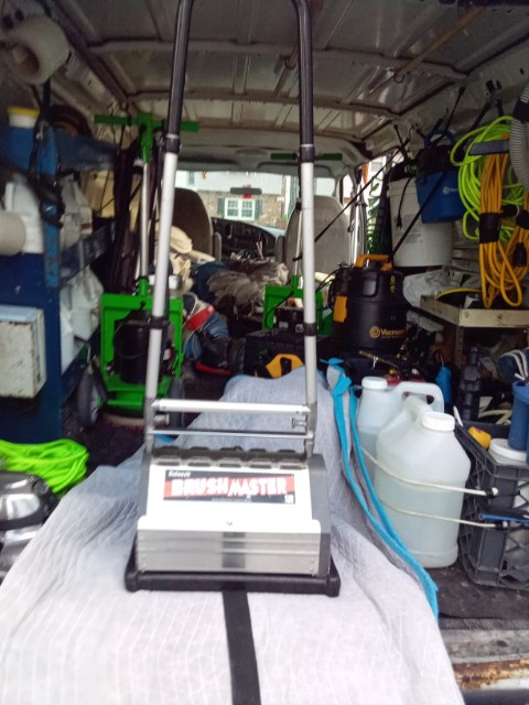

Had some fun at my Apt Complex today doing two Apartments using the Vibe with Bonnet Pro Ironman Bonnets with Carpet Details and VacAway Double Trouble
And I used the WORX Sprayer with the 14'' Brush Master Pro 35 CRB first to scrub, and 10'' CRB to groom
