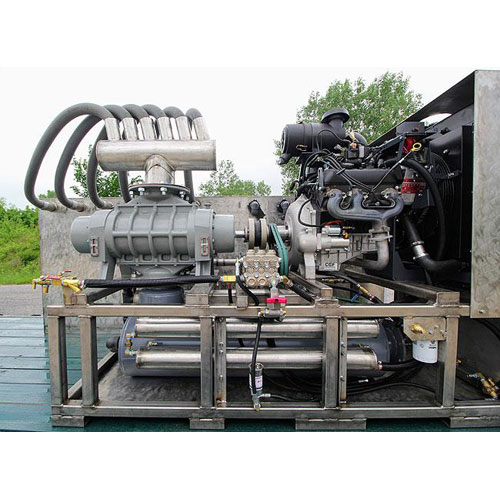

Maximum CFM is only 350, but it supposedly builds lift better than anything.
Steam Action builds a machine with that blower and a 29 hp Kubota.
Anybody have experience with that blower?

when you look at competitors like the Apex 570, the Titan 575, the new Cleanco slide in, they all use the same engine and either a roots 47 or sutorbilt 408 blower. The specs on the 53 blower say max hg is 15. Thats for continuous use. I would rather have more airflow than more inches hg.
So there’s no benefit to steam action running their blowers at 18 inches of lift?
27,884
Any of the other manufacturers can turn up the inches hg. One of my old units had a seized vac relief valve. It would go up to 20 inches if I held the wand down. It will cause the wand to lock down harder but I can't say that it will dry any faster. Higher suction is harder on all of the components. Engine, blower, bearings, belts, etc. I can run my Cleanco 47 at 400 feet and still have decent vacuum. On residential carpet at less than 150 feet, it's all the suction I would ever need. Hard to push a 2 inch wand on some carpets. I have my vac relief set at 14 inches hg. I can't see any reason to turn it up. Go to pdblowers.com and look up the specifications and what the blowers look like. You will see the difference.

I've talked to a couple of guys who have bought their machines. One has the Stealth fighter and the other has the Nike 1000. Both love their machines so far. The Nike 1000 is an air cooled 38 hp Kohler with a 47 blower. Open and looks simple to maintain. All stainless steel including the tanks. They've been building machines since 1975, maybe they've got it figured out now.

What reliability issues have you heard of? When you look at the machine, it looks about as simple as a Judson but has heat exchangers. The pump is accessible from just about every side, everything is just sort of right there in front of you and nothing high-tech. I like how the fresh water tank is the water box.
Should the machine have to bypass water, it sends the water back to the fresh tank.
