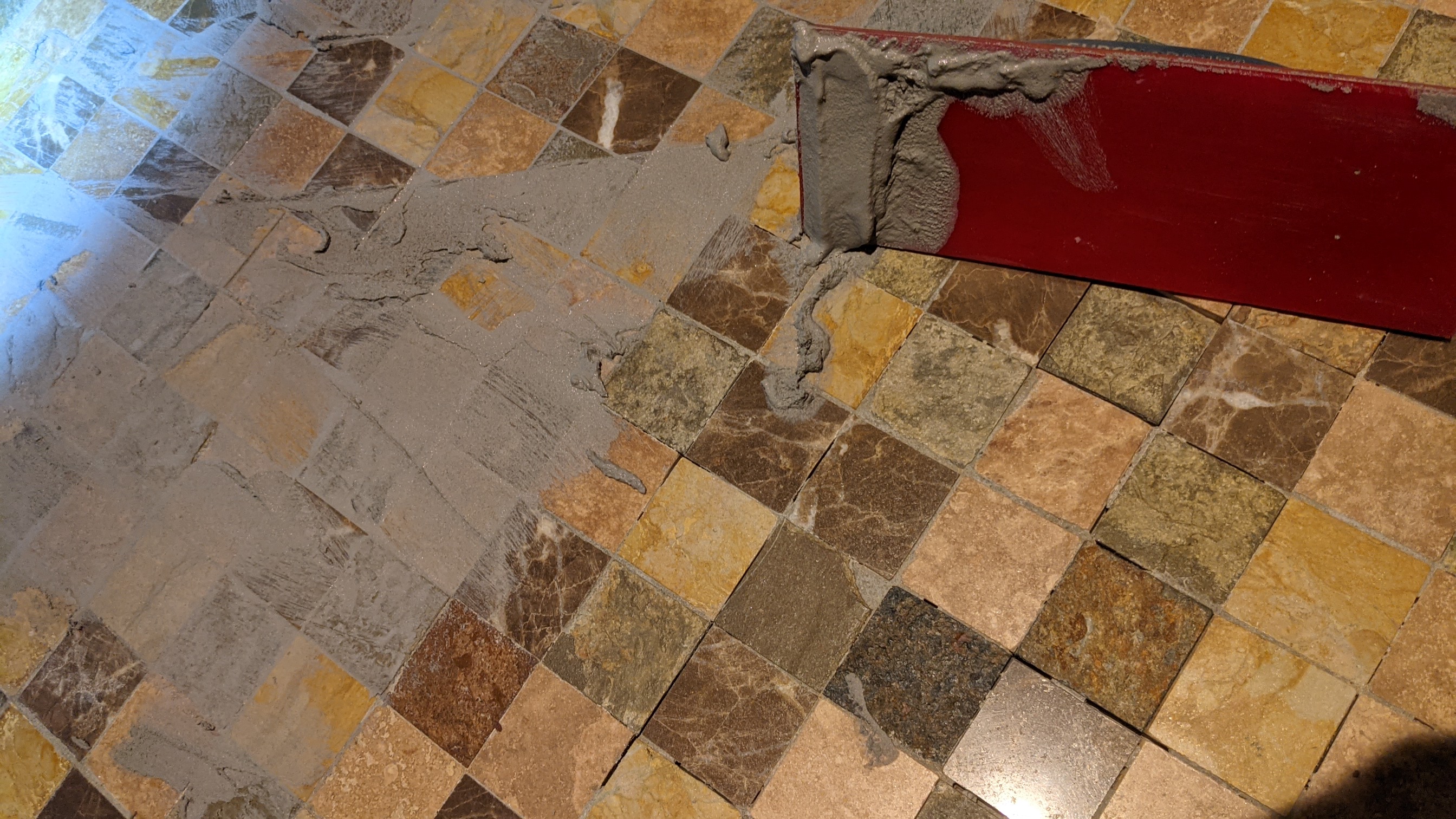

You can't always plan ahead..
This stuff is way easier to work with than the polyblend crap..
