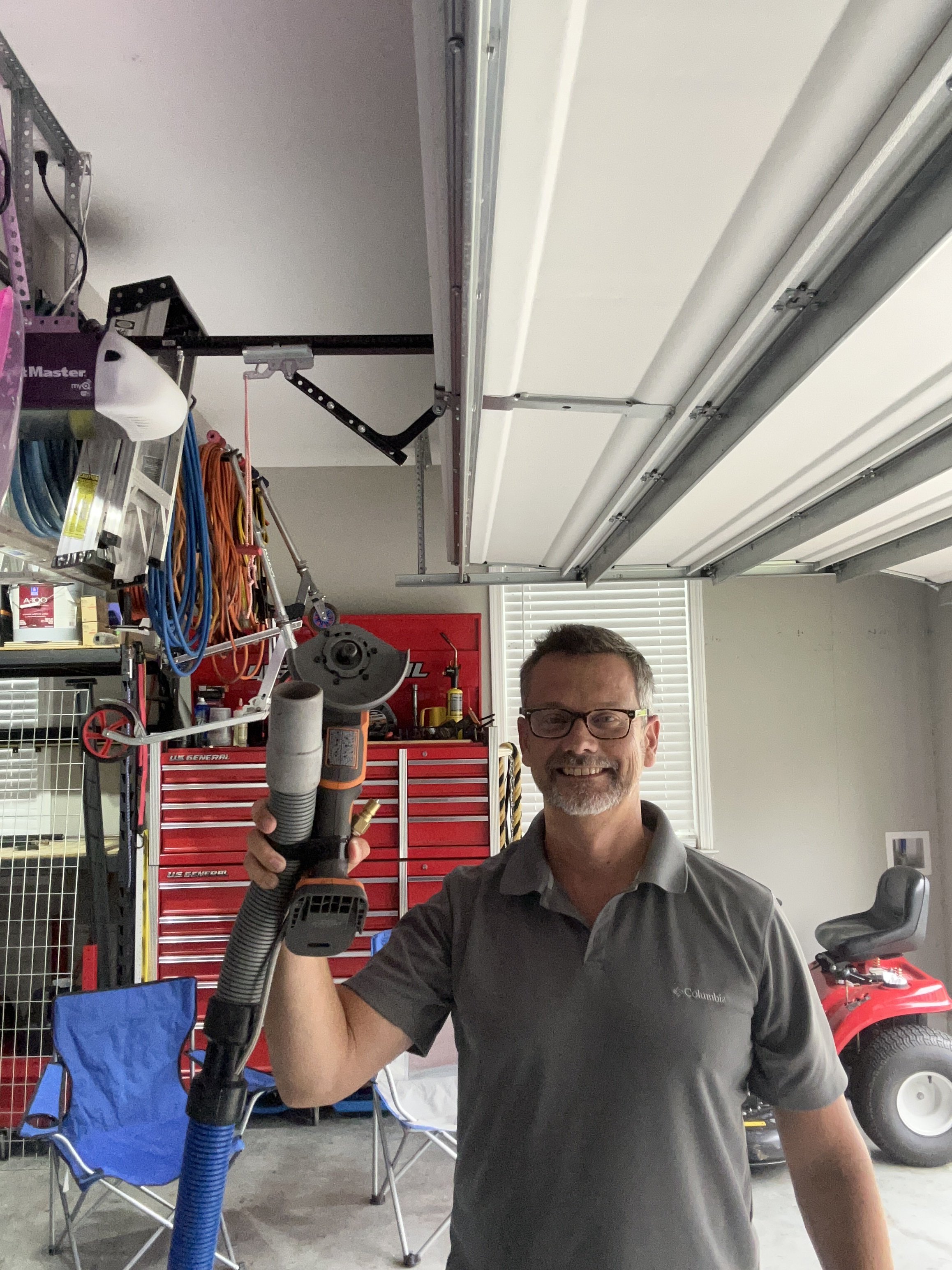

Time to clean some seats!!

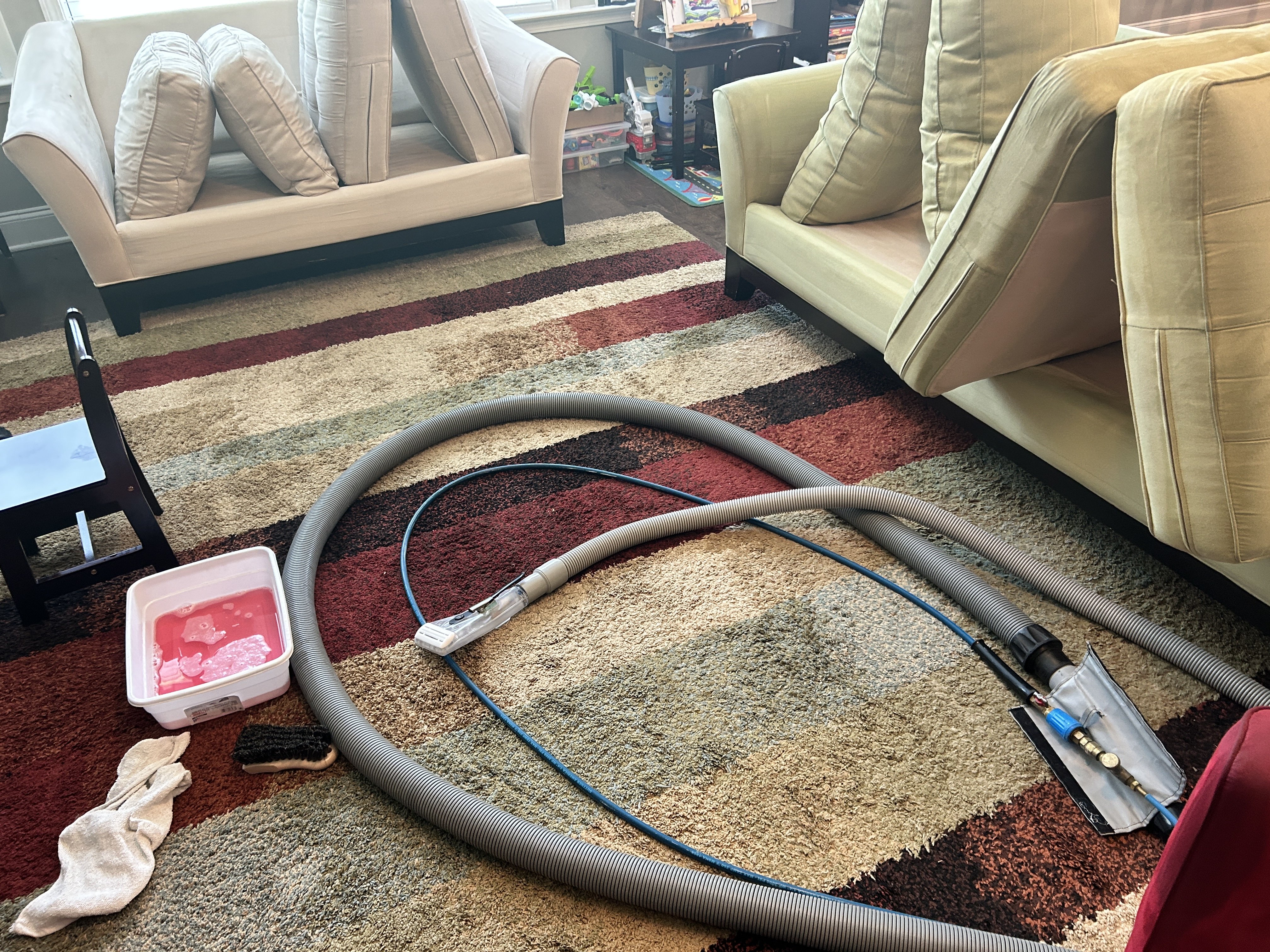

I'll never understand the logic behind spending more time buffing and sucking the chairs vs just going over it with a quick spray and upholstery HWE tool. It can't be any faster
I was just being silly. But…
Theater seats/ Church pews / Office chairs/ Hotel Furniture I would definitely encap. No extraction. Just scrub and go. All other upholstery I would HWE unless I thought there was going to be a secondary issue after dying. Such as white chairs I did the other day. Which by the way I got a nasty chemical burn from even though I was wearing gloves. The customer gave me a $50 tip on top of a $300 invoice. I’m not bragging about the money. Just making the point that customers was pleased with the results.
Am I a VLM preacher. No. It does have its place though.
