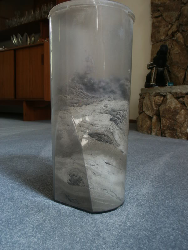

I tell my clients not to vacuum before I get there, that its part of my service. And I tell them on the phone that if they do vacuum, that I'll be going over it again. I've been in too many homes where I extracted a ton of soil after the client vacuumed. They can't believe it. I don't comment on their vacuuming skills. I tell them there is no way to know it was still in the carpet because most use a bag vac. Useless pos's.

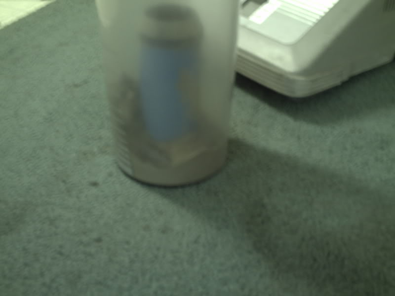

already prevac'd, one room and hall
12sf of hallway, already prevacd

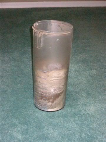

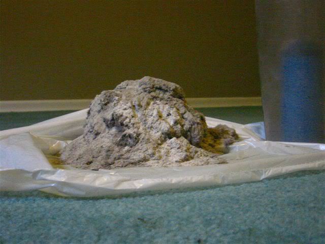

one of 2 cannisters from a average LR, homeowner vacuumed it as well. The white stuff is carpet deodourizer powder. You won't even know its there with a bad vac.
how many would you like me to post?
49,727
If you're not servicing their vacuum and giving them professional coaching on their vacuuming skills, then you are leaving the job half done.
