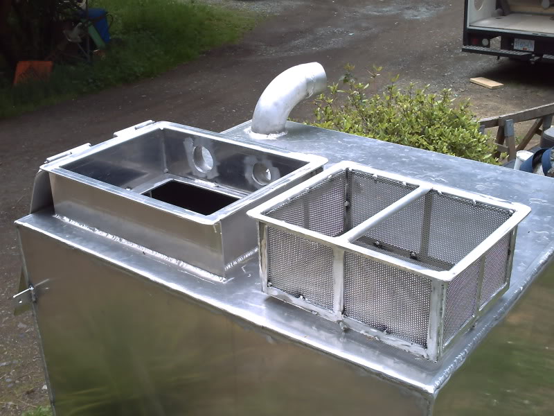

Duane Oxley
Moon Unit
Oct 18, 2006
2,379
Smyrna, GA.
Duane Oxley
hogjowl said:
Duane Oxley at Acellerated Cleaning Systems makes a stainless steel filter that mounts in your van that can go days without being emptied and you never lose vacuum. It's priced around $550. Is your filter less than that?
Thanks, Mardy. I call it the "UltraFlow".
We make it to order, so it takes about a week after the order is placed, before we can ship.
The reason it's made to order is that it's available in so many configurations, that it's difficult to stock them all:
3" to the machine (for 47 blowers, etc.) and 2.5" inlet
3" and (2) 2" inlets
3" to the machine and a 2.5" and a 2" inlet
2.5" to the machine and 2.5" inlet
2.5" to the machine and (2) 2" inlets.
2" to the machine, etc...
