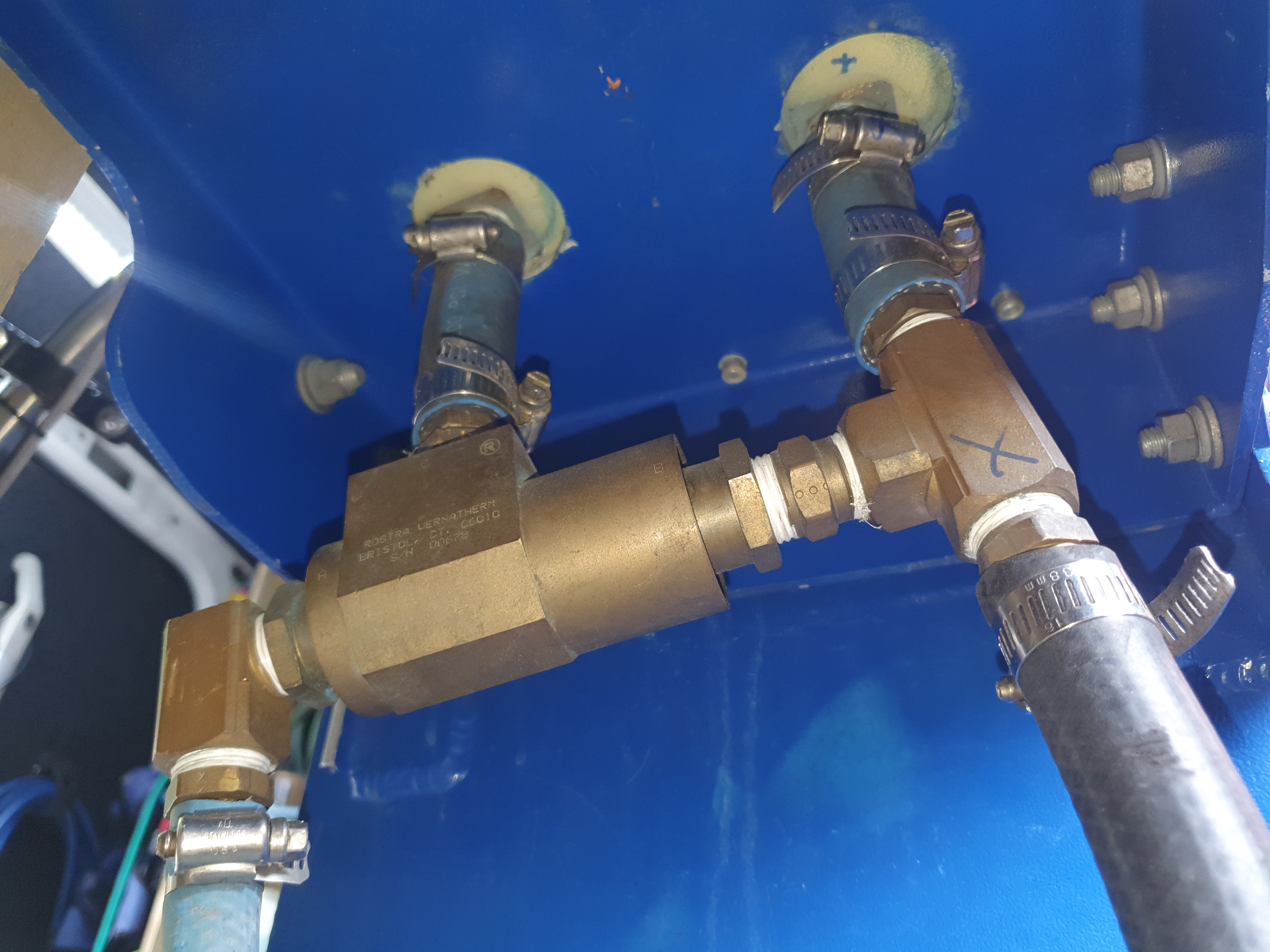

I have a blueline bluewave. I have not noticed the water in the waterbox getting warm. Should this be the case?
There is a 180° thermal rosta valve under the waterbox. Photos attached, what is the Function of this water valve?

Its to send the water to the water box only if the temps reaching 180 degrees to protect the pump. So basically it mixes the water to cool down the water running to the pump from what I understand. You actually dont need it but the water to your wand will take more time to warm up without it. I could be wrong

OP is ask why the water in the water box doesnt get hot. Its bc theres a 165 thermal valve on the water box that dumps the water out the box when temps reach that. That weird thermo valve is just to keep the warm water circulating in the heat system so the water box isnt acting as a preheated like most tm's which in turn keeps you from waiting 15 mins for the water to heat at the wand. That's the only thing I can figure out from messing with mine. Used it without it but takes a while to heat the system

that is actually a bypass valve..not a therm valve.....if will bypass the water box and recirculate the hot water to protect the pump...the therm valve is the little 165 degree valve that is on the bottom of the water box and it is designed to open up at 165 and dump the water into the waste tank to allow cooler water to enter the box and maintain a certain temp...I know some say that they are not important and can be bypassed..but they are there to help protect the pump and the machine.....
That's a better explanation of it for sure and in fact I remember now, that's where I learned it form originally lol
