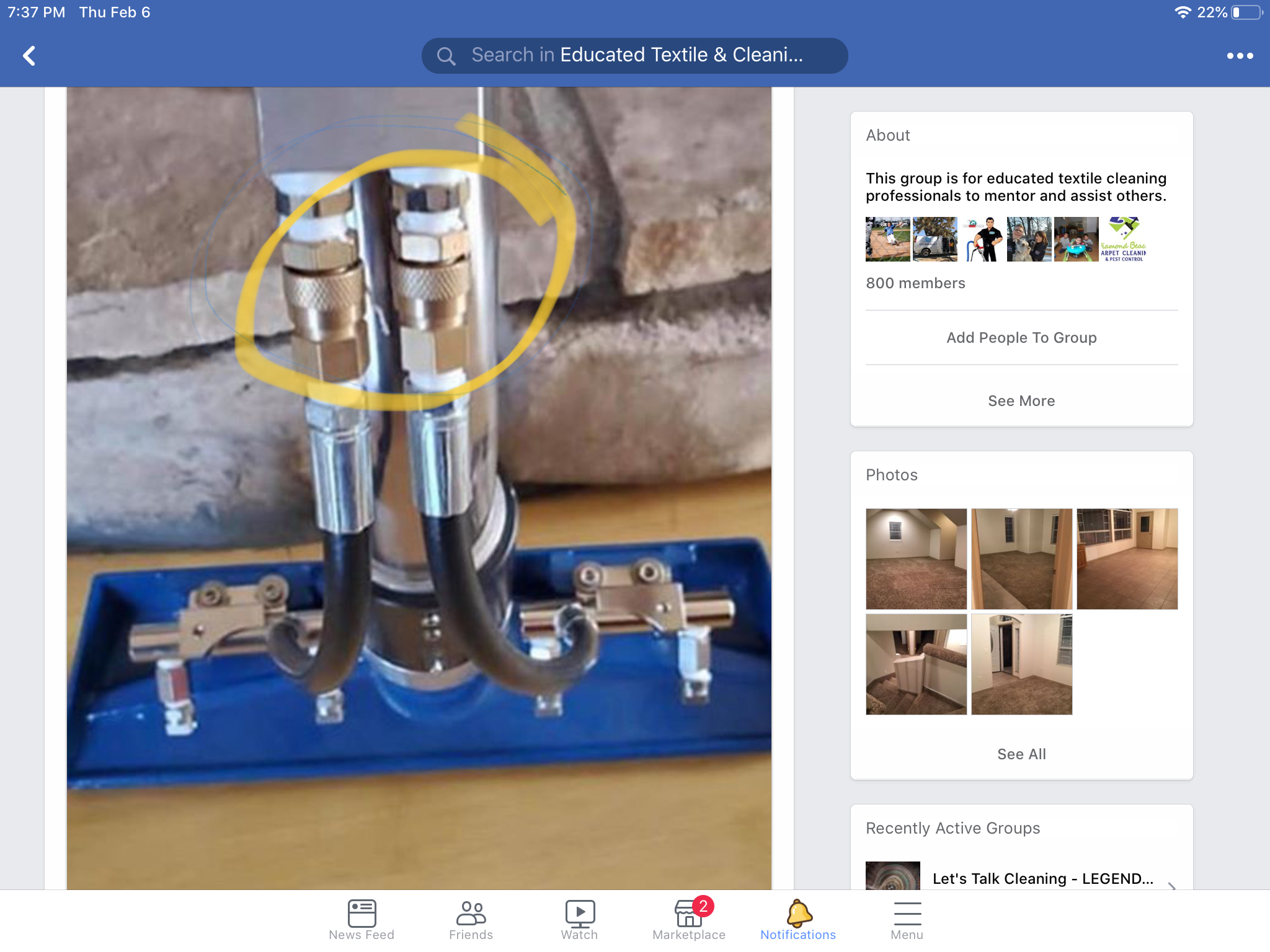

Feb 6, 2020 #1 SamIam Member Cleaning Professional Joined Aug 9, 2012 Messages 11,570 Name sam miller My dev 14 has a bad leak in the brass water area quick connects need to order more quick connects messaged Tom just wondering if these are available anywhere??????
Feb 6, 2020 #2 SamIam Member Cleaning Professional Joined Aug 9, 2012 Messages 11,570 Name sam miller Thats a dang wand not a tom wand and its not the wand with the leak used for illustration purposes only.
Feb 6, 2020 #3 Cleanworks Moderator Cleaning Professional Joined Oct 22, 2012 Messages 28,283 Name Ron Marriott Try pressure washing outlets. Looks like an open flow QC. Maybe even home Depot. Reactions: SamIam

Feb 7, 2020 #6 Lee Stockwell FOJL Cleaning Professional Joined Oct 7, 2006 Messages 18,851 Name Lee Stockwell Needs o rings Reactions: Hack Attack
Feb 7, 2020 #7 K KevinD Member Cleaning Professional Joined Nov 23, 2006 Messages 2,551 Name Kevin Dumas And some high temp o ring lube Reactions: Hack Attack and Lee Stockwell

Feb 7, 2020 #9 Lyman Supportive Member Cleaning Professional Joined May 19, 2007 Messages 1,765 Name Lyman They are on the web site, $42 for two pairs. Reactions: SamIam
Feb 8, 2020 #10 SamIam Member Cleaning Professional Joined Aug 9, 2012 Messages 11,570 Name sam miller Lyman said: They are on the web site, $42 for two pairs. Click to expand... Thanks I found it needed a new slot glide too. Is there something in should do to make these brass disconnect last longer? Wd40? Last edited: Feb 8, 2020
Feb 8, 2020 #11 Lee Stockwell FOJL Cleaning Professional Joined Oct 7, 2006 Messages 18,851 Name Lee Stockwell Parker makes a lube for o rings. A high temperature lithium grease will work too. Reactions: Hack Attack and Small town janitorial

Feb 8, 2020 #13 Rob Grady Member Cleaning Professional Joined Jan 31, 2016 Messages 637 Name Rob Grady Superlube. Either in a spray can or grease in a tube. Part of regular maintenance. Reactions: SamIam
Feb 8, 2020 #14 BradFenstermaker Member Cleaning Professional Joined Oct 9, 2006 Messages 1,846 Name BradFenstermaker Northern Tool has open flow QD. Stainless too Reactions: SamIam
Feb 8, 2020 #15 Lee Stockwell FOJL Cleaning Professional Joined Oct 7, 2006 Messages 18,851 Name Lee Stockwell Because the couplers are NOT repeatedly uncoupled there is likely very little metal to metal wear. It's all o rings. Reactions: SamIam

Feb 8, 2020 #16 SamIam Member Cleaning Professional Joined Aug 9, 2012 Messages 11,570 Name sam miller I ordered new ones from the website I also needed a new slot glide for my 14 inch dev
Feb 9, 2020 #17 K KevinD Member Cleaning Professional Joined Nov 23, 2006 Messages 2,551 Name Kevin Dumas 3 oz. O-Ring Silicone Grease Tube Reactions: Lee Stockwell
Feb 9, 2020 #18 S scotty747 Member Cleaning Professional Joined Oct 19, 2006 Messages 923 Wd-40 will swell the O-rings. I use wd-40 ptfe dry lube or any silicon lube. Reactions: SamIam
