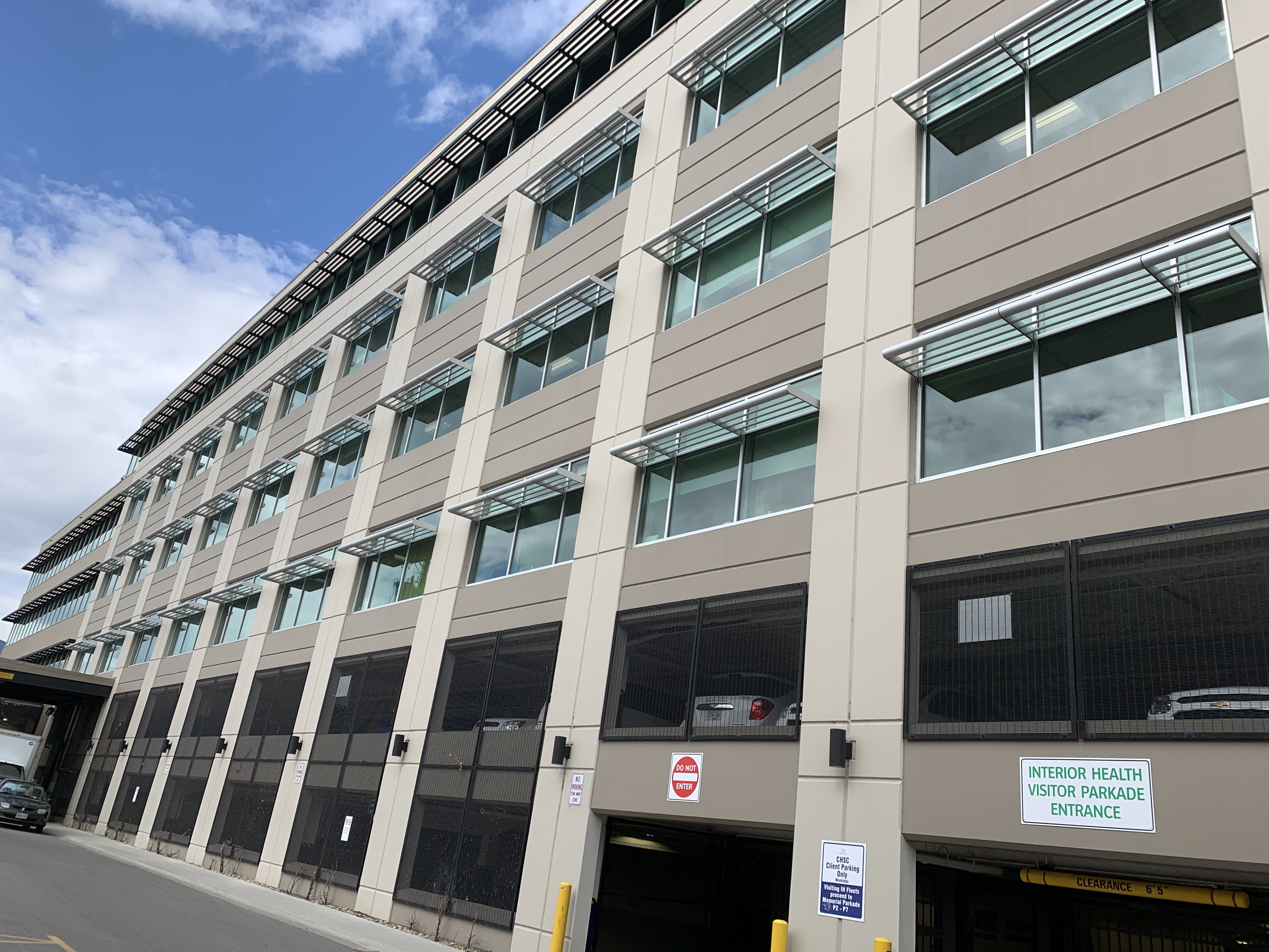

Well, the area’s in question are a little bigger than I was told. The sewer pipe burst on level 2. The resto company is tearing out any carpet on L2, and L1....
BUT, they want level 3, 4 and 5 cleaned, as they are worried about cross contamination. The total sqft comes out to 96,700 sqft....
I’m going home now to put together the estimate.
I’ve always charged this resto company .25 C a sqft....
Looks like I might be working over the long weekend.....
6,564
Starting @ 7:30 Friday morning. HWE. 450 ft hose run.
Jebus....
6,564
Jebus....
This contract is for Interior Health. They’ve requested all MSDS, and I’m using procyon, with an powdered oxygen booster.
I’m using Deep Blue as a rinse.
I figure 12 hrs. a day, 4 days.
I have 175 gallons on board of RO water, and I’ll bring an additional 65 gallons.
I have a parkade level dump.
250’ of 2.5, 200’ of 2”.
I’ve got 300 ft of thermal plastic solution line, and 150’ of Goodyear Neptune off the truck..
They bit @ .20 a sqft...
