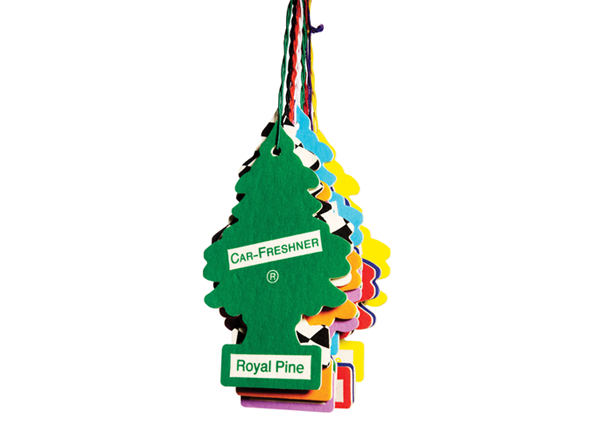

you're all pi55ing in the wind
you'll do just as well to stuff a bunch of these in the cold air returns
91922
fo-reel
and turn the HVAC blower switch from auto to on
(on the wall thermostat)
