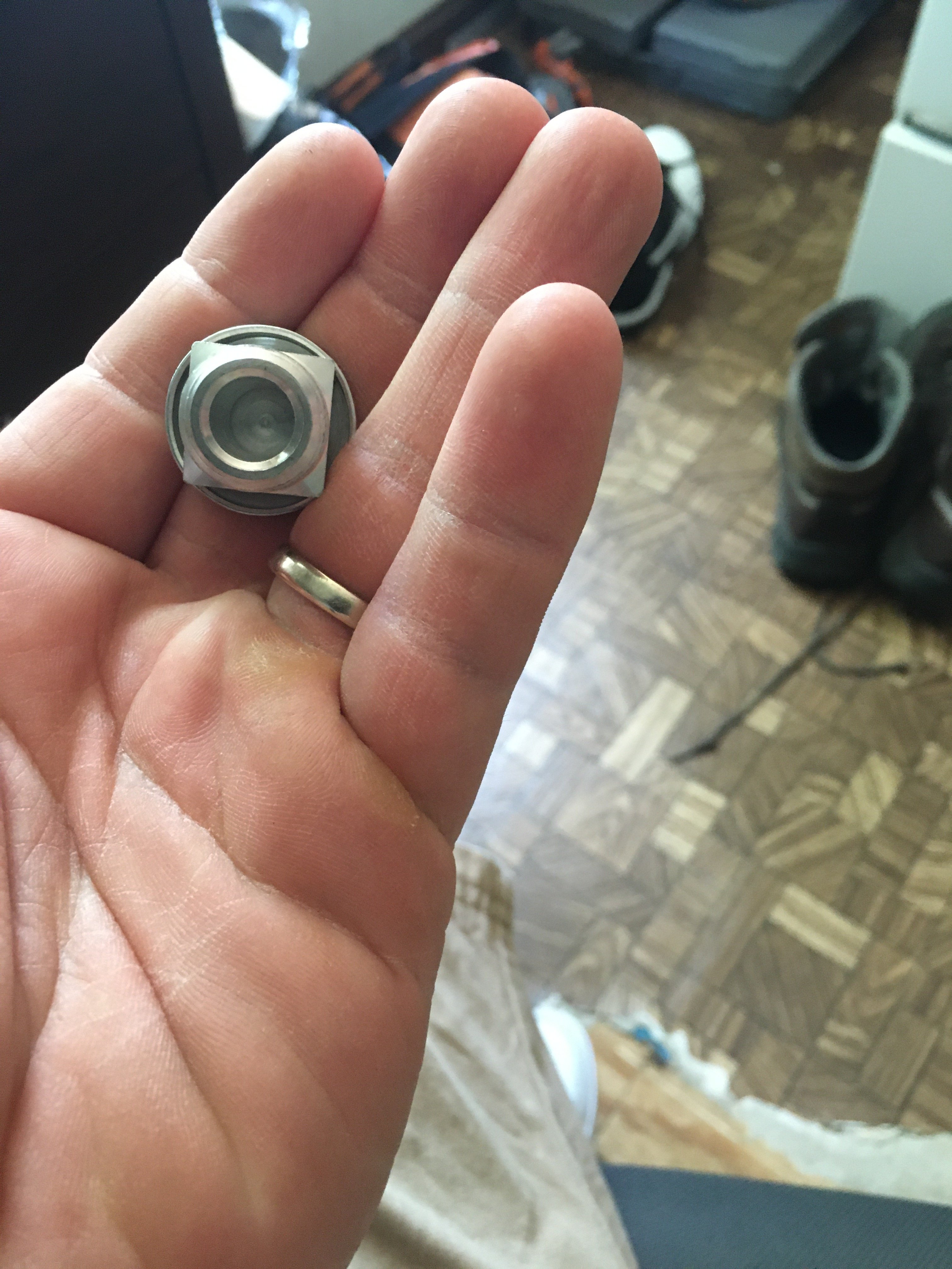

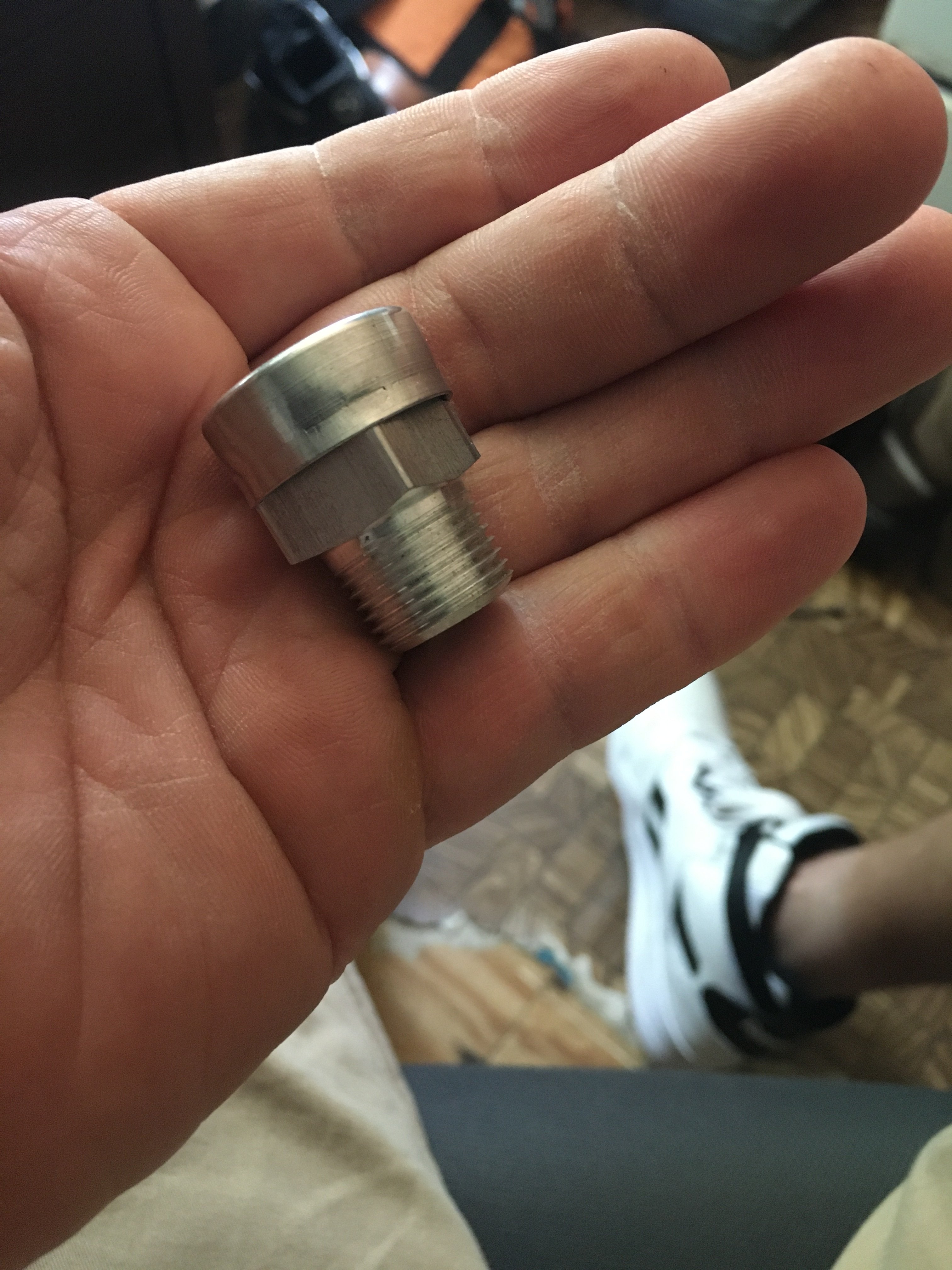

I got in touch with CleanSource in Columbia and they’ve been replacing that overpriced part with a grainger breather cap they’ve been using for over 6 years with no problems. I ordered 2 of them and I’ll show the part number and pic as soon as it gets here.

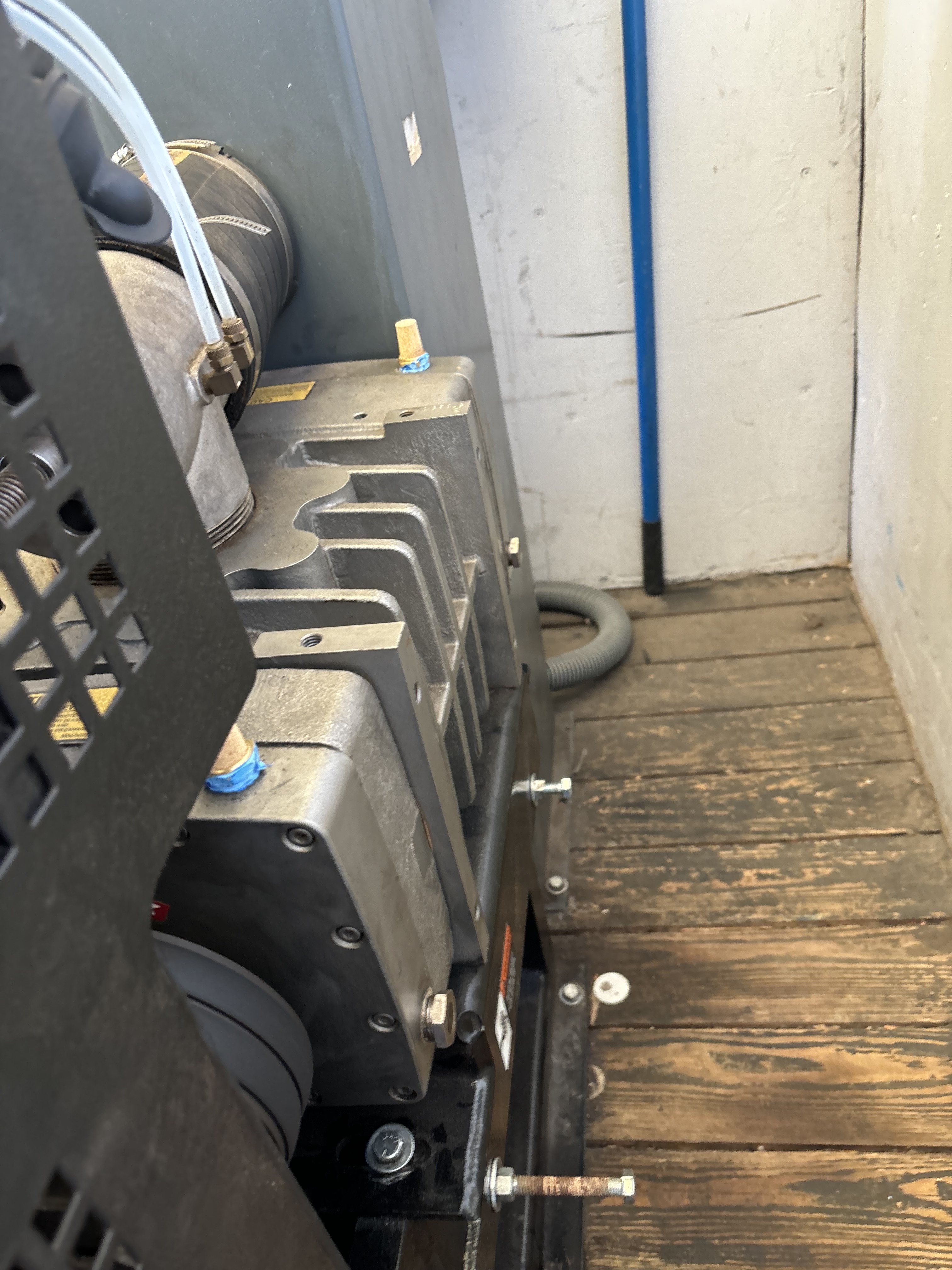

Can some of you geniuses explain why the Judson C-4 doesn't even have breathers on it's GD TI408 blower?
I'm not gonna buy a Judson, I just want to know what helps that setup stay cooler to not need one. Pull up the video on it and you'll clearly see it just has the hex plug

The vent is just another safeguard. Likely put there because of the expectation of increased heat in the compact design or possibly in response to issues (in this machine or ones prior). It isn't like GD doesn't have breather vents for blowers but most blowers are used in industrial applications in relatively open areas without other heat generating components (or at least considerably less heat).
Judsons are an open design with a completely separate heating system.

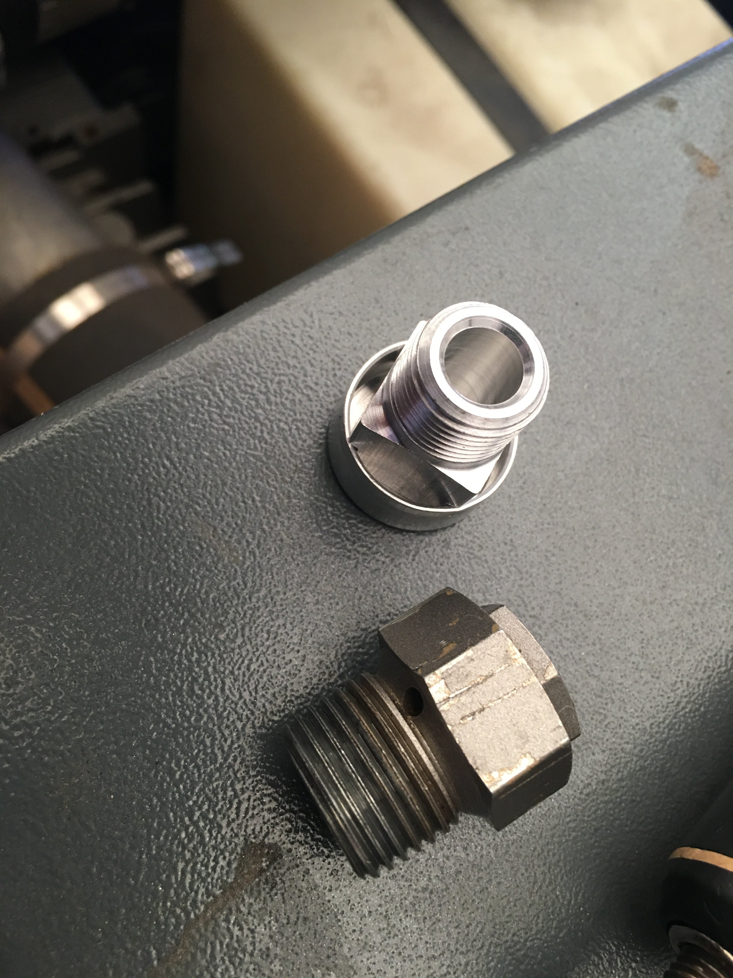

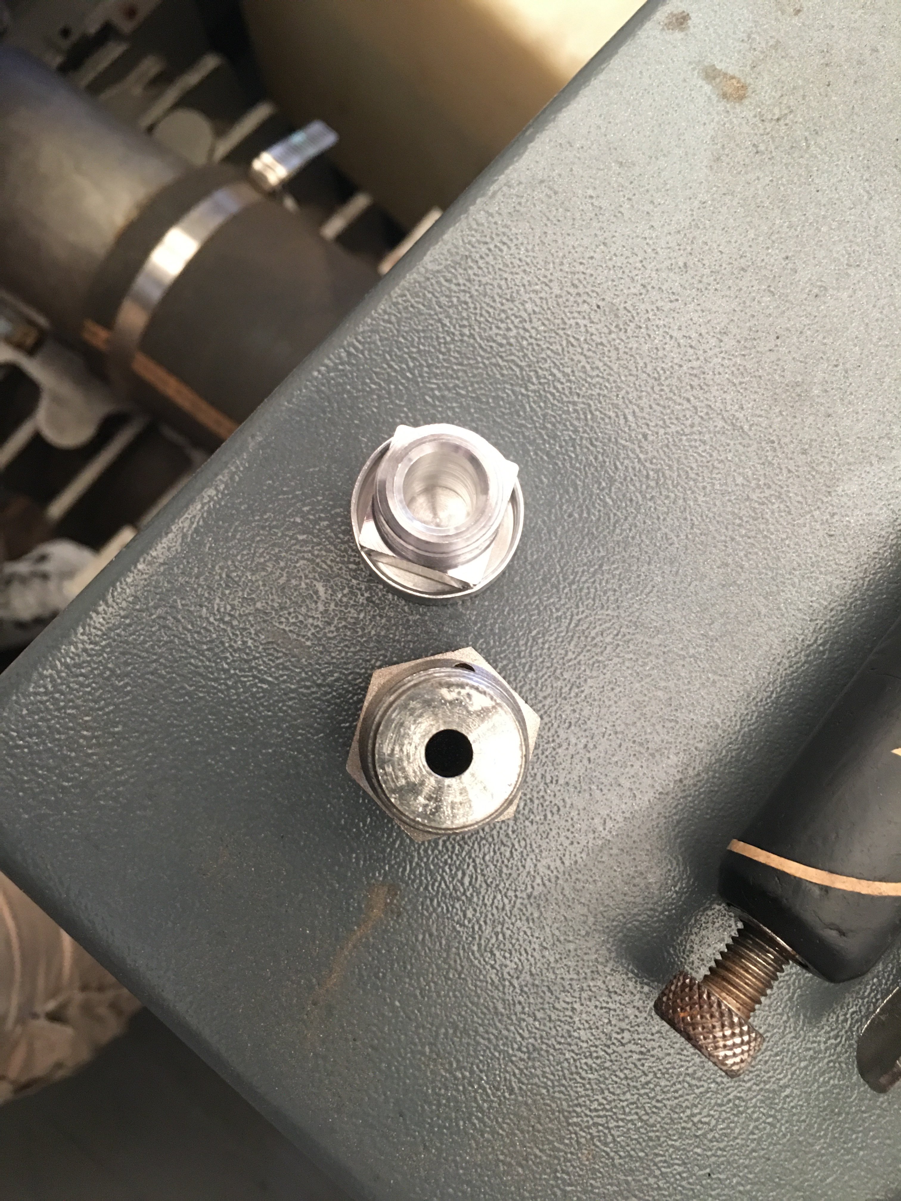

This is what CleanSource in Columbia has been putting on the blowers for 6 years. He told me he’s seen no problems.
A pinhole breathing tube on the one with the stone or a 1/4” breathing hole on this one helping the heat escape makes more sense.

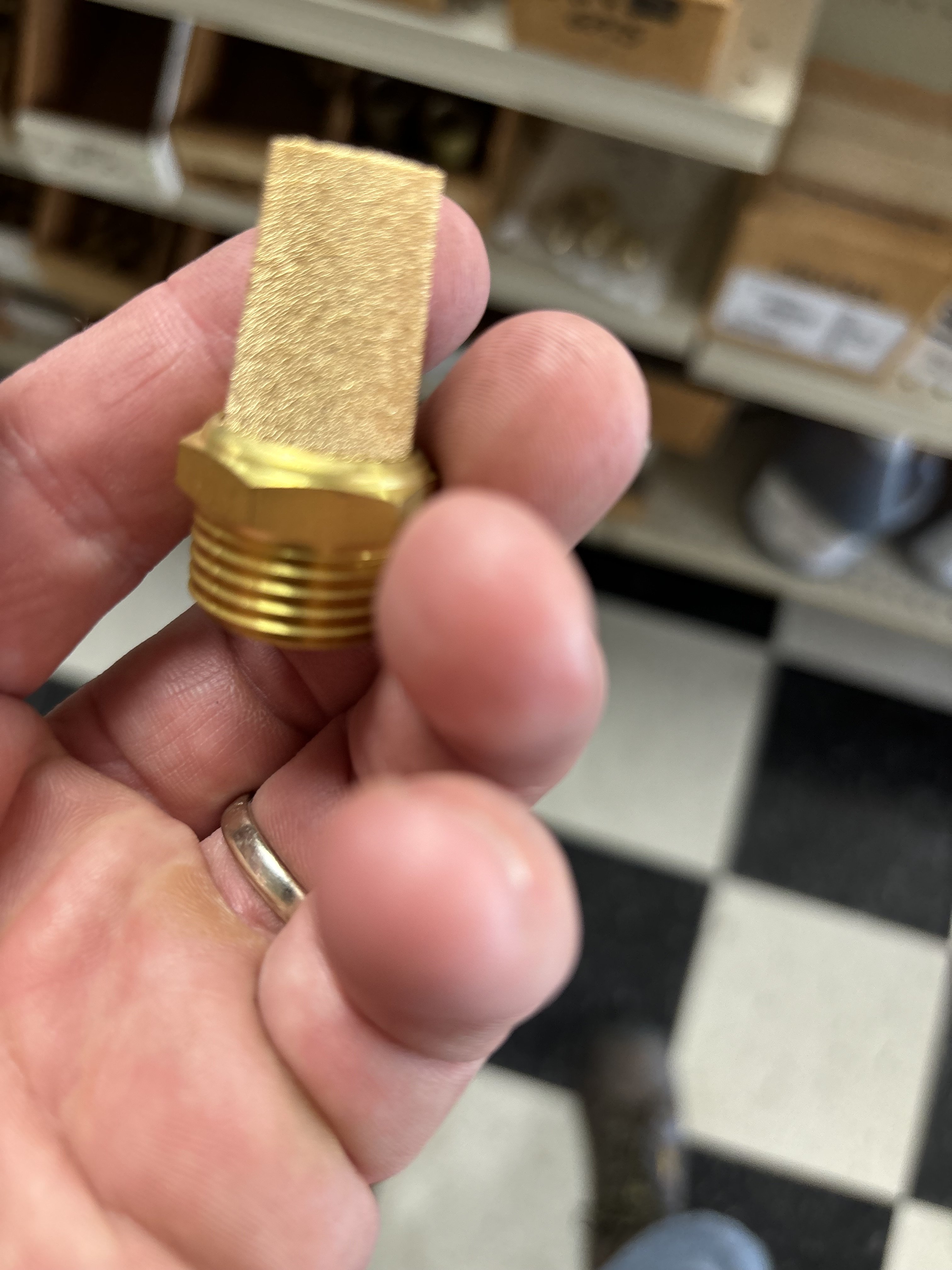

I found these brass mufflers on the shelf of my industrial supply store today when I was buying some new belts today. I figured I'd get a couple and see how well it works. I made a couple calls from the 2 guys I trust for these kind of technical questions and they both said yes.
It went through 5jobs today (9hrs) and it seems to work great
The hole to breathe is 10time bigger diameter than the tiny hole in the stock cap
And I don’t see any way for this brass filter to get wet with oil like the little filter does so it shouldn’t build up pressure in the blower since it’ll breathe better
9hrs and the filter stayed dry. I’ll update more about a month from now
