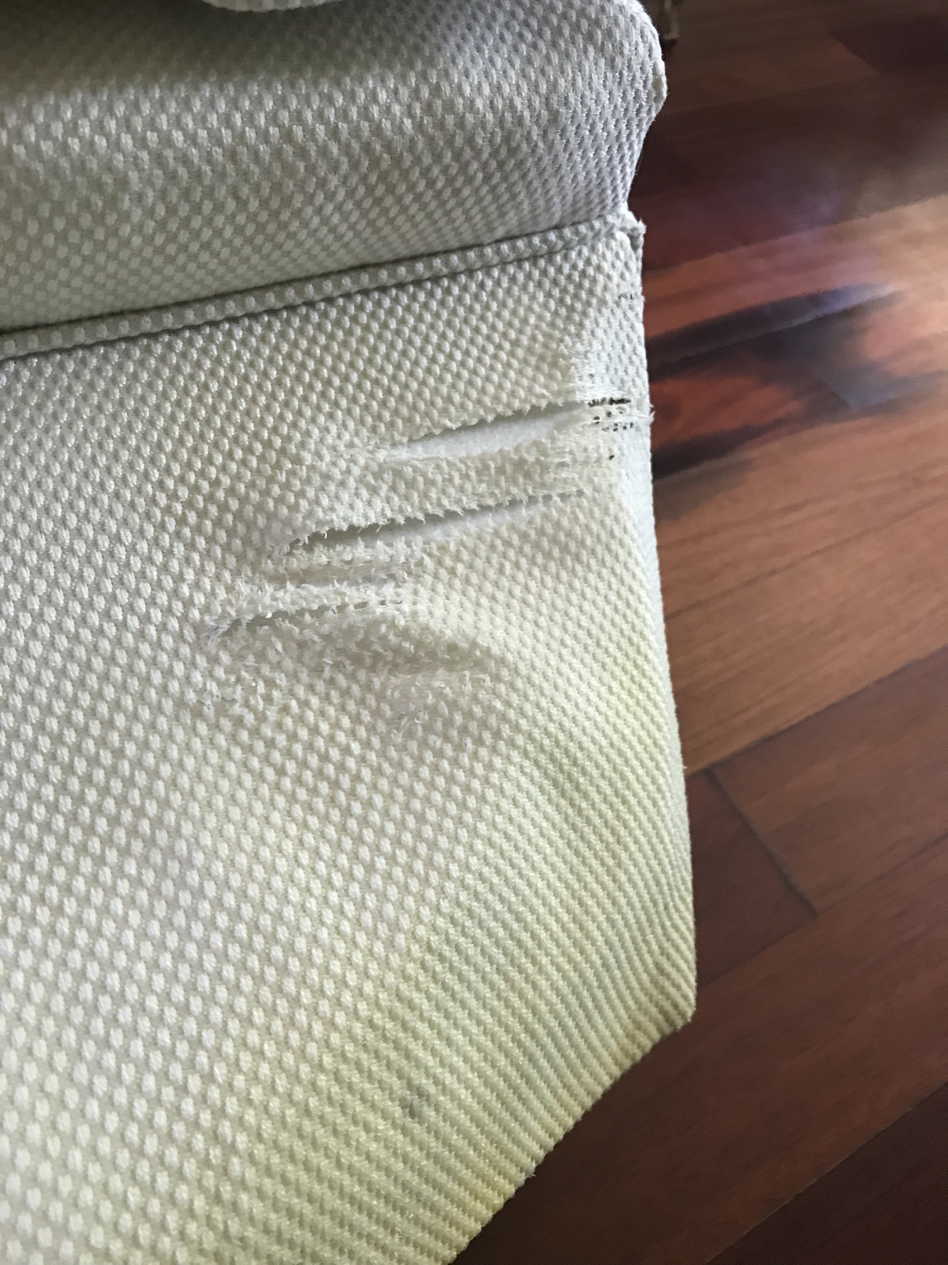

New customer, 9000 F2 home. So if little precious pisses on Mrs. Finkelbeans sofa skirt, is there a chance that the urine contamination will weaken the fibers? Looking for a scientific answer so I can speak intelligently. (insert smart ass remark here)
My guy was cleaning this sofa today. Mrs. Finkelbeans wanted only the pissed on skirt cleaned. Went all around the sofa and it tore on this last area. We use Sapphire Scientific upholstery tools.
Note the piss damage on the hardwood. This is a close up of the skirt.

from pic looks like its torn higher than the urine staining, but there is colour change so possibly uv damage?

The fabric doesn't look urine damaged where its been split.
If she has used peroxide or oxiclean on it in the past in that area, both will weaken cellulose fibers over time if its been repeatedly applied.
If the fabric was made of viscose or rayon, both of those fibers become weaker when wet, and you can get that kind of damage if the vacuum on your tool was on the strong side.
I've done both: Weakened fabrics with too much oxidizer, and split them with too much vacuum when weakened by water.
I've seen urine damage jute backed carpet and rugs, but not in the way that damage appears.
Thank you Jim, I did not think of that. Now to get her to admitting that she treated it...

Jim was up early (or maybe it was the Eastern time zone) and covered most of the key points. I will add that the fiber matters. Urine is more likely to damage natural fibers, especially as ammonia is formed raising the pH.
