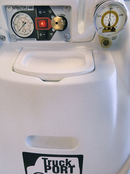

The Truckport has 2 Airwatt vac motors producing 200 inches of water-lift. (See image below.)

Here's a picture of the Truckport with a vacuum tester - pegged at 200 inches of lift. For a Porty, it doesn't get much better than that.

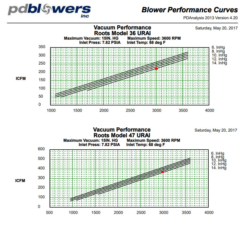

Here are the performance graphs of a 36 and 47 standard sutorbilt urai blower. Chosen because they share the same max rpm. Both are easily capable of 14"hg/190in of water. The difference is how much air is being moved at that lift level throughout the curve.
At the red dot in this image (3000rpm) the 37 is pulling 220cfm at 14". The 47 is pulling 360cfm.

I have measured a 47 at 470cfm
