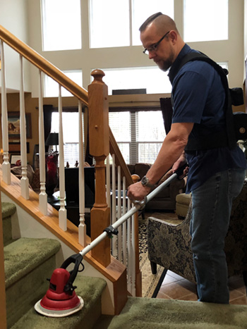

got a motorscrubber on the way should arrive in couple days. I bought it for hard surfaces primarily, will be interesting to see how it goes on carpet

Sorry fellas, but that motor looks like it’s belongs on my wife’s hair dryer...
Honestly, do you guys really think it’s going to hold up to commercial use?

Its a pretty grunty unit (I demo'd it 1st) I think it will do fine for edging hard floors which is what I got it mainly for. Know someone who uses 1 for meth decon and wall/ceiling scrubbing out whole houses
Fair enough.
I can see it for hard surface, but for scrubbing carpet? IDK....

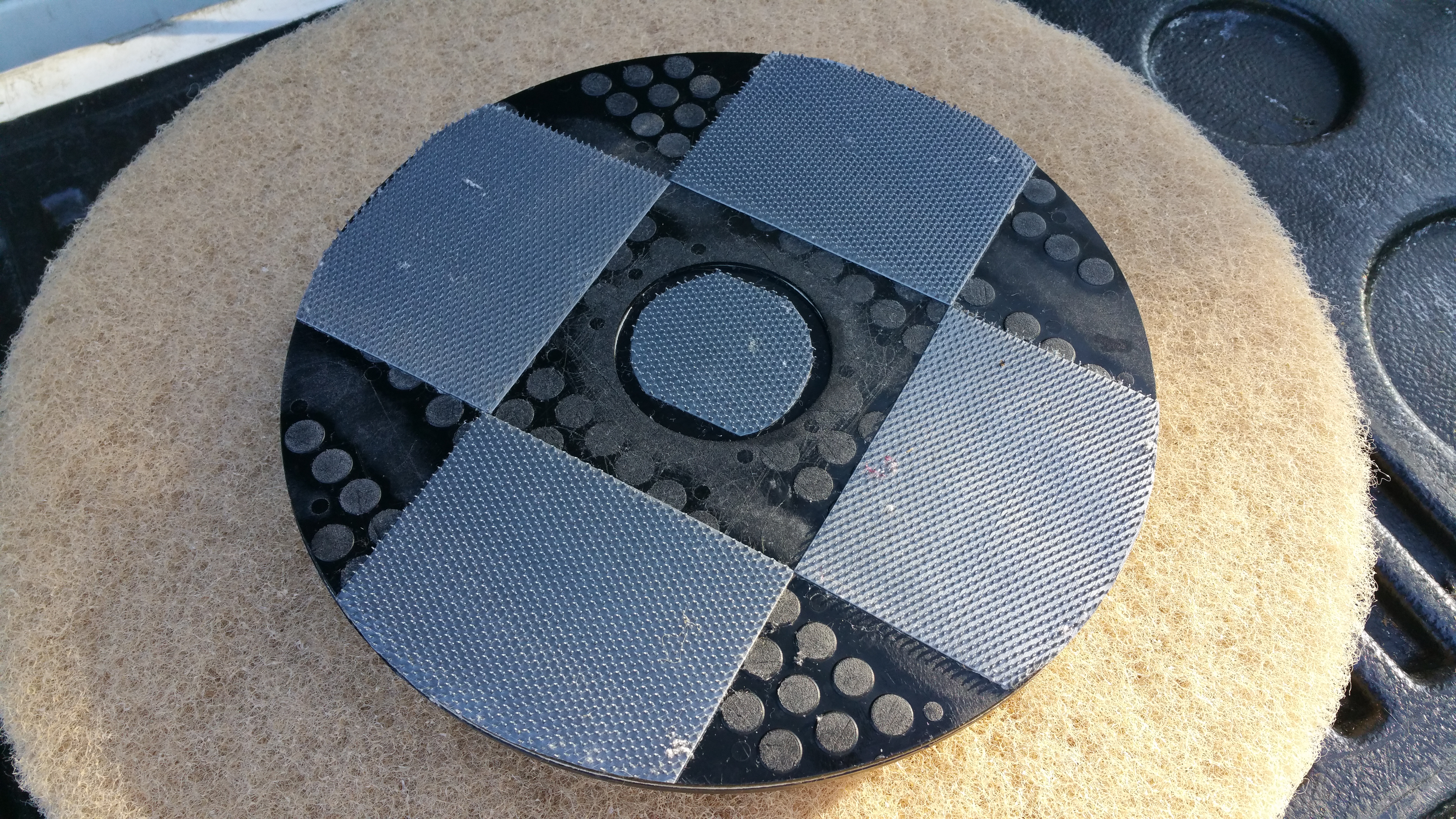

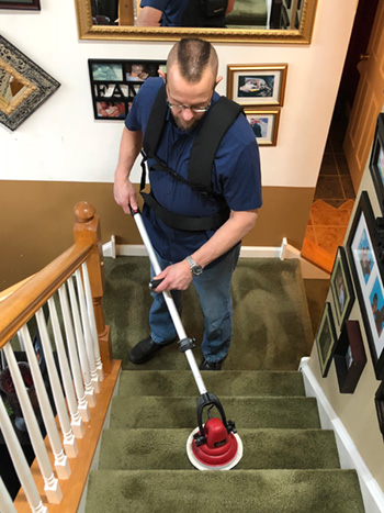

Get the oreck orbiter and if your going to use cotton or micro pads then take the t-hooks off the oreck's pad driver ( they will rip up your pads) and replace with velcro, you can get some at wal-mart in the craft section get the industral.
To clean the stairs with the oreck start at the top, you'll be standing up straight looking down the stairs with the machine in front of you, lower the oreck to the first step clean and let it roll over the nose of the step and clean the nose, step down to the next step and repeat. this way there is no bending over or getting on your knees.
