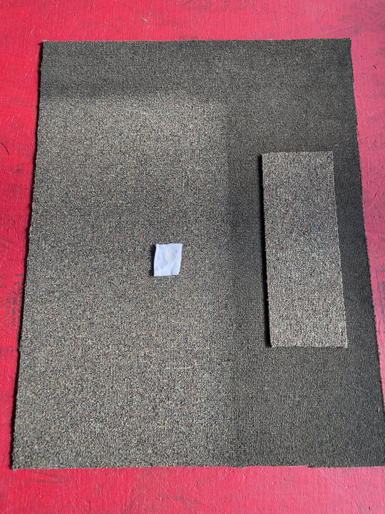

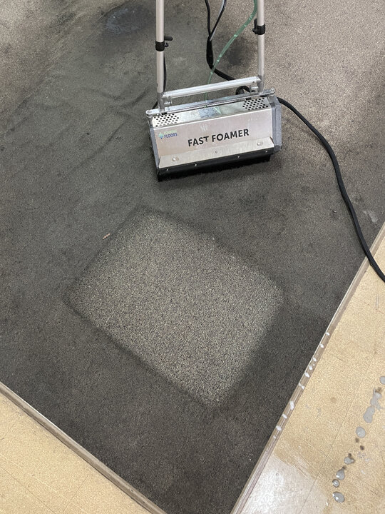

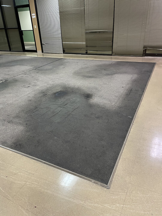

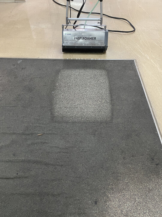

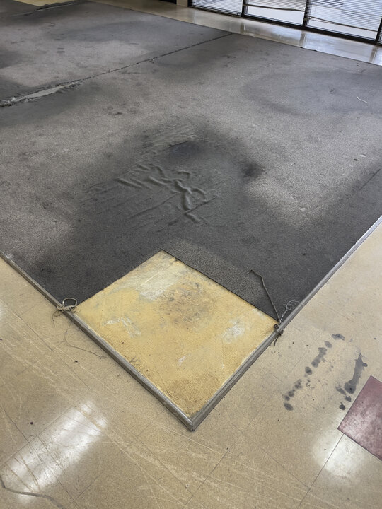

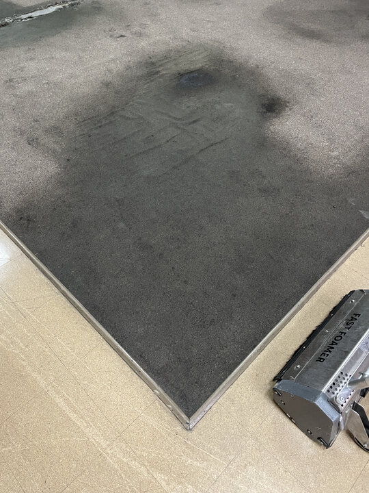

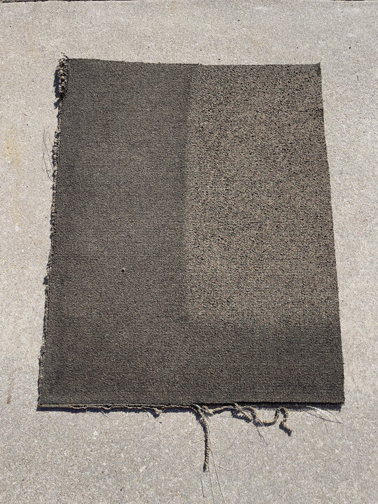

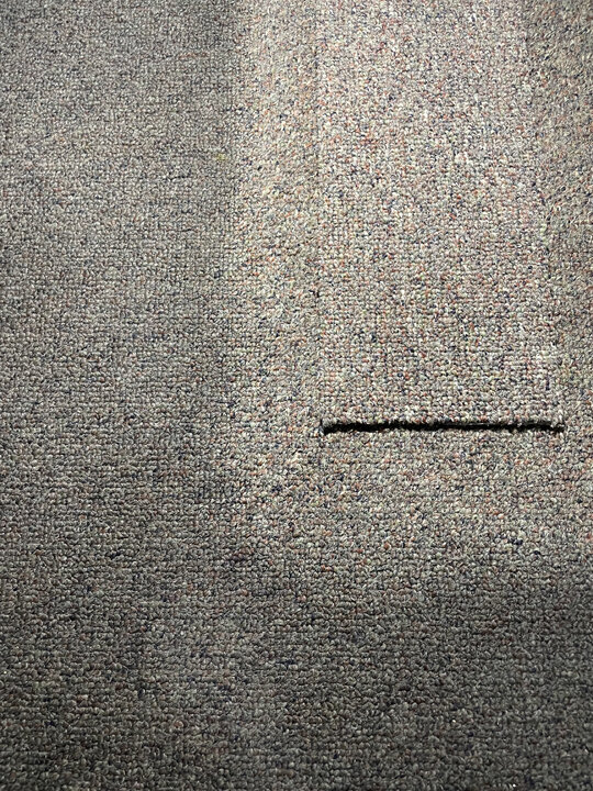

See the attached photos and tell me and everyone how the "Fast foamer would not work in this application".
Mikey P said a lot of you guys are friends and go back and forth and this is just a tight community, so don't be offended. LOL! Sounds like my kind of sandbox!😈
If you want to measure dicks, LOL. One example: We can clean a 5 story bldg over 70K sqft plus upholstery yada yada three Fast Foamers over a weekend (Sat & Sun) with time to spare. This system truly cleans. Rotary is dead kid and I'll keep kicking it. They knew rotary was bad in the 80's. Let that sink in. Why do they want you using it? Start asking questions. Wakey, Wakey sleepy head. Rotary is NOT an ENTRAINMENT SYSTEM! "They" have either intentionally suppressed the CRB technology "mechanical entrainment" or just didn't recognize it, either way. There is no going back to sleep! My work is copyrighted and will be out soon! Didn't you know... There is a MANDATE!🤣🤣🤣
I GOT SO MUCH CONTENT! THIS INDUSTRY IS GOING TO SEE A MAJOR SHIFT! RELAX AND BREATH IT IN. WE GOT THIS! Disclaimer: WRE and TM's aren't going anywhere. I've broken it all down, but rotary is the past!
View attachment 130404 View attachment 130405 View attachment 130407 View attachment 130408 View attachment 130409 View attachment 130410 View attachment 130411 View attachment 130412 View attachment 130413
