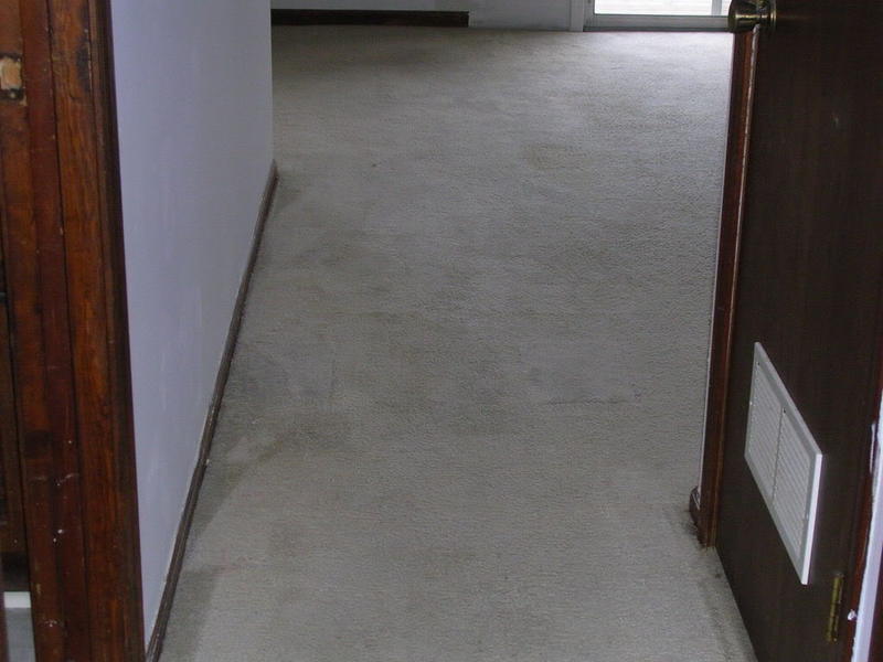

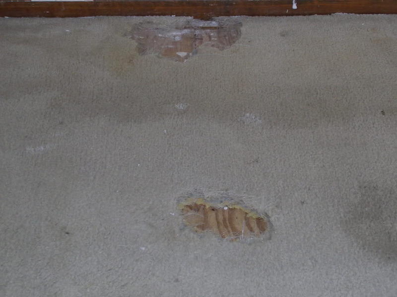

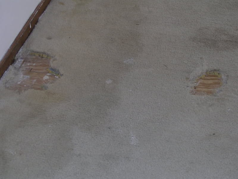

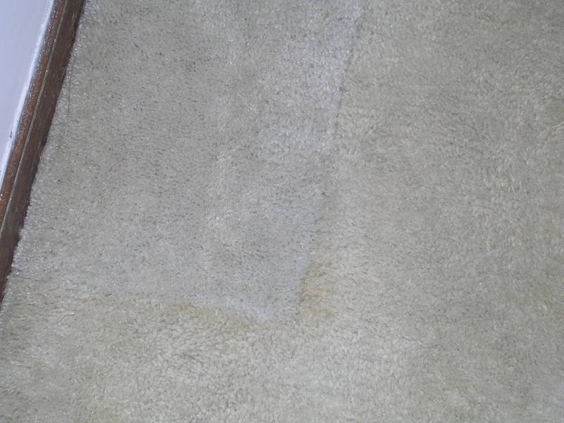

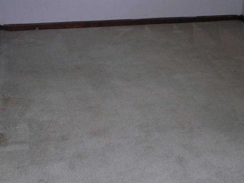

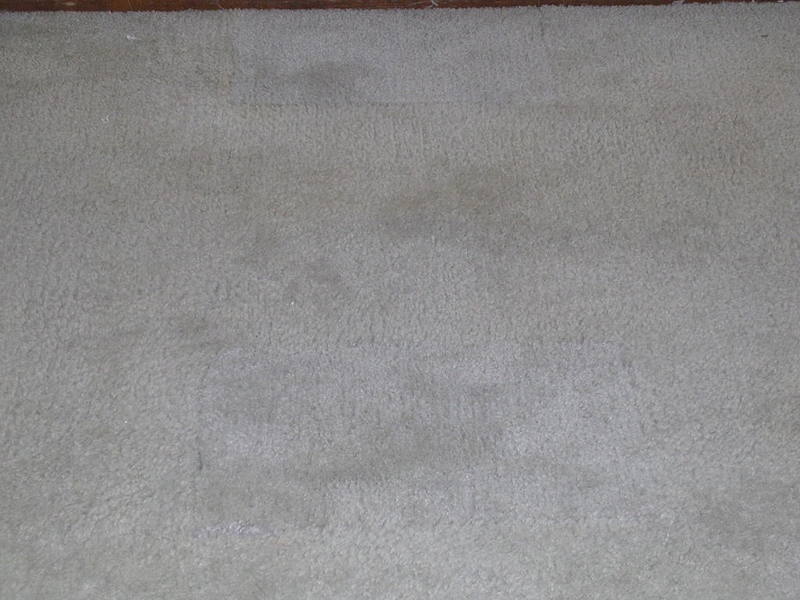

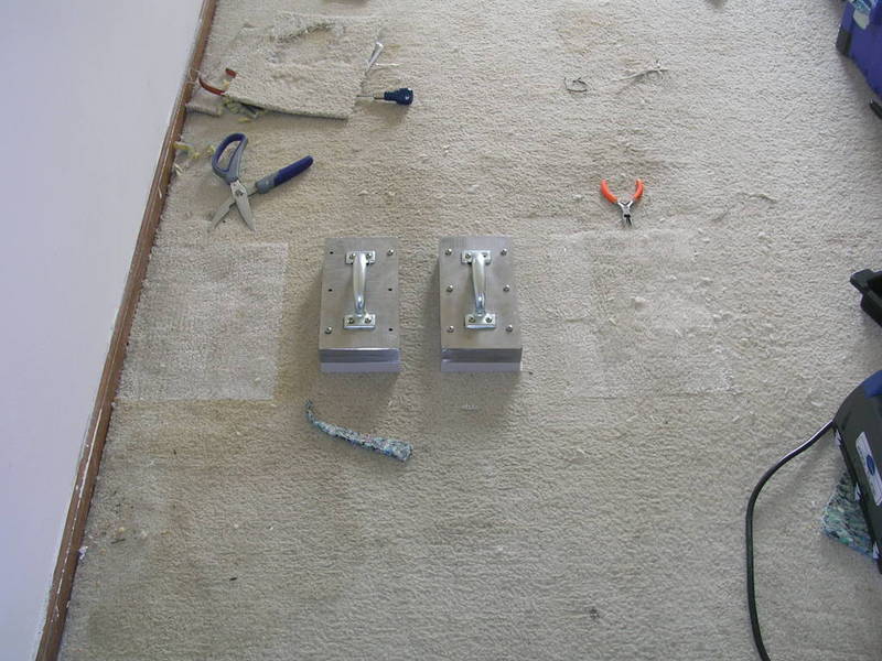

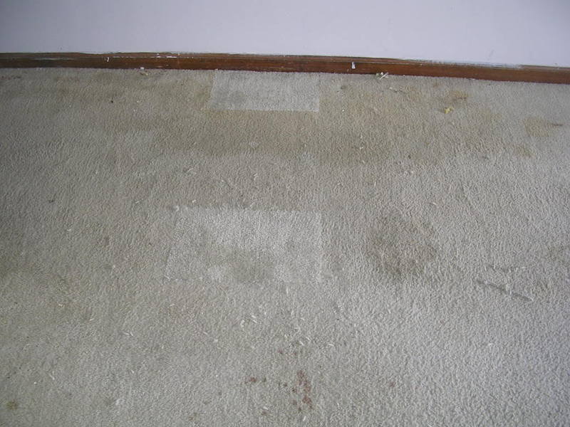

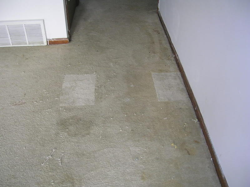

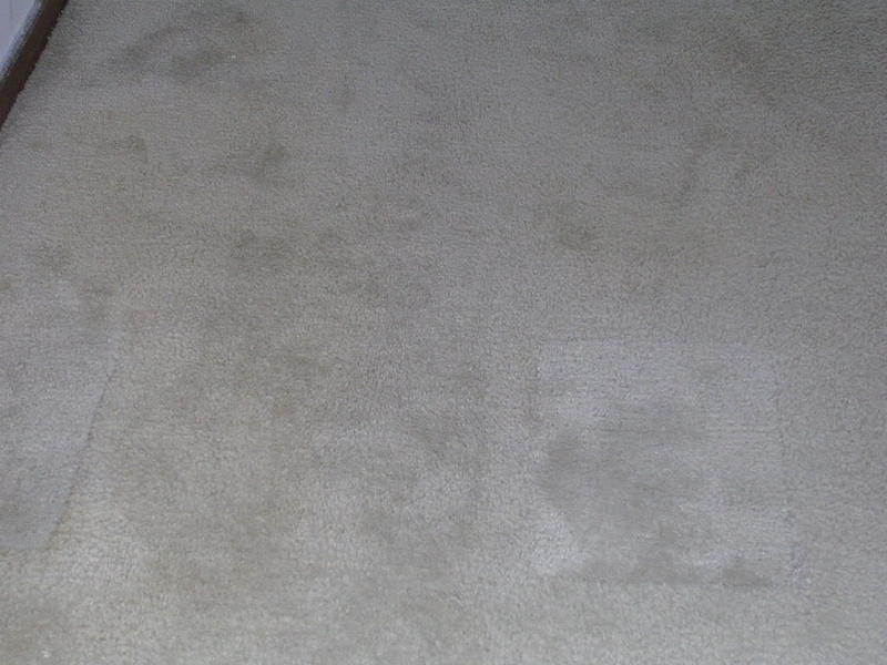

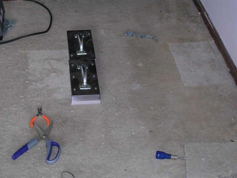

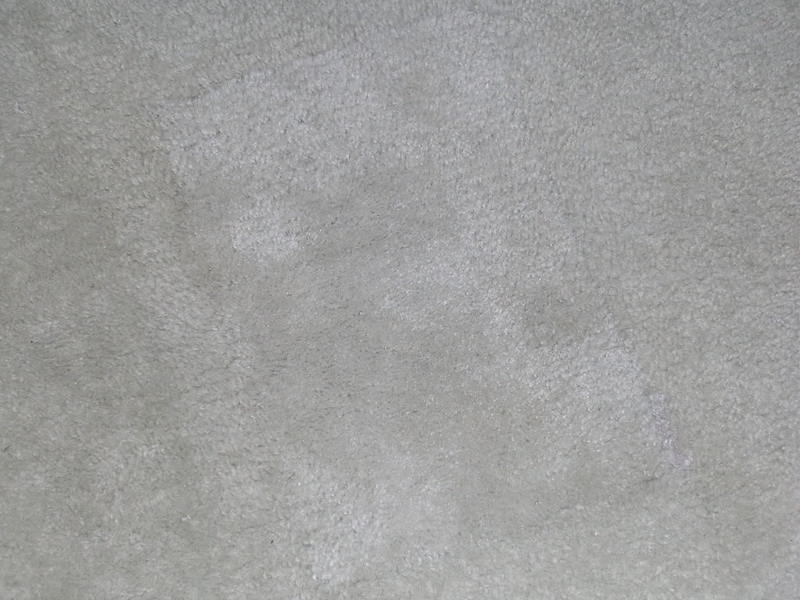

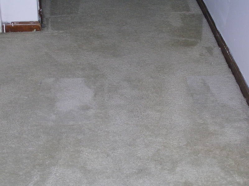

These are photos of some repairs from a trashed apartment about a mile from my home. I bid them cheap as I thought it would be some good practice as I could work unsupervised at my leisure. I had to pull donor pieces out of the closet that were not very worn and the repairs are in the main walkway and very worn. The repairs were laid with the pile direction of the areas with not much wear and I wonder if I should have laid them with the pile direction of the repair area as it seemed to have changed with the heavy wear.

Looks good to me, given what you had to work with. Did you do the paper test for pile direction in the imediate area you were working in?
Did you make your own weights? If so out of what material?

Looks good....Take the clean piece and turn it upside down on the concrete drive way and scuff it up a bit and it will match the traffic area a little better...

Looks Good, you can also adjust the "look" of the new piece with some pumice stone. Also a light brushing with a light yellow crayon will also do wonders.

I think you did a great job! Way to go keep up the good work
117,345
Looks great.
I do like the idea of cutting the edges in irregular shapes to fool the eye though.

Mikey makes a good point. If you can get to the back of the carpet, which this one or most apartments are easy to get to, you can easily cut an irregular shape and make it look very good. The eye tends to be drawn to straight lines more so than irregular line. Plus you can match the edges very well and manipulate the donor piece easier to make it fit almost perfect.
Keep practicing Doug, looks like great workmanship, great example to share with all of us.

Shane, sorry for the delay on my weights. I just kind of copied what SA used in his class. I just bought some mild steel 4 1/2 X 7" or so and drilled and tapped some threads for the bolts to hold the handles. I polished mine up on my belt sander and sprayed some Boeshield T9 protector/lubricant on them to keep them from rusting. I also added some 1" thick plastic on them to keep the lubricant/protector off the carpet and cut some grooves on the bottom with my table saw to release heat. I don't think the plastic is necessary though. I think if you had them powder coated they would work just fine to pull the heat from the repair.

those are some good looking weights. I think you could sell a few of those.
Good job on the repairs.

Nice Job!
You are smart to get some experience with low end rentals before trying a repair for a high end home with the customer watching.
And throw a little dirt on it.Im not kidding
