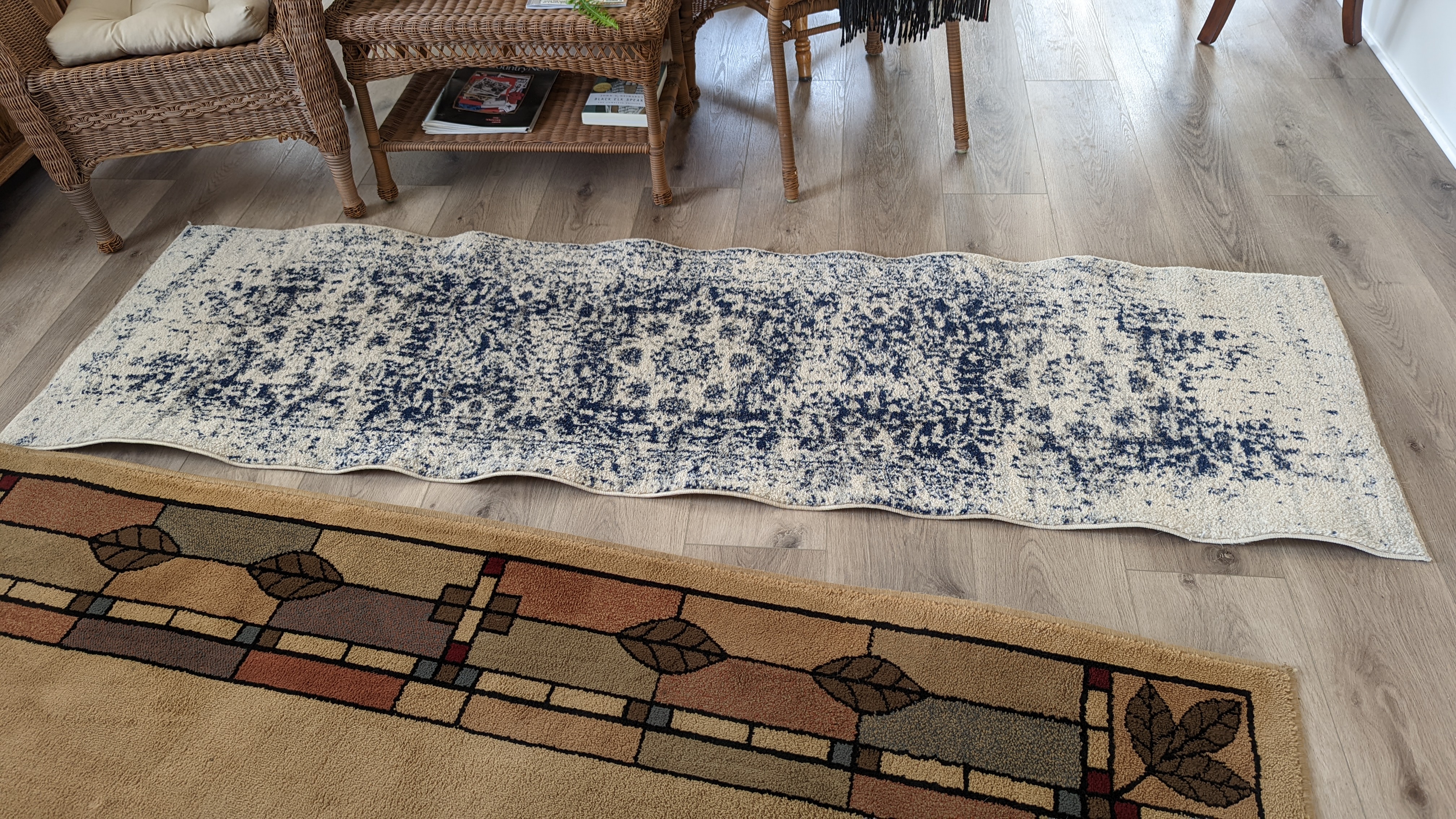

Its not the cleaner’s fault the customer bought cheap ass rugs.
Im not convinced that curling is a sign of cheapness in synthetic rugs.
Do the manufacturers knowingly use moisture sensitive bindings or other materials to save money?
Are non sensitive really more costly?

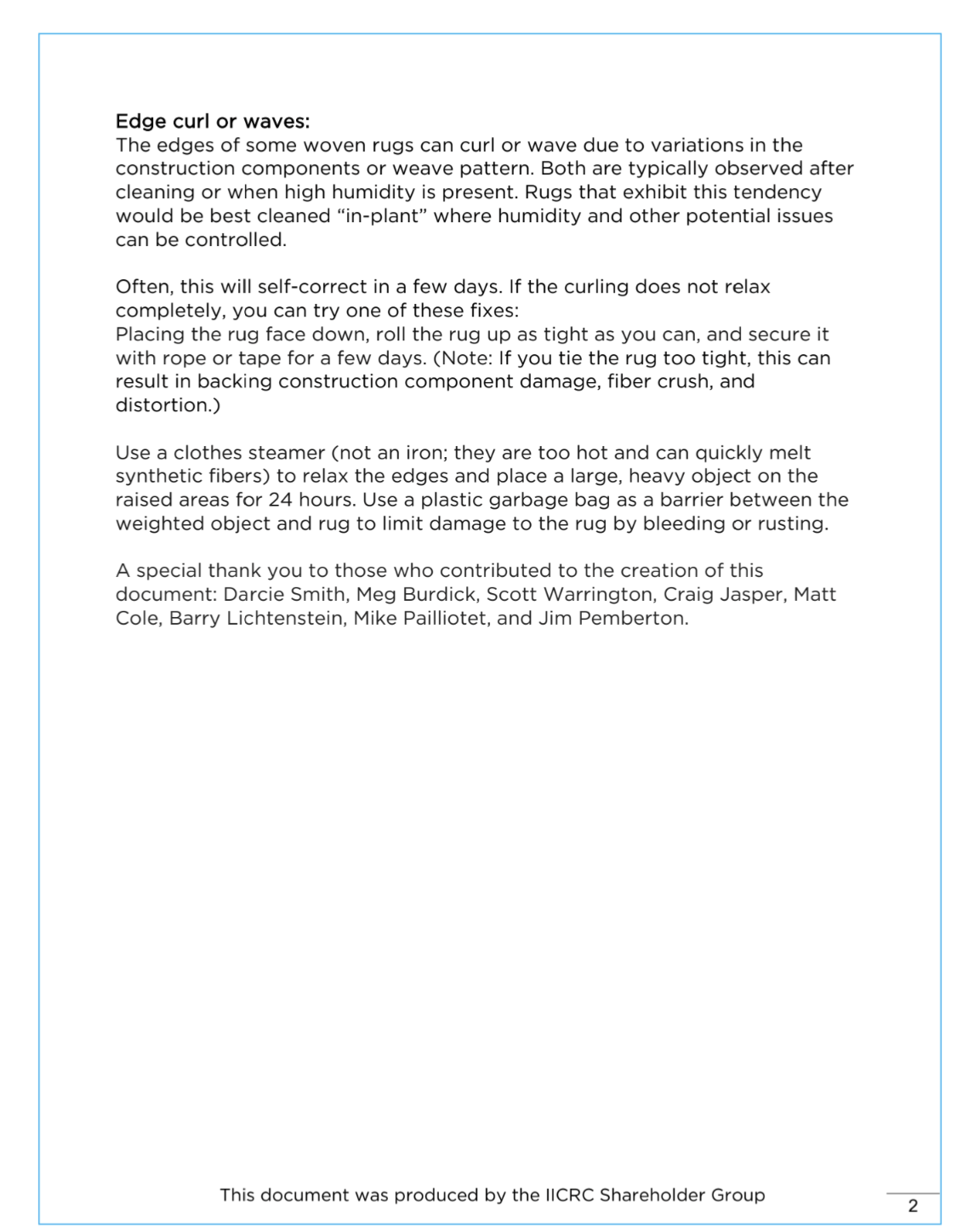

Tell me how you prevent curling?
Or do you just fix it prior to returning?
We may have polypropylene rugs with a cotton foundation curl a little but during our drying process, the weight of the rug hanging over the pole pulls it straight as it dries. I have never had permanent curling on those rugs.

They usually flaten out as they dry. Just let the customer know before you leave that they should level out as they dry.

Cleane 3 rugs with those jute backing, told customer what would happen. They said it was fine. I just spritz with oxy encap and use compound. Turn out great. It had some existing warping, not bad, but I wasnt going to make it worse.

We've done just that on some ultra high end customs where the "curl wait" and return visits to correct were simply unacceptable

Lower heat, less water, and more extraction strokes would reduce the chances of warping.

I let them know the risk never had a call back. Now I did have a large bonded living room rug with heavy furniture that buckled what a nightmare. Nice thing around here is once you screw something up you see the same kind of materials so you know what to stay away from.
See a good stretch prevents it.
A 100 degree day and laying it I the drive way helps too.
