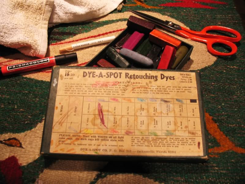

Had an opportunity to use these today. The kit is from the fifties.
Bryan
My dad has a box crayons just like that.
I never used it enough to get good at it.
