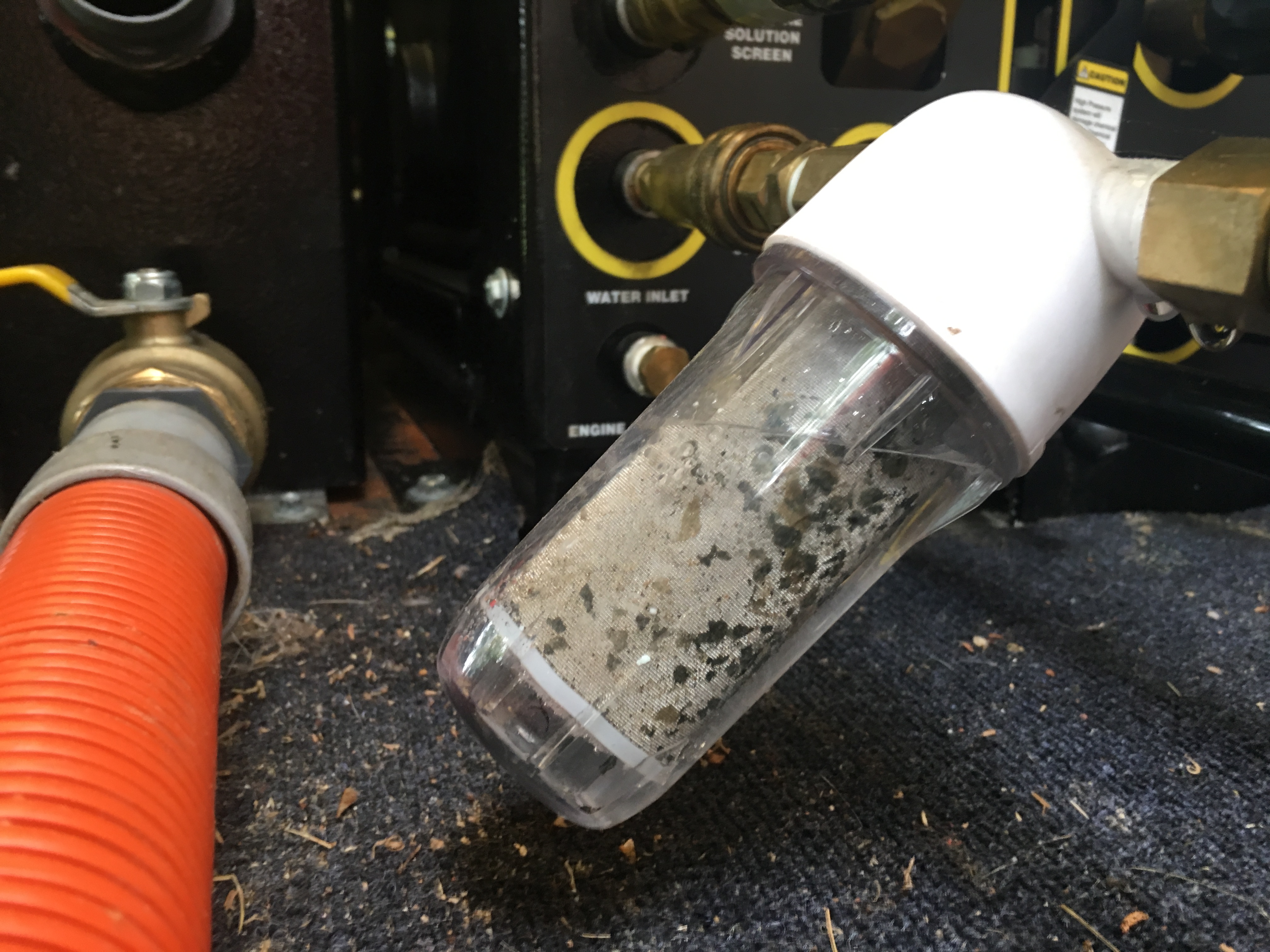

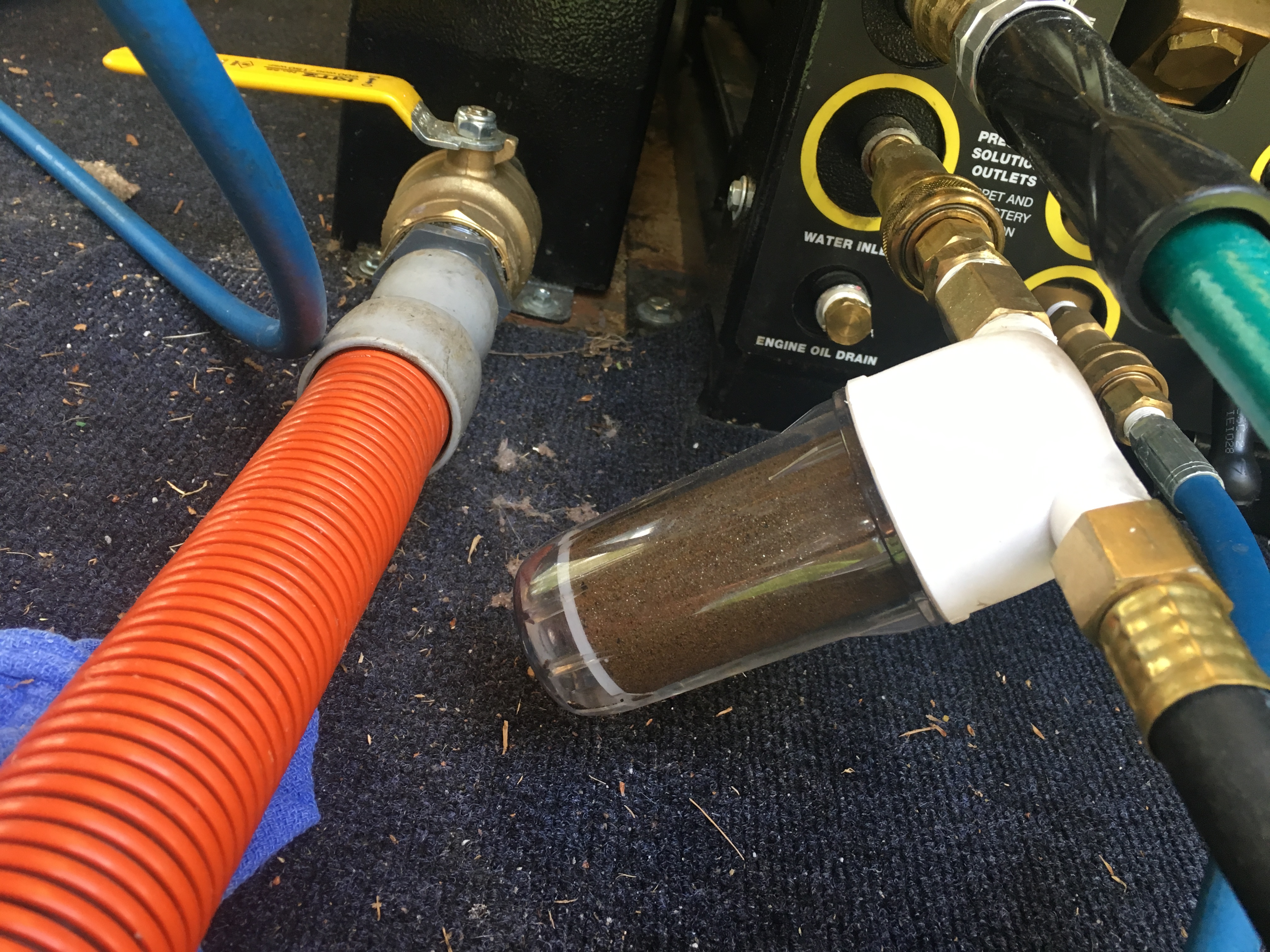

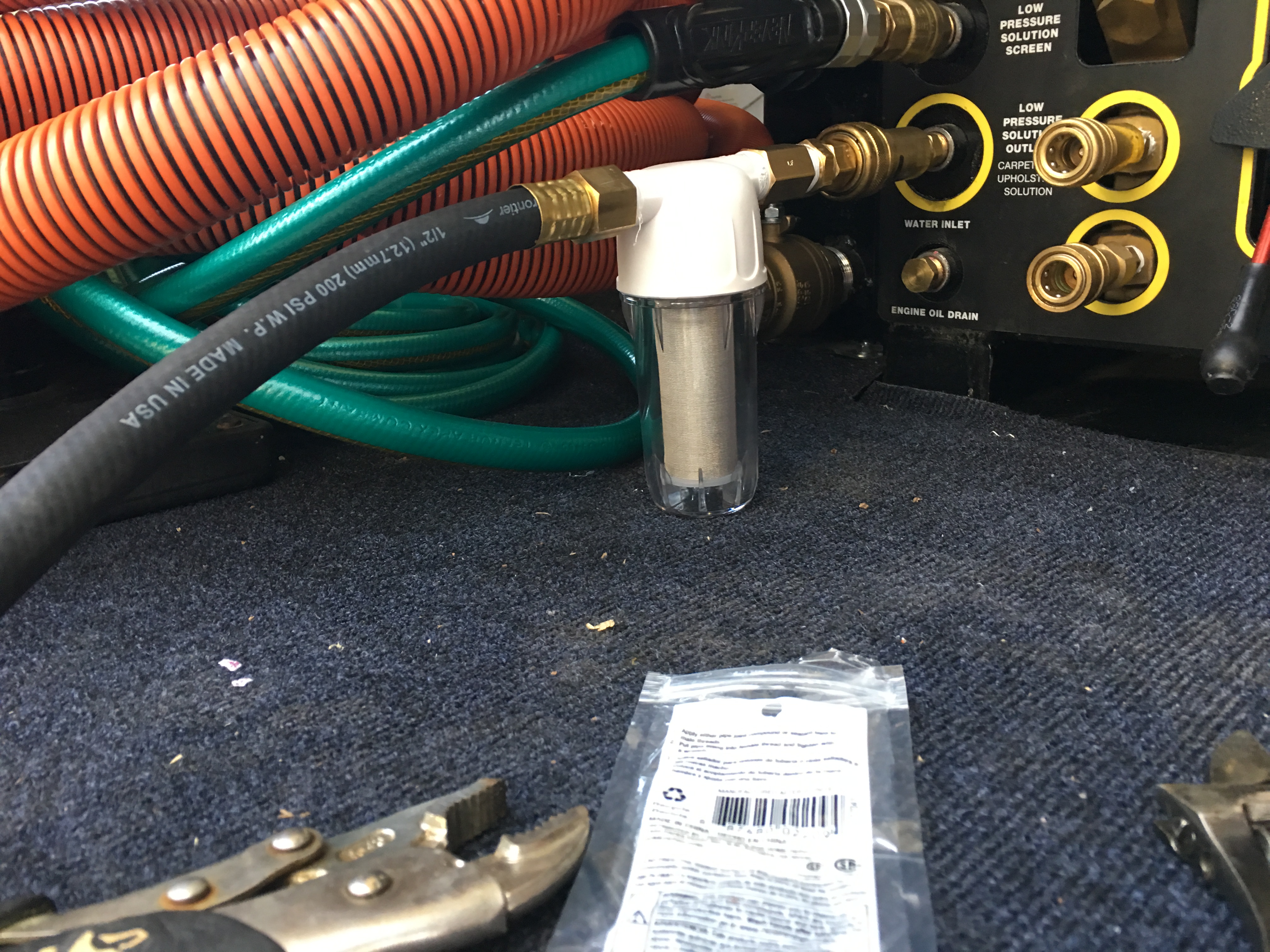

When you’re ready to be an idiot like us, don’t forget to get a good filter for the houses that have well water
8DEF07D5-5629-4548-B009-68DDD2446E9E.jpeg C575ED90-2E38-4A6E-A297-86244E960872.jpeg D01D290F-6FD8-411F-9824-0D6F5337566B.jpeg
Reactions: Hack Attack
