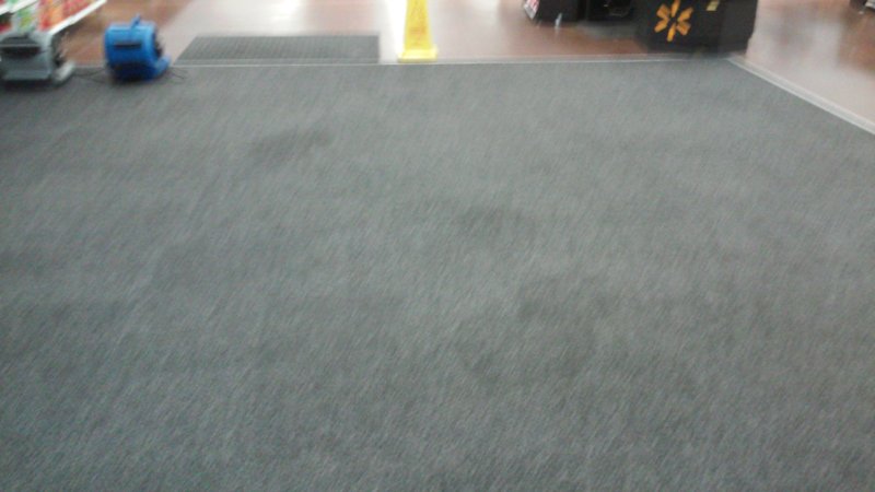

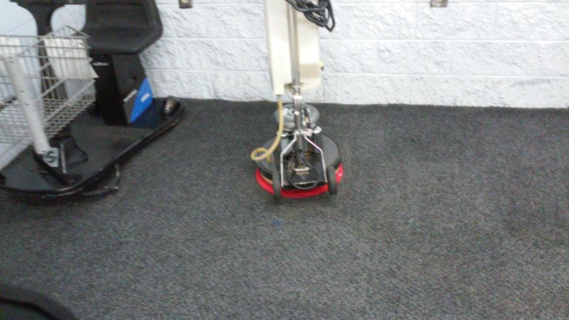

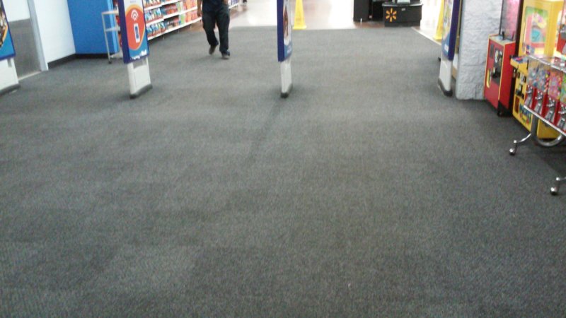

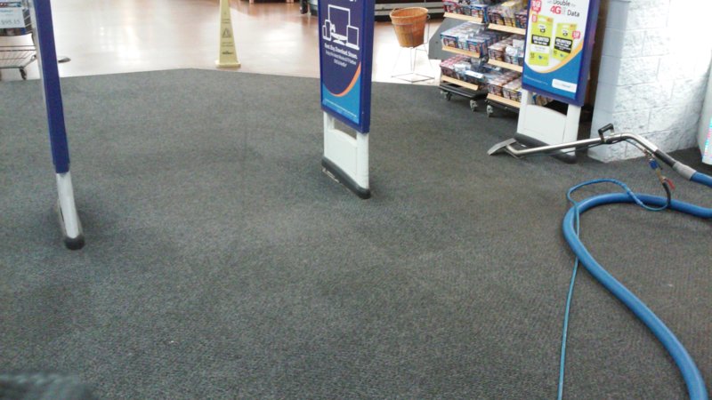

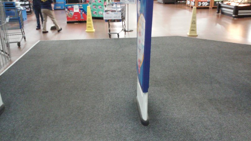

View attachment 15711 View attachment 15712 View attachment 15713 View attachment 15714 View attachment 15715 Sorry after I prevacced,
I scrubbed with a red pad. I was gonna scrub with a green pad, but that stupid huge fan above that kept blowing down on the carpet was making my pre spray dry to soon, and I was worried that the green pad would overheat. In other words, the air movement in there was fighting me. There were a few places I couldn't let it dwell long enough, worried that it would dry before I HWE
On the first pic, it's after I HWE and spots were wicking like hell right after. So I went back and did just wet back passes and dry passes, then I went over it with my Green/white bonnet with some encap juice.
So the first and second pic was during the cleaning and after it was done on one side, and the 3rd and 4th is the same way on the other side
After I was done with the whole side, I Encapped the whole area, and it didn't look much better. If they're unhappy with it, I'll either rent a Cimex or...I'll let you guys tell me which route to take.
On the second side, I did the same thing, only I didn't do any post bonnneting, because of the results from the first side.
When I got to the door on the second side, I was so tired and wore out and the dirt was not coming out. So I cranked up my psi to 750 and it blew the mud out. I probably looks like sh** right now after It dried, but I was so pissed and tired I didn't care. I was gonna look like sh** if I didn't crank up the psi, so what's the difference.
It took a lot longer than I wanted, because I couldn't get my Mach15 to get a good connection, so I had to use my little prochem quad, which took ALOT longer to do:hopeless:
I planned on this job taking 4hrs, so I priced it at $400.
It took me 6hrs, and more energy than I wanted. I HATE UNDERPRICING JOBS!!!!
I felt like an 18year old kid who had a crappy boss sending him on late night jobs like this, only getting paid $8/hr (my job when I worked for someone else in '98)
But the last few photos are of how it looked after everything was exhausted.
@Bryce C
This is a good thread to learn on which jobs to take and which ones not to take. This was 8years ago and I don't know if I would've taken this job, had my wife's aunt not have been the one to ask me (store manager). The lady is one of the good relatives that you can't say no to. But with that aside, if I was hungry for work, I foolishly would've taken this job anyway.
The bad thing about taking these jobs is both you and your machine is wore out after doing them and you can't focus on your main customers that your building your business model for
Also, keep in mind that a 15" wand like mine at the time (mach15) was too wide to get a solid connection on the uneven floor. A 15" wand should never be the main wand of choice for that reason. So 12-14" is the sweet spot. I used the prochem quad that day and it took extra time because the quad is only 11", but it had a huge performance of extraction, which met the goal of cleaning it.
As for the inline filters: This is one reason I'll never use a paint filter again. they get clogged up too easily even if you vacuum the carpet before you clean it. It happened several jobs. And if you read everything I said, it still went into my tank. So why suffer vacuum loss when you have to rinse out the tank anyway. Just get a good basket filter on your tm/machine in the future.
