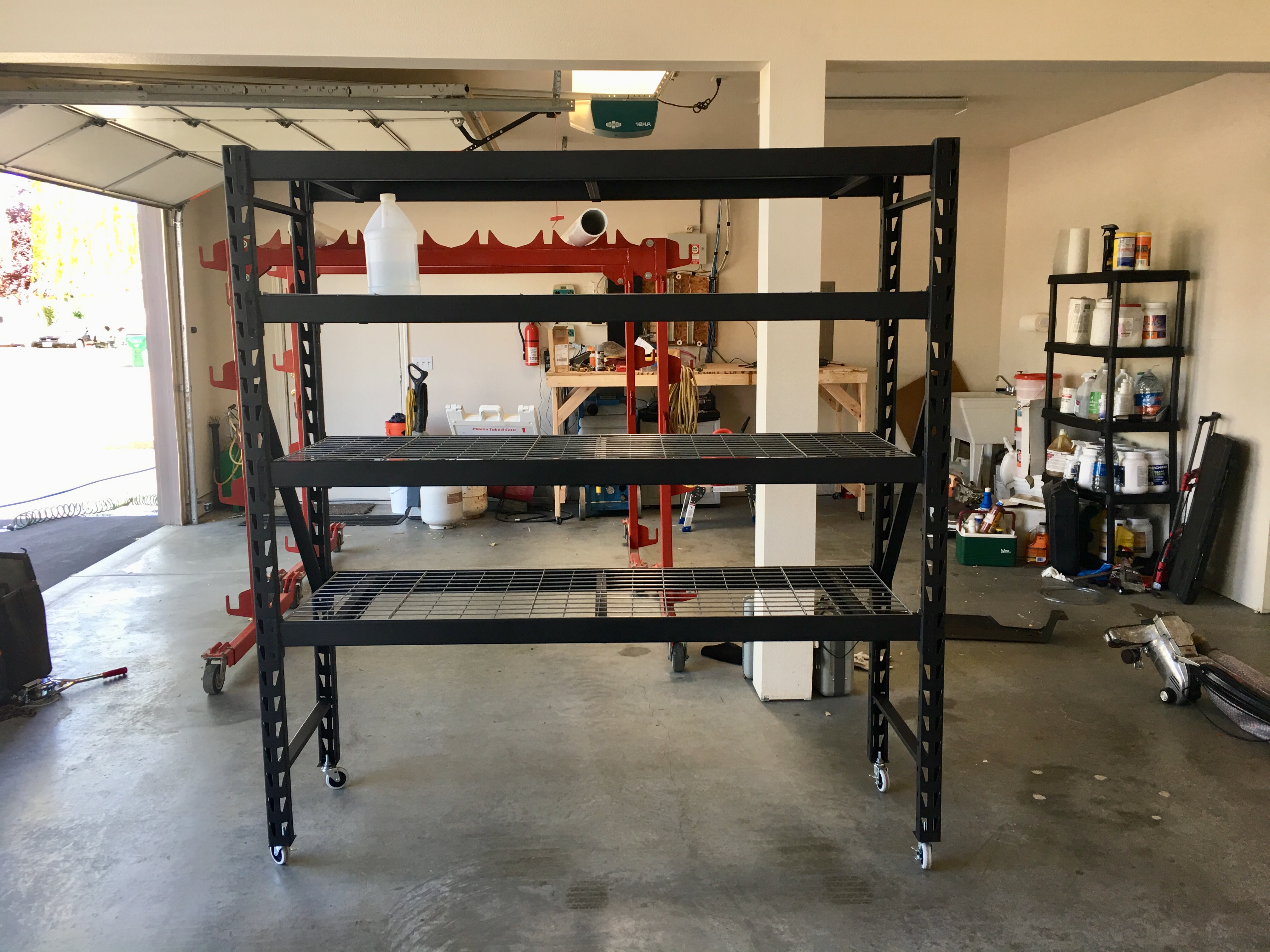

Today I got a real shelf and added wheels to replace that crapy plastic shelf that keeps falling over. I’ll use the old shelf to store toilet paper.
24,062
Every thing should be mobile or up high off the floor.
Every square foot of floor space is precious.
Where did you get that new shelf? and wheels?
Home Depot is having a sale. $165 for the 6,000lb shelf. The other shelves are also on sale. I may go pick up another one today. I added the wheels onto it. I’m tryi g to keep everything mobile until I settle on a final configuration.
I agree. Everything off the floor.

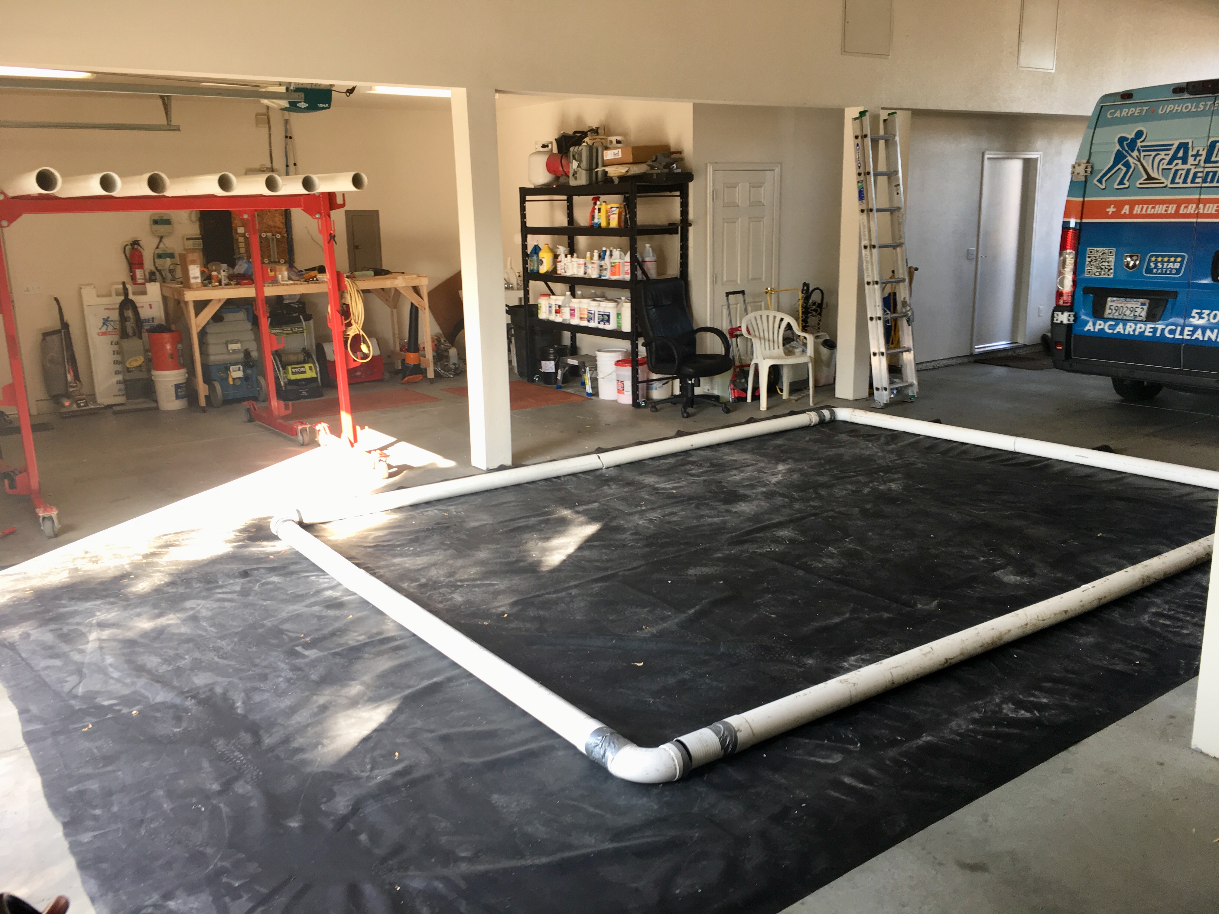

I just got my rug pit liner all pressure washed. Took me two days. It was loaded with roaches and didn’t want to put it out until I could clean it. Those roaches had a long drive from Ventura. I couldn’t believe they were still alive.

I have an inflatable 15X18 Australian was-pit with the grids and some world class training.
Thanks Ron. I may take you up on that and come visit. This is my pit I’ve been cleaning all day. I would do more but I need to get home and play with my boy. I have a pump/recirculating system I need to hook up as well. Still lots to do but I’m getting there. Also, my new shelves kick butt. I have a lot more organizing to do still.

Is that the best place for a propane tank?
