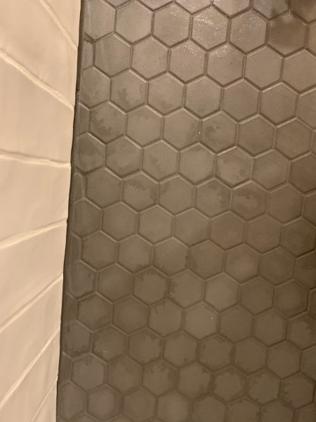

So this is what it looks like when people try to repair it with coatings This appears to be an older floor at that?

For Fred's sake, Porcelain is less absorbent than earthenware but will still stain unless vitrified. That process creates the impervious glass-like product with which we're most familiar.
No vitrification? Porcelain stains.
Polished porcelain takes the glaze-like surface off, so makes vitrified porcelain into no-vit. "Polished" is likely the product giving tile cleaners fits, as it has to be sealed to stop staining. In many cases "polish" should be called "honed" since they're doing it to create a dull finish.
Kind of funny that the trend is toward shiny rug fiber and away from shiny stone and tile surfaces; in both cases the product is worse.
116,005
This the water staining or whatever you want to call it is showing up on all types of porcelain, it's just far more visible on the matte finish variety that has the very realistic photograph of either wood or stone.
Yes.
and coatings are often added on polished/honed. Which is likely what is being removed. I think the staining we are seeing in this example is a consequence of the incomplete removal given the "pattern" . An epoxy grout haze remover is more likely to remove the coating with longer dwell.
Then a penetrating sealer/porcelain specific can go back....assuming some other process wasn't used for the matte finish

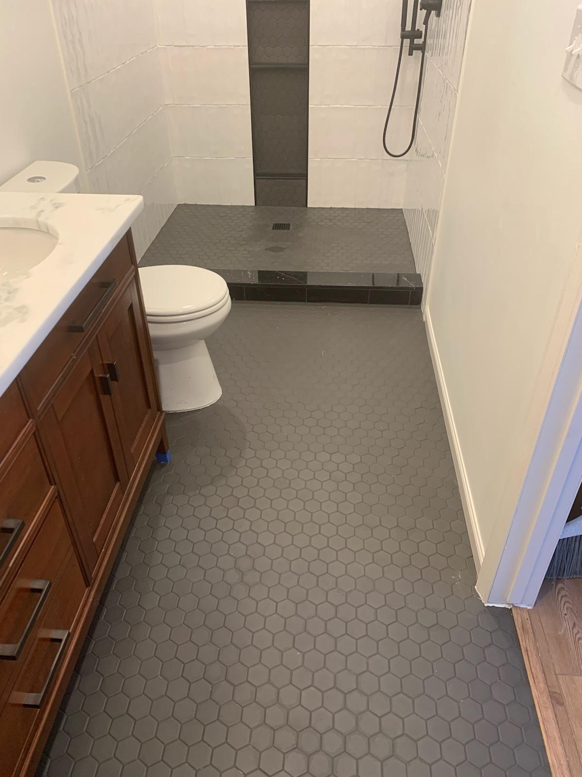

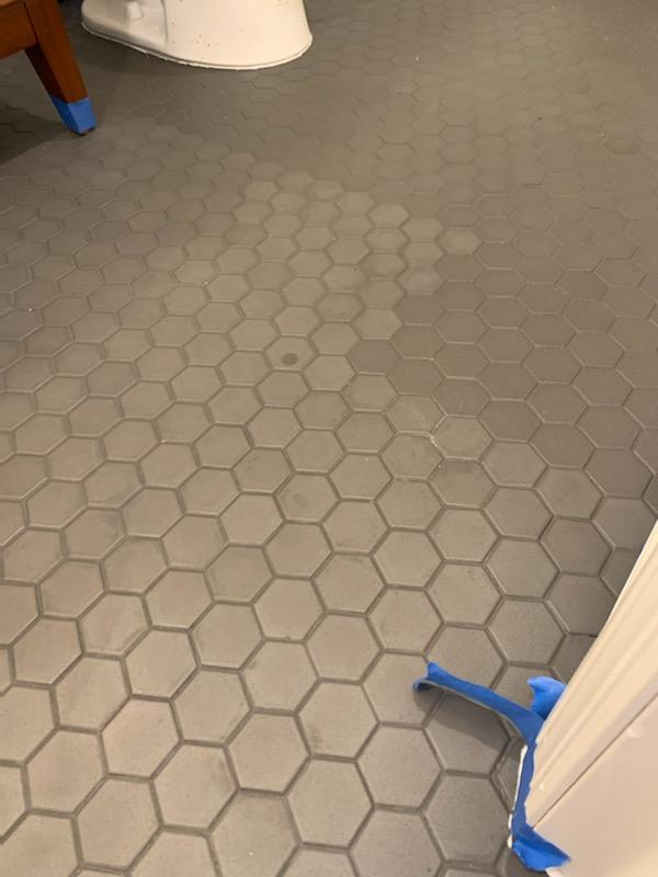

The whole floor has been colors sealed. the light area is where she used the haze remover.
At this point she has give up as water is absorbing into the tile and leave marks.
Time Yeater has been plying with some aluminum oxide finishes that can be mopped on, that dry level and look great...BUT leave the grout cloudy and or shiny.
Ripping this crap out is the answer, despite what Fred thinks.
