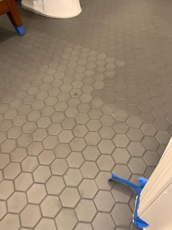

For Fred's sake, Porcelain is less absorbent than earthenware but will still stain unless vitrified. That process creates the impervious glass-like product with which we're most familiar.
No vitrification? Porcelain stains.
Polished porcelain takes the glaze-like surface off, so makes vitrified porcelain into no-vit. "Polished" is likely the product giving tile cleaners fits, as it has to be sealed to stop staining. In many cases "polish" should be called "honed" since they're doing it to create a dull finish.

This the water staining or whatever you want to call it is showing up on all types of porcelain, it's just far more visible on the matte finish variety that has the very realistic photograph of either wood or stone.

and coatings are often added on polished/honed. Which is likely what is being removed. I think the staining we are seeing in this example is a consequence of the incomplete removal given the "pattern" . An epoxy grout haze remover is more likely to remove the coating with longer dwell.
Then a penetrating sealer/porcelain specific can go back....assuming some other process wasn't used for the matte finish

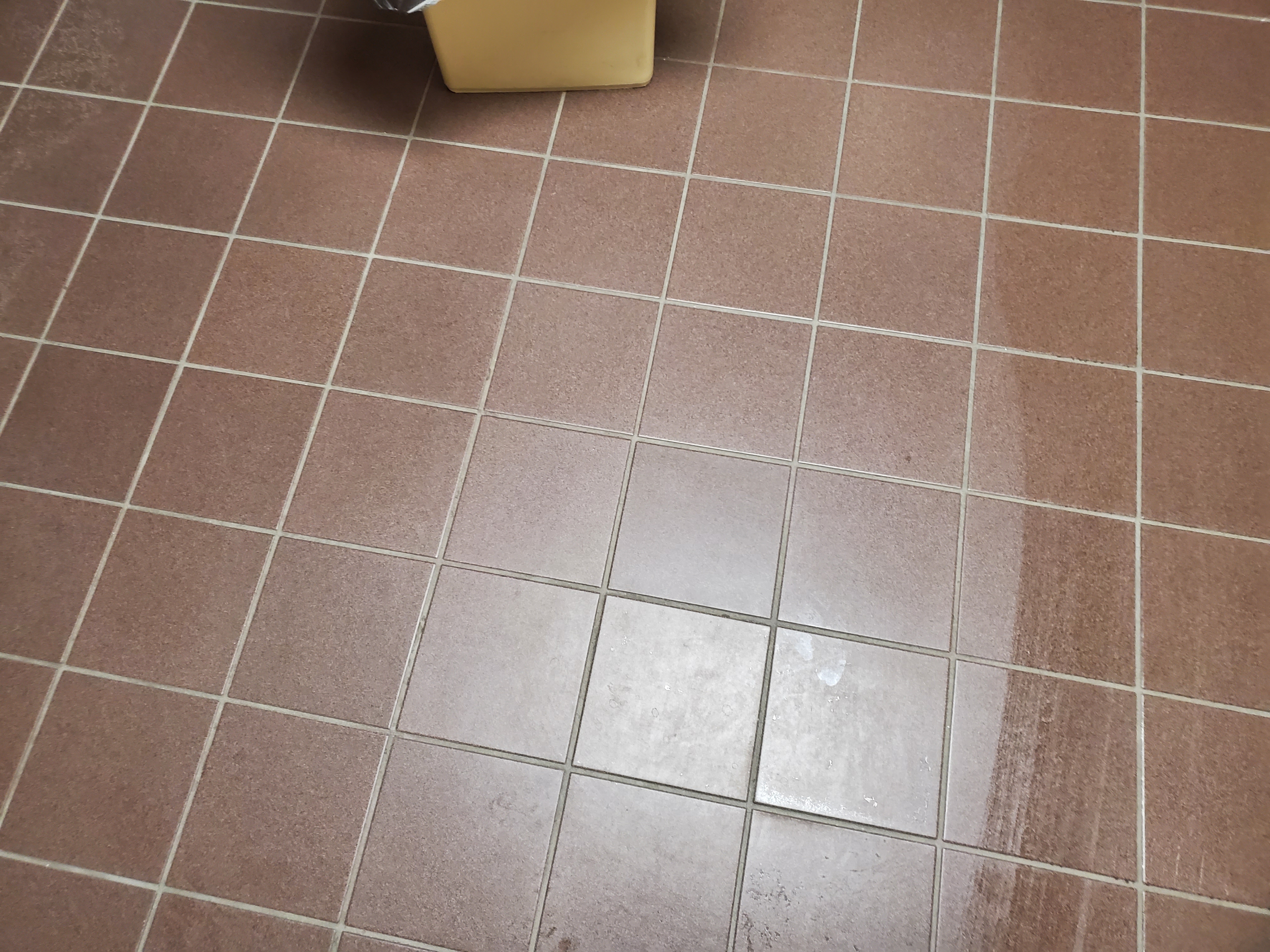

You seem to be hung up on the epoxy grout haze remover and in this case none was used, I posted a picture sent to me by the homeowner of what she used
I guess I'm just not explaining it right.
Whether or not epoxy grout remover was used there seems to be something that removed or damaged a topical finish. I mentioned the epoxy haze remover because given enough dwell it is the most likely to do so out of what I thought might have been used by the home owner. There was also a chance, with only pictures to go by, that given the grout color and small tile that what might appear to be a coating wasn't one at all.

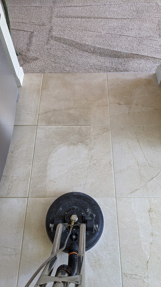

Looks like color seal left on the edges.
Told this story before. Had a customer 15 years ago that sued the builder and tile manufacture, because there brand new porcelain tile in the kitchen, (new home) matt finish, was impossible for them to clean. Just like Mikey pic, turboed easy. Rest of the home had the exact same tile in a polished finish, not glazed. There was no issue with that. They went to court and lost because it was determined the tile was non absorbant.
It's not the absorbency that's the problem, it the surface texture.

The whole floor has been colors sealed. the light area is where she used the haze remover.
At this point she has give up as water is absorbing into the tile and leave marks.
Time Yeater has been plying with some aluminum oxide finishes that can be mopped on, that dry level and look great...BUT leave the grout cloudy and or shiny.
Ripping this crap out is the answer, despite what Fred thinks.
