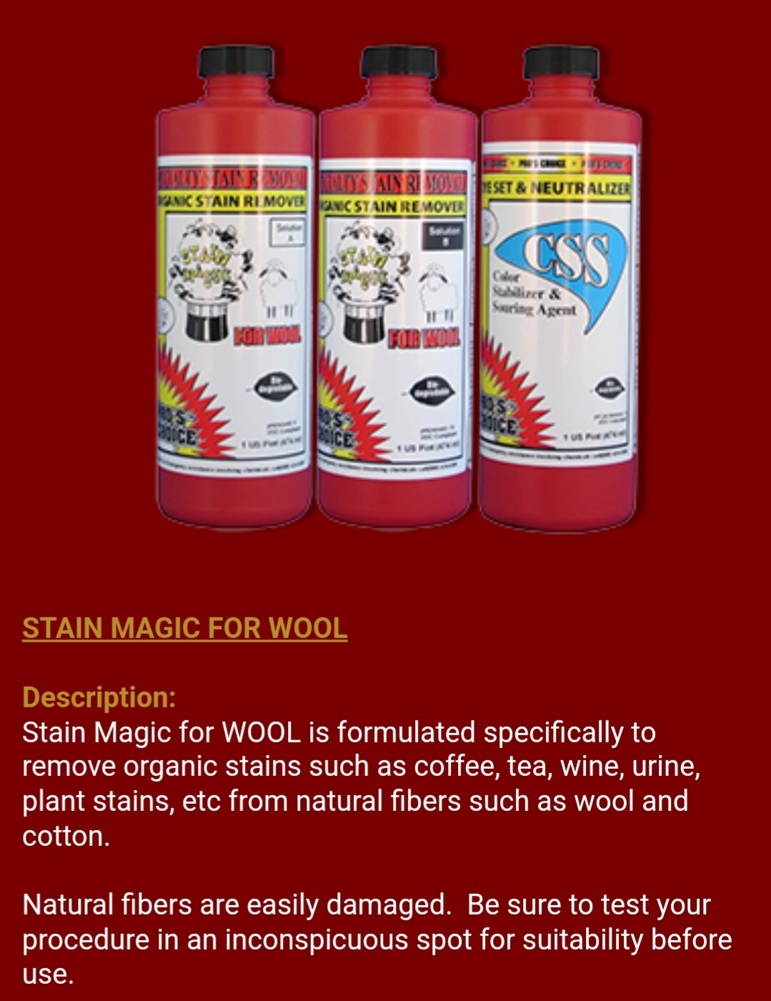

Great advice everyone! Thanks!
Stain Magic for Wool looks promising.
It's shameful that after all these years I've never tried it. How embarrassing.
Thanks again. Much appreciated!
