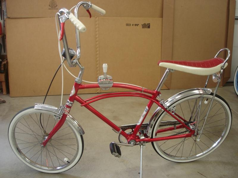

What kind of bike is it that you're using for an avatar? Pretty cool. I have a CCM Charger like this that I found after 5 years of searching.I'm hunting a Marauder now.
I think Fred made it my Avatar. I have a dozen bikes but they are all rideable by me except for the E-bike I bought so a hot young lady could come ride with me....
