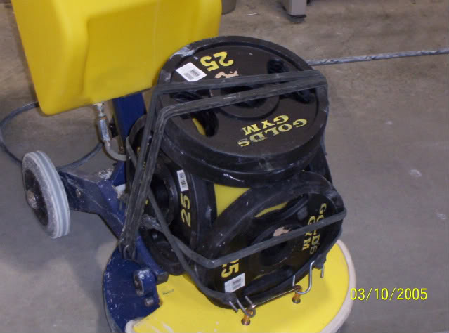

Diamonds are like 10-15lbs per stone, maybe a little higher...but with 9 diamonds (3 on each of the 3 drivers on a cimex) they want over 100lbs....
here is my set up for doing stone or concrete

I tried put 100 lbs on the cc cimex when I had it. Funny, that thing just kept going.

hey if no one is around screw it...and yes it worked very well....extra 125 lbs.....worked like a charm
