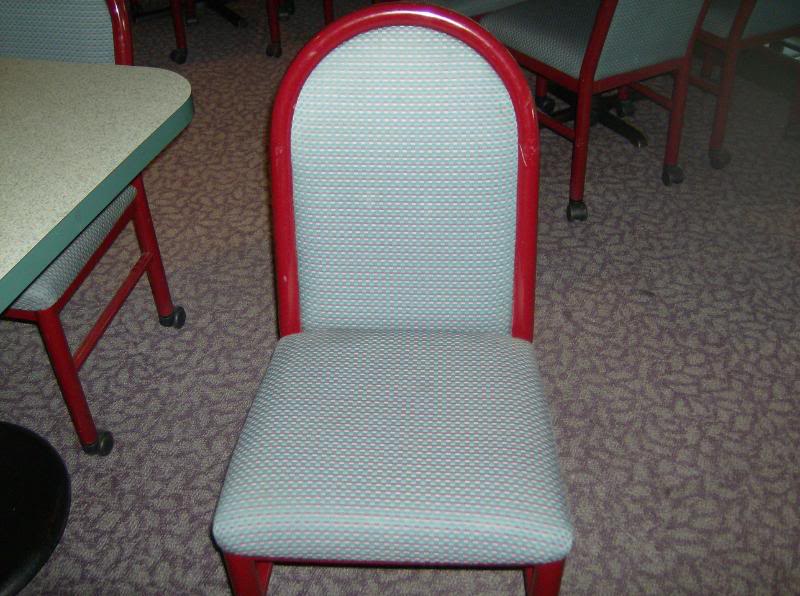

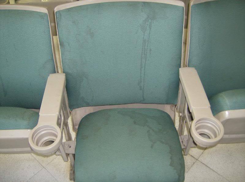

i have 400 of the chairs and 300 of the stadium style chairs to be done..i have never encaped chairs but would love to if it will work here..
what would be the best tool to tackle this job..i was thinking of some kind of hand mitt with some encap punch or a right angle drill with a pad or something..
thanks
dave

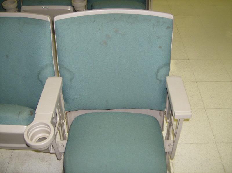

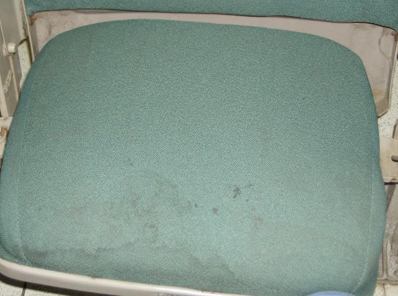

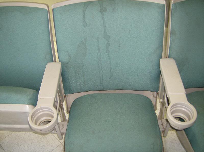

300 of these, they are all pretty bad
and 400 of these...these are really not that bad at all
