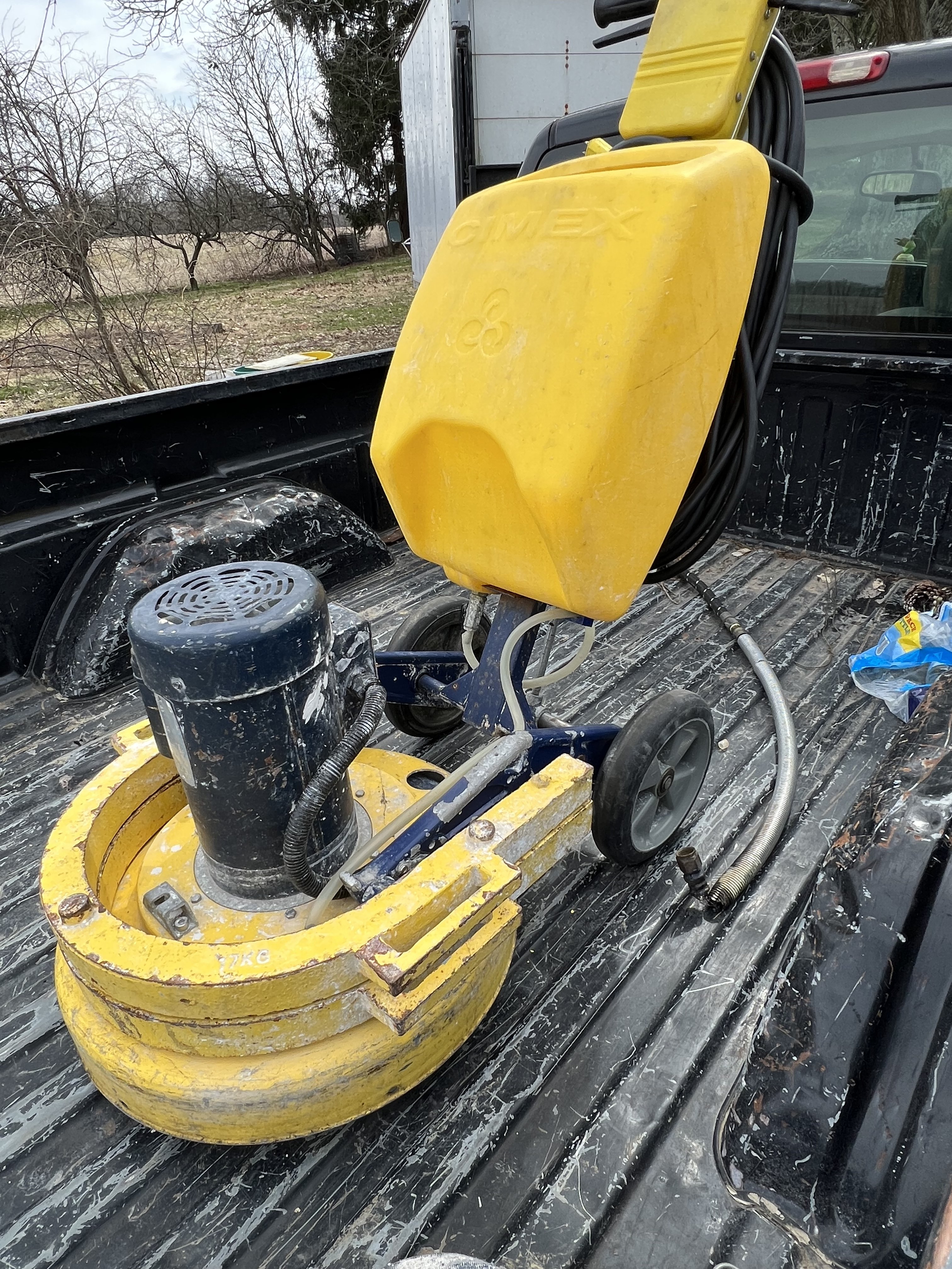

Discovering SPPs was a game changer for me. Running them under a Cimex Diamond Finisher and 70# of additional weight was even more so.
Anyone ever try those Twister pads?

Spp’s are pretty aggressive if you use them like stripping. Flood the floor with a 175 and neutral cleaner in a tank. Once you get vacuumed up, you can see if some might not be off. Take a square to those areas dry. Easy peasy.
9,342
Yukon, Oklahoma
I discovered that the Cimex still doesn’t do as well as a 175 imo. You can’t heel it to get tough marks or areas like a 175. I’ve used both, and the 175 is still King imo. I thought I would use my old Cimex for that, but I abandoned that idea.
Add 70# to the front and increase the rpms and it does great. The one I’m using for VCT is a stone polisher model. The 175 does way better than the standard issue Cimex for sure though.

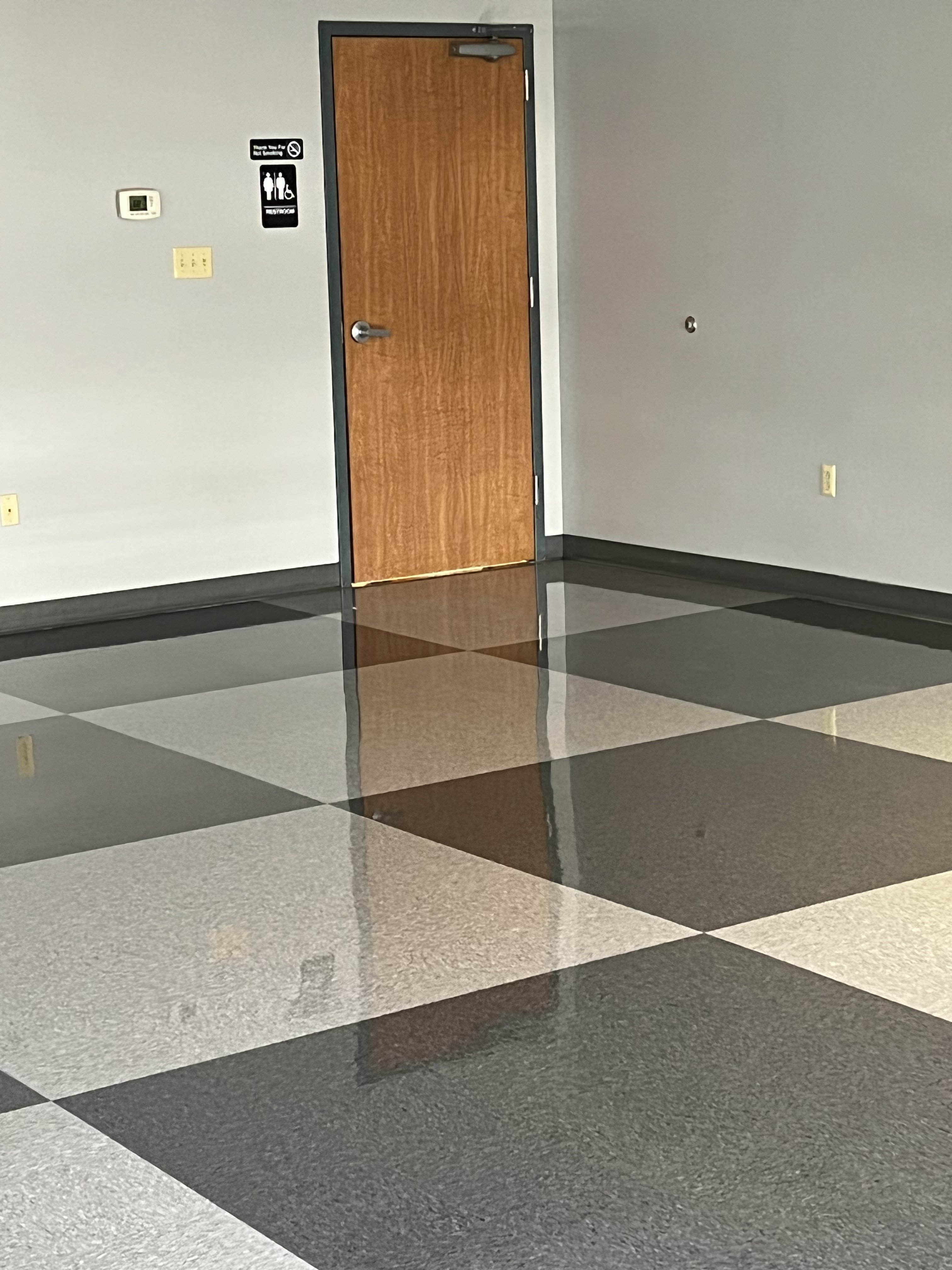

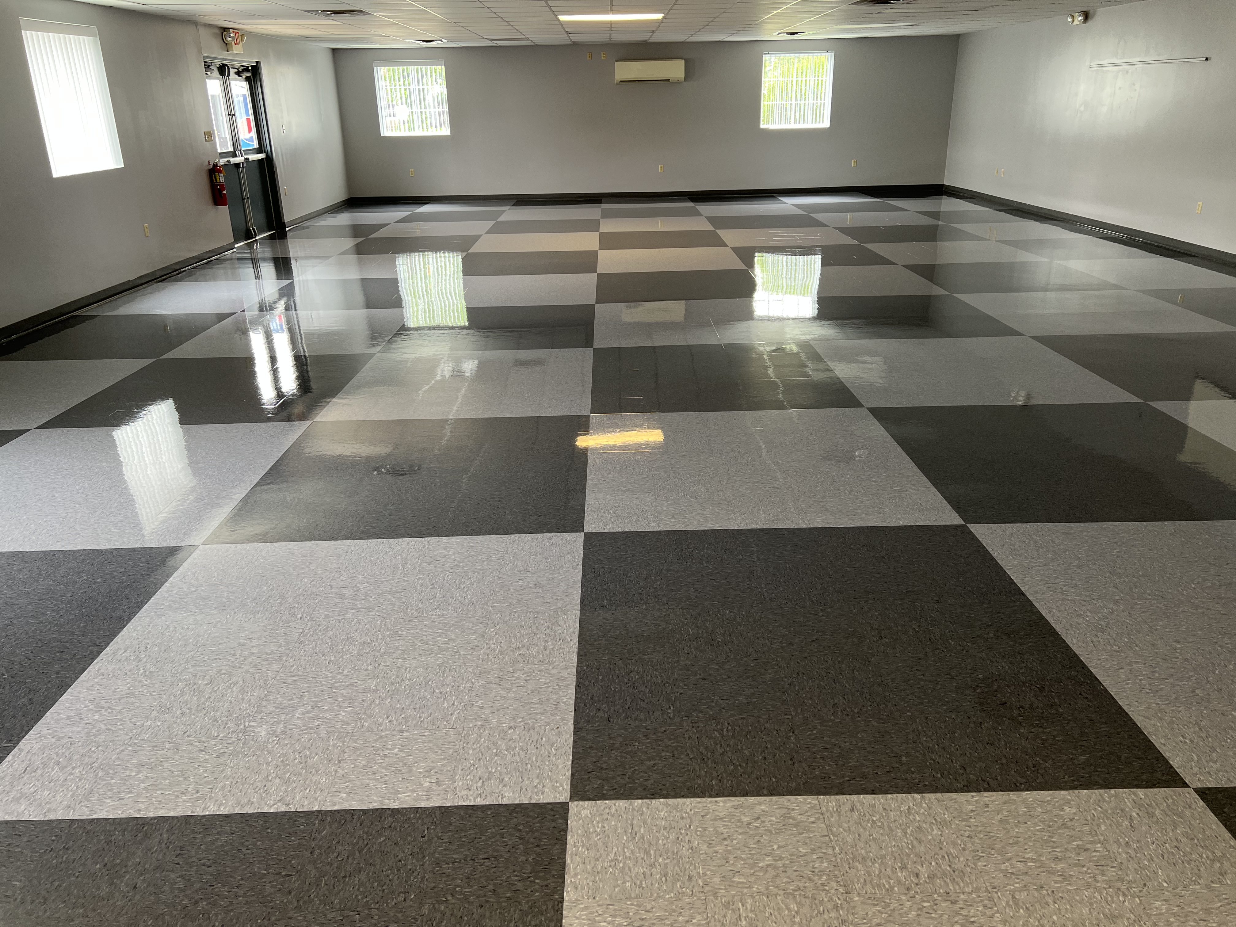

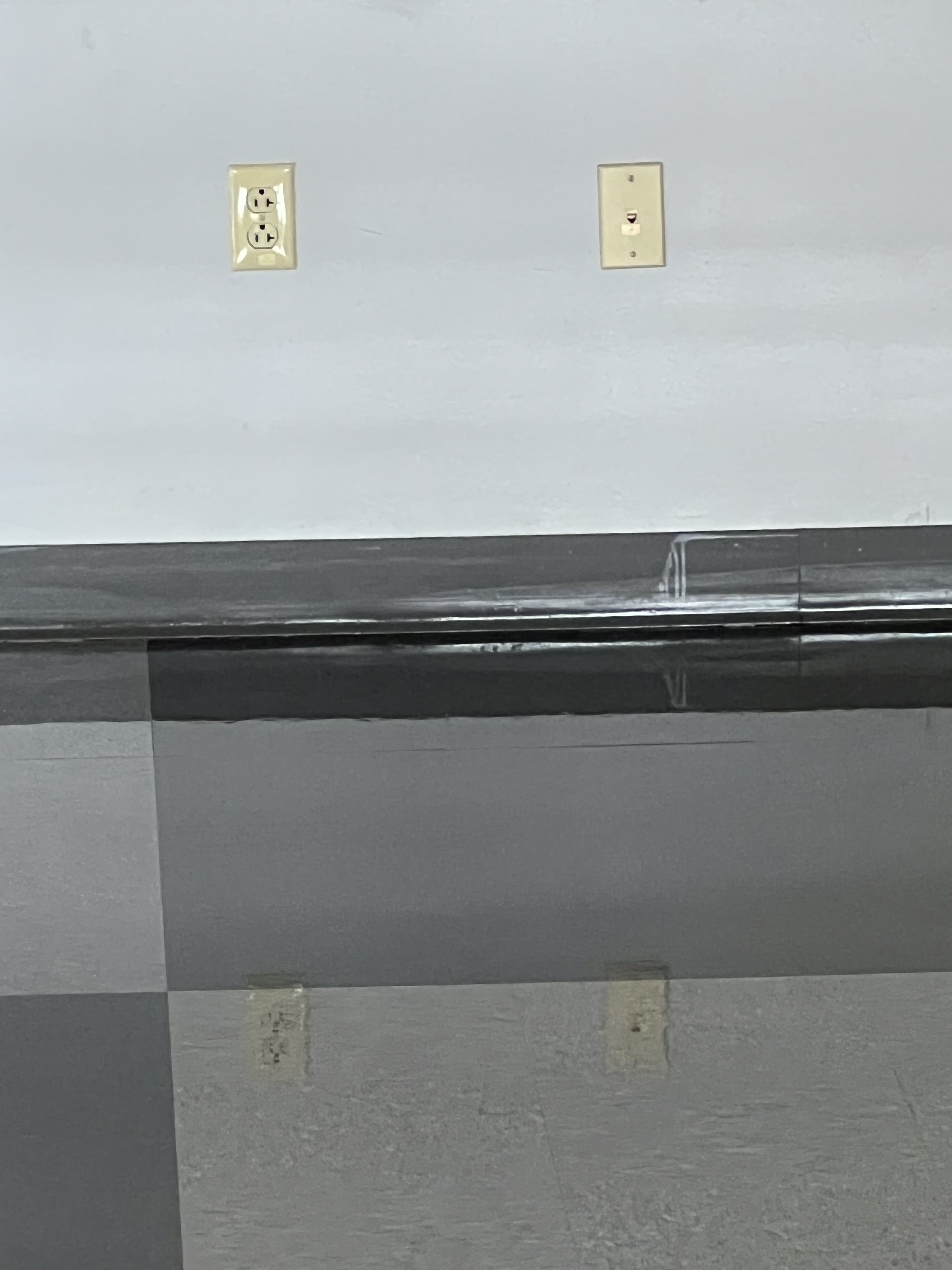

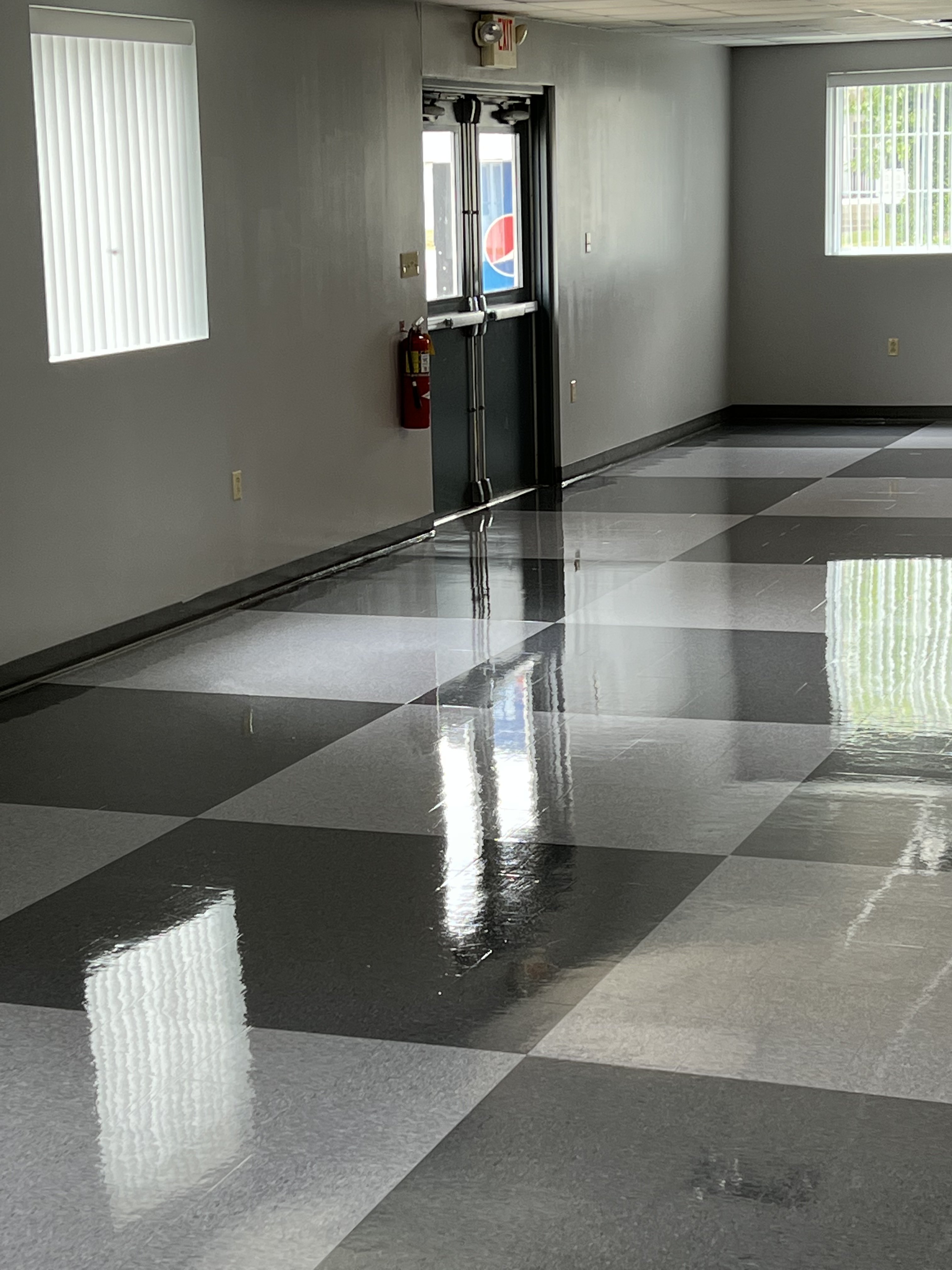

Some pics from yesterday’s job.
We used SPPs under the Cimex Diamond Finisher plus 70 pounds of weights, Zep Neutral Cleaner 2 opg, and Spartan iShine for the finish. The finish is dry and walkable in these pics.
View attachment 123027 View attachment 123028 View attachment 123029 View attachment 123030
I remember Jim's post about regulars picking fly shit out of pepper (with boxing gloves) - BUT - are you going to wax the cove base? Nice job Joe! Armstrong excelon 0.80 gauge I bet.
