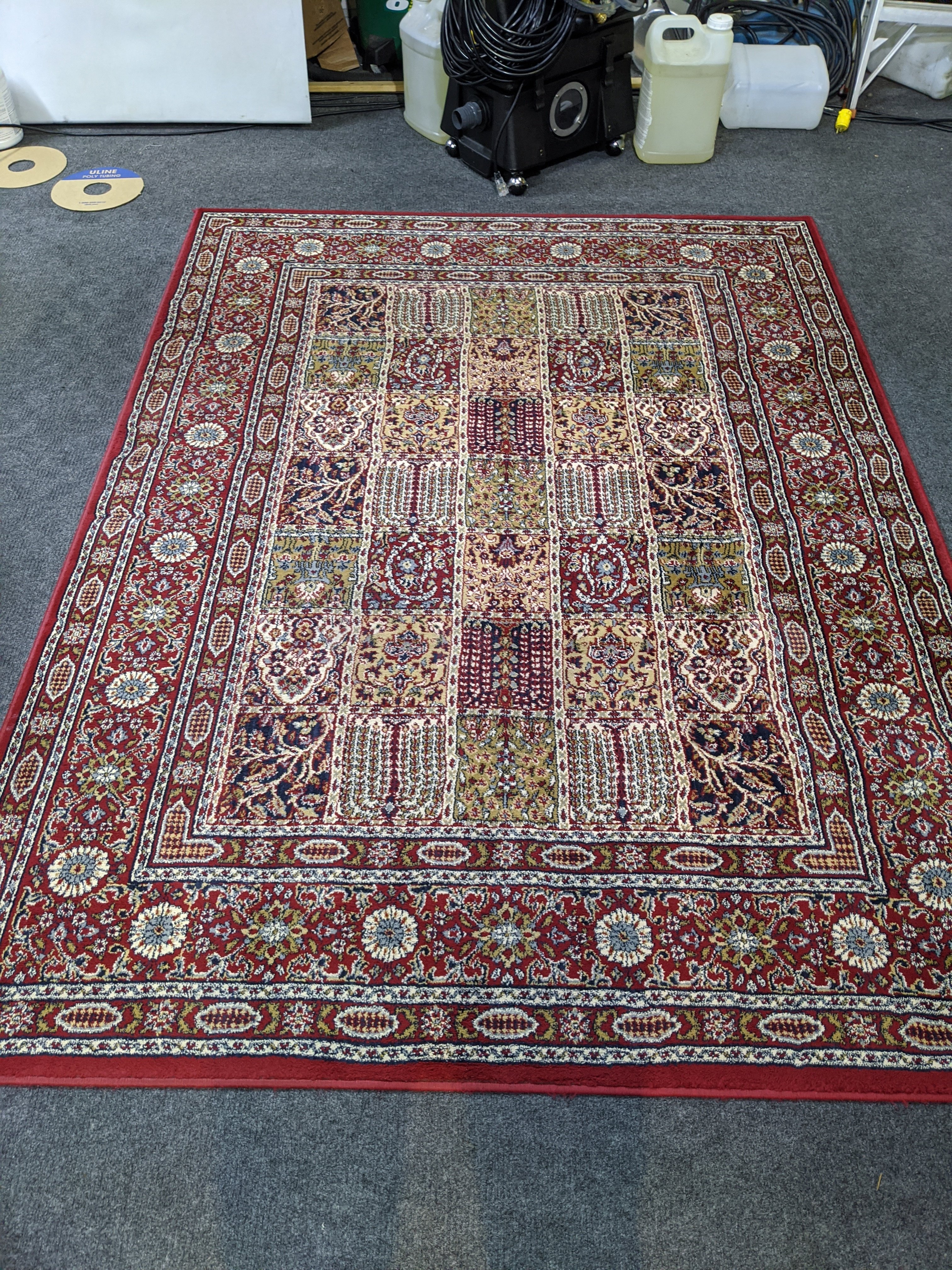

I'll make a video of my next one, it's a doozy.
Here's a couple of pics.
27,878
And what is it they expect from you?

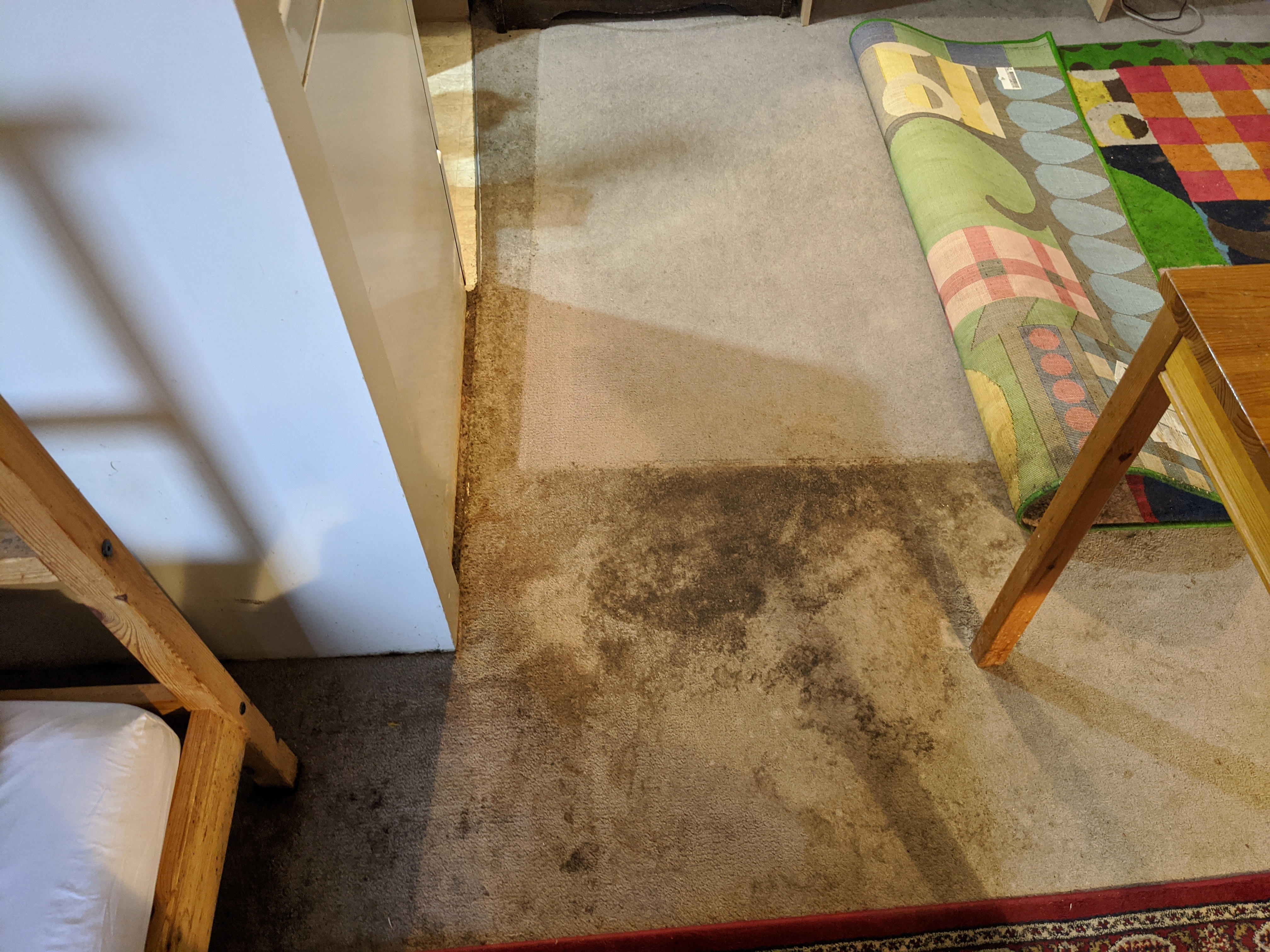

Just to be a little more sanitary when he gets out of the hospital. $450 for the total job. Only took me 1 hour today to clean up, pull the rugs and vacuum. I'll clean the rugs today, just polypropylene. Next week, I'll bring my big portable and rotovac, along with some code Red and 40 volume. Not tm accessible. Price is a little low but it's 2 minutes from the shop.

27,878

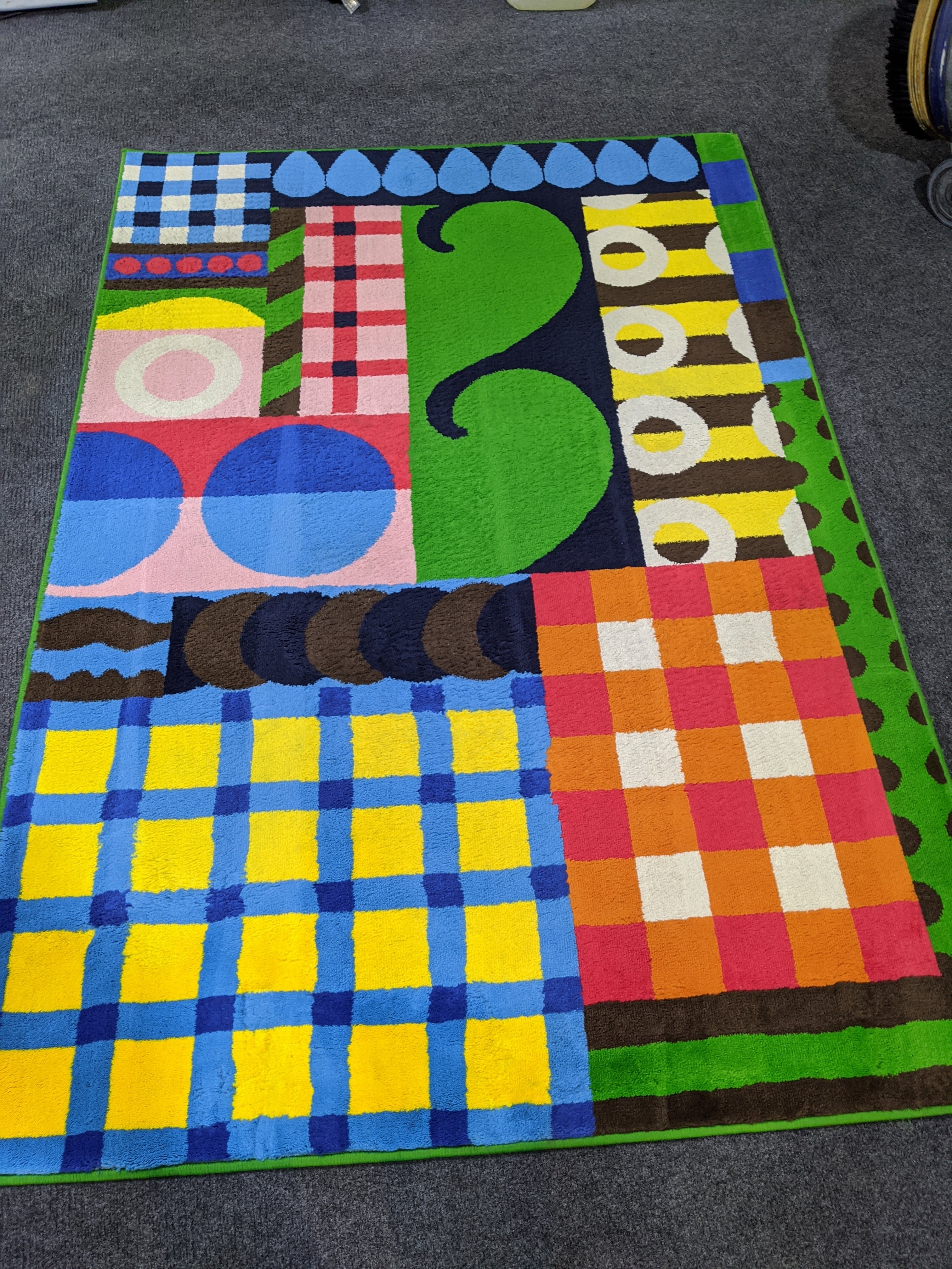

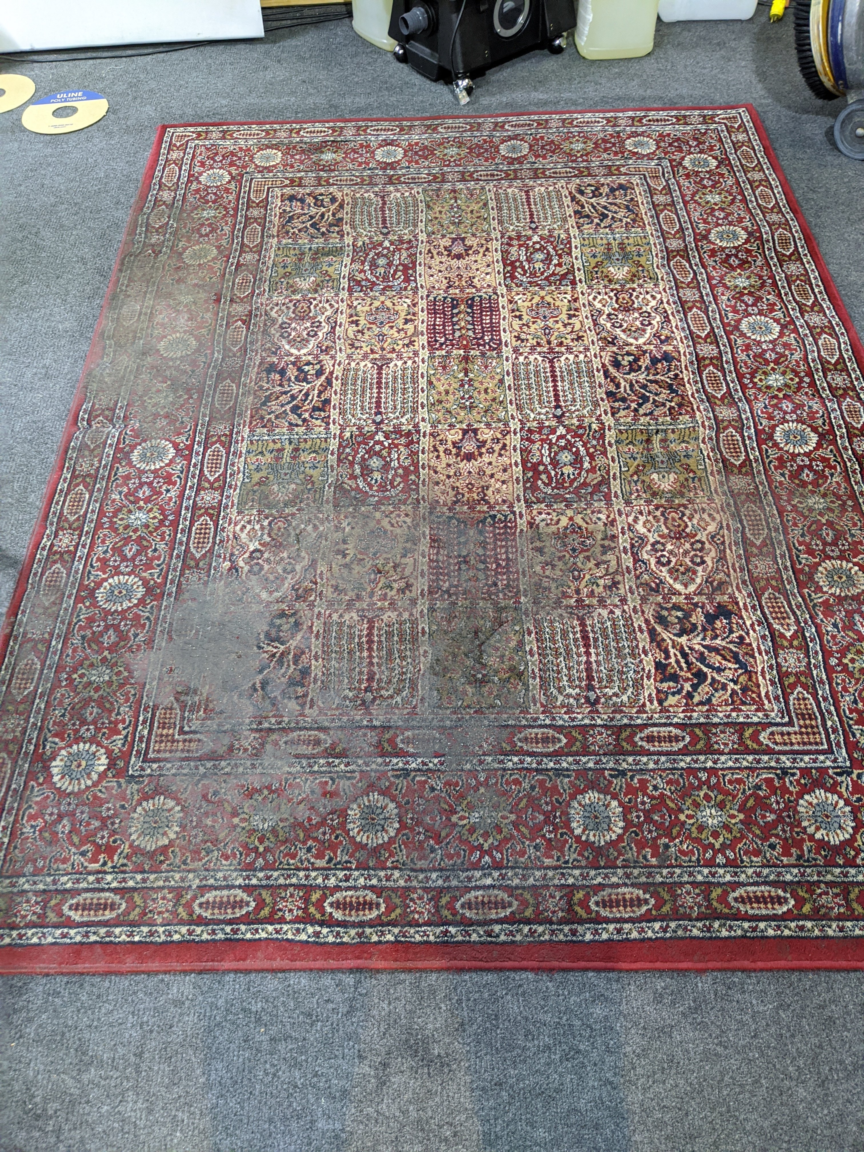

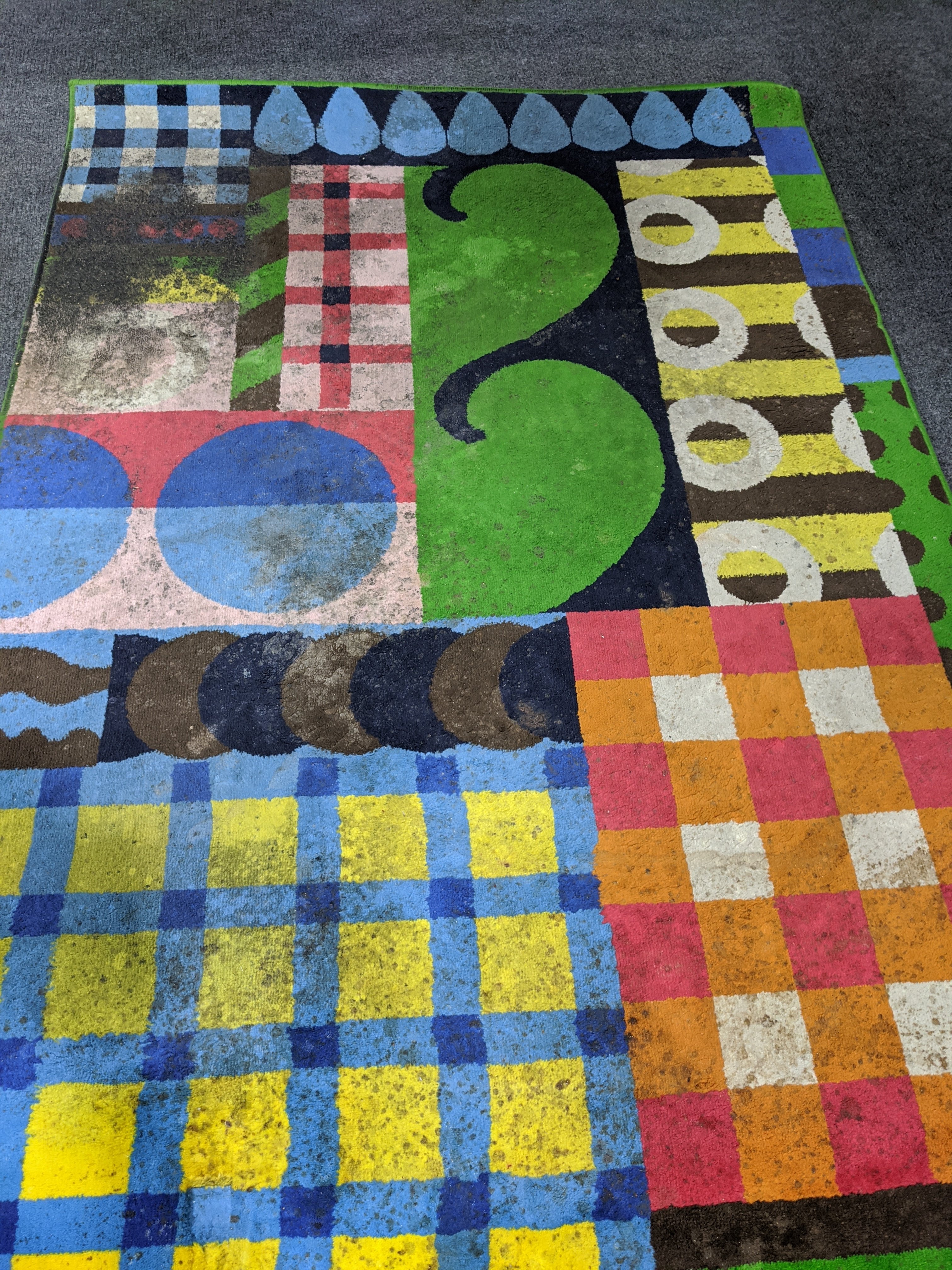

Did you clean those with a portable or give them a bath? They look great
Presprayed with Code Red, then shampooed with 175 using Enzall from Chemspec. Let dwell for 1 beer, then scrubbed with rotovac with brush head, then flush with a Zipper hooked up to my large portable using a propane heater.

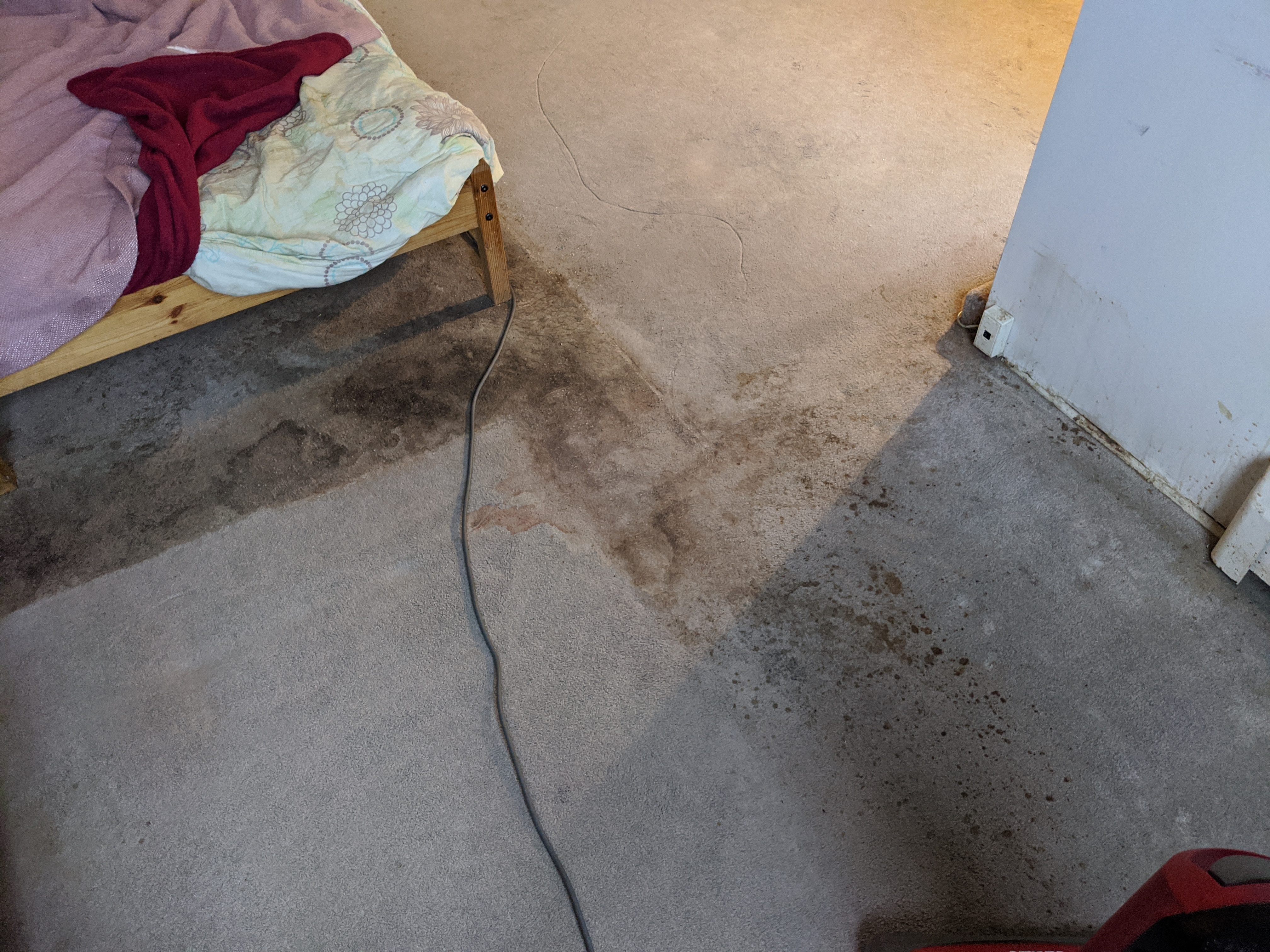

I've been a pissy mood all day as well. This week is killing me and my shoulders are screaming at me. I wasn't going to post this, but you drove me too it.
I did that exact same apartment back in the summer, and remember I don’t do residential.
