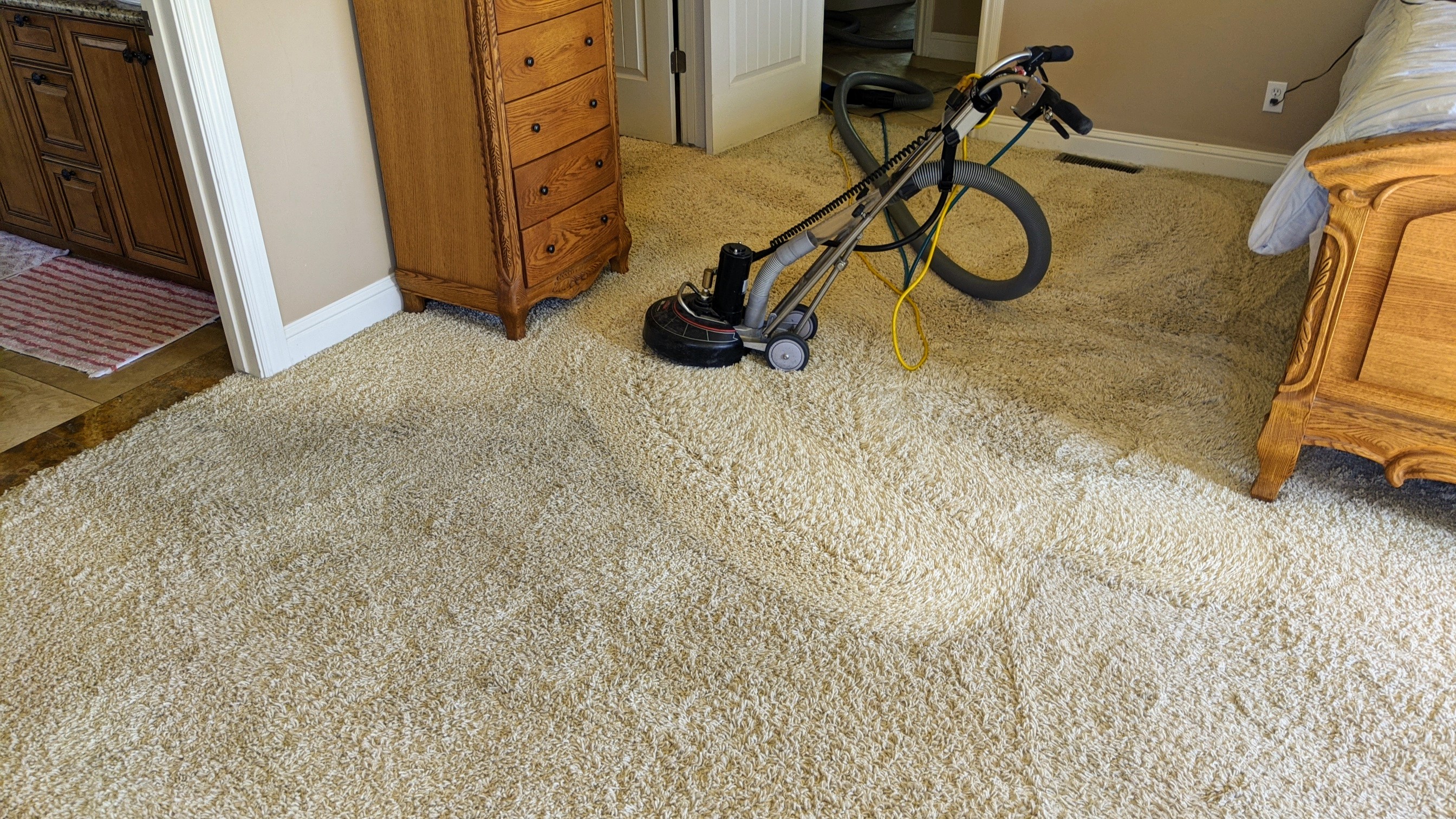

I like to prevac to keep the brush a little cleaner. Still pull out a ton of crap.
117,352
This guy has lived in the house for 5 years when he bought it the carpet was dirty from pets he hired a carpet cleaner that he said made no difference four years later he hired another carpet cleaner again no difference then today with a good pre-vacuum some power burst and the 360i as far as he was concerned it looked like new again

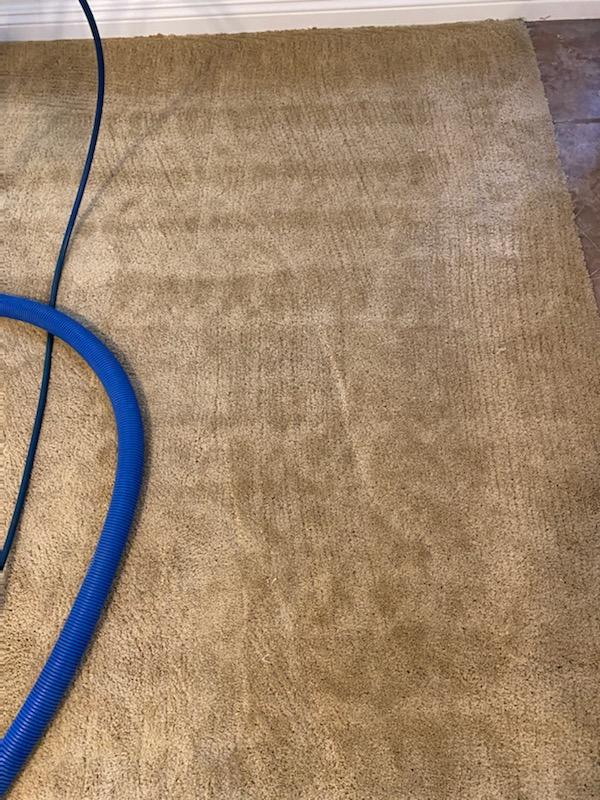

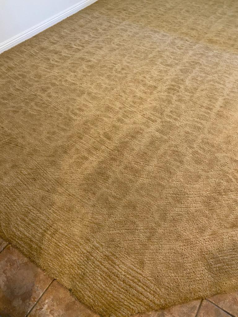

Speaking of this the member here sent me these two photos of some damage he created with his rotovac three port non-brush head with a moderately distorted brass jet..
The odds of him being able to fix this sir pretty slim...
  • Wow
