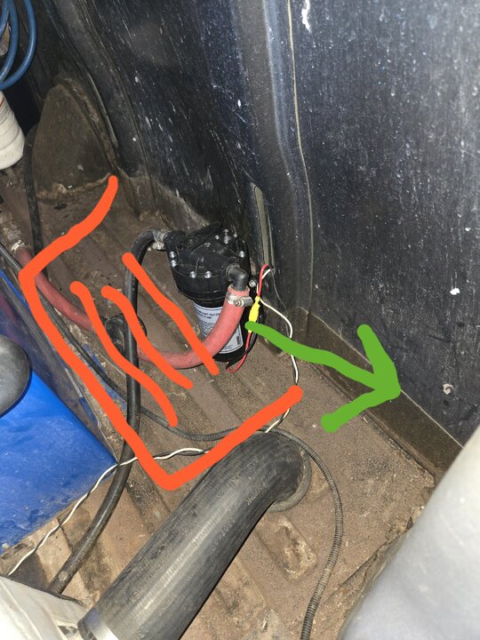

So Pete is willing to take it back, the way he's talking I'll definitely be waiting until November to get the PTO long tube style heat exchanger from him. Dwain I would happily and gratefully loan your tube style heat exchangers and pay for shipping and throw in a box of chocolates 😁
BUT! What if I slap that thing on the floor behind my waste tank? I'd only have to relocate the transfer pump closer to the drivers seat on the other side of the blower exhaust. Seems like this may work really easily. Then I'd have a massive volume of hot water and no need to deal with Pete. What do you think?

Thanks Dwain, but before we go that route... what do you think about me using the Blue Baron heat exchanger in the location I posted pictures of?

I was talking about the heat exchanger from Blue Baron. Maybe you didn't see it posted earlier but I am wondering if I should just go ahead and mount the Blue Baron heat exchanger in the location I described behind my waste tank, I posted pictures of it. Seems like it will be super easy to drop it in and run lines to it. Hadn't thought of it before this morning...
I can't answer that for you. Thats something that you have to figure out. Do you want to keep it or get the one you ordered? Thats your decision. I will say this, once you attempt to install you bought it . If retuns are difficult now they will be impossible after. Let me know so i don't tear these bundles apart and pressure test.if your going to keep that one ill just put these back on the shelf. The only machine i have that uses um is my spare and it has a fresh bundle in it so there just spares for a machine in not using

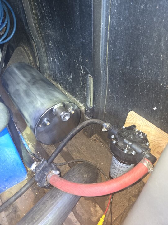

Well I think it fits. And I can plumb coolant lines to and from it easily. How does this look bud? I relocated the transfer pump and it works fine in its new location. I only rested the new HX in place for a pic as I still need to get fittings and insulation and mount it on a board so I can easily bolt it to the floor on the front side.

Woody mentioned using a Y to install a bleeder valve. Any reason to use a Y over a T fitting? Does the flow of liquid coolant around 90 degree bends make much of an impact on the coolant system?

I really like the new HX and I'd prefer to keep it. I think it will provide serious heat over a tube style too. All things considered I think I am going to go for it with this thing. And as a bonus this will free up more space under the waterbox to organize lines and have room to work on things whenever I finally take the old HX out and plug the holes in the recovery tank. Family is visiting but i'll be doing a bunch of work on it soon.
I have no opinion, i can't tell if it's good or bad. I have no horse in that race.by the picture It appears that it is setting on the floor behind the passenger seat. If so be sure the seat fits and works to your satisfaction. As far as a Y vs T for ableeder Y would be nice but if not available tee works fine . Keep in mind the coolant is going to go straight thru . The higher side is to bleed air and providing that whichever is lower than the top of the radiator itll fill all the way up whichever you use. It would matter more if you were trying to feed multiple heat exchangers with the same coolant line then a Y would work way way better. Let me know what you do. If im not shipping these ones i have im going to put um back in the storage side of my shop and deal with um in the winter when im looking for something to stay busy
It's behind the driver's seat. I had the seat out to move things and take a pic. Thank you Dwain. You've got a big heart thanks so much for offering to loan me the tube style HX. I am going to go for it with this one from Pete. In principle it seems like it will work fine. I'll install a bleeder valve on the high end and see if I can order a good Y fitting. I'll let you know how it turns out! 😁
Put the seat back on and make sure everything fits and works before mounting. Nothing worse than finding out too late you cant adjust your seat
Good call. I just did a bit ago and it all works well.
