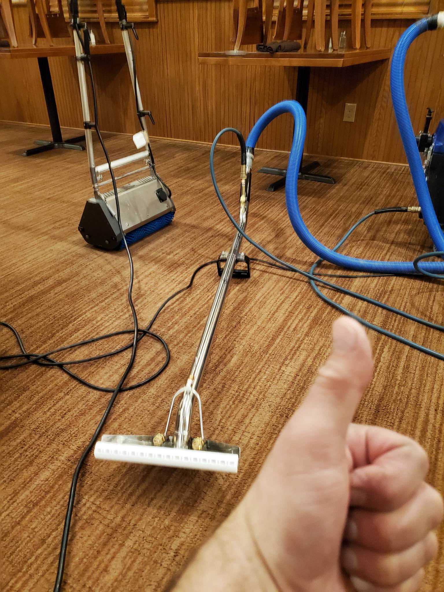

Im selling lots of modified AWs at $600.
They are easy to sell because I use and love mine.
Comfortable.
Durable.
4 flow, two jet impact is ideal for most of my light soil client base.
Can easily be changed to 6 or 8 flow for frog nasties.
Great for furnished homes.
Shocking dry times with 4 flow.
Cheap, like you.
