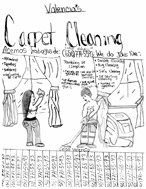

This is my YP ad they had there advertising dept. design it... Not the greatest for a "professional"!
Good time for this thread I have to meet with him monday.
I do three half pages and it costs $3,600 not bad thats why I keep doing it.
A
Able 1
That would get you alot of work in bawbs area! Then you have bobs prices too! Looks good though... like somthing I created on the back of my sprirl notebook in fifth grade odivously duing spelling class!
