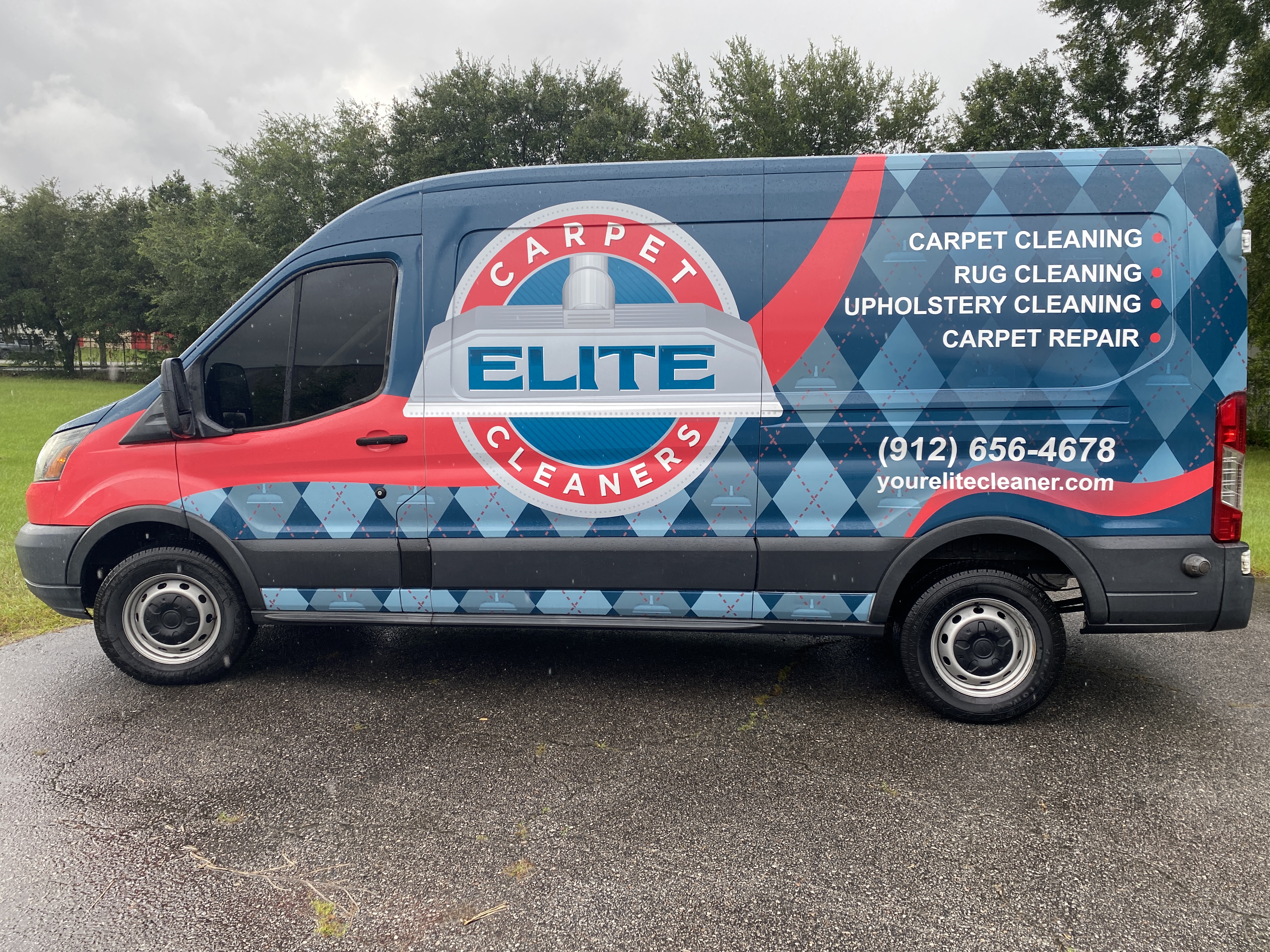

What happened to that fully wrapped Transit/EuroVan that he used to have?
The new company owner is running it.... Well, his employee is. He has a very hands off approach. Everytime I see the van, it has a new dent.
