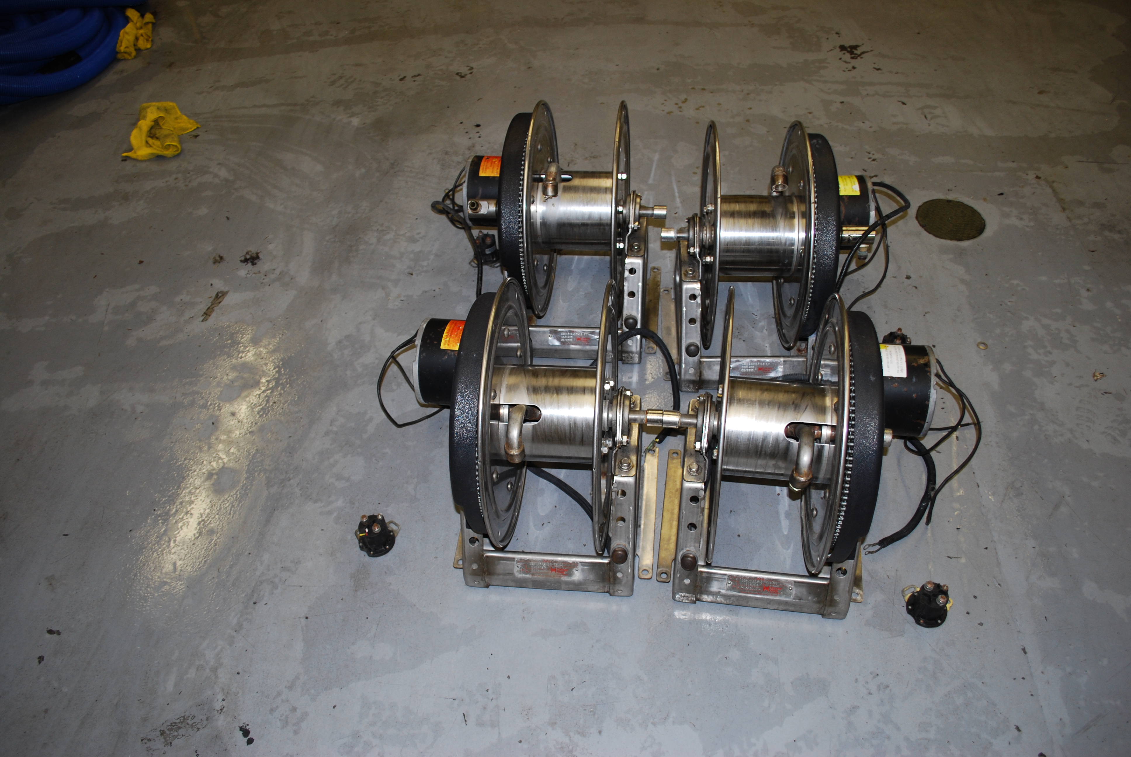

I'm sure it has been done before. But I thought I would post a bit about the process.
I had a couple manual vacuum hose reels that came with a truck I bought.
The conversion was relatively easy. That being said, if you have zero welding or fab experience this might be very hard for you.
We bought 2 DC motors $180 each, enough for two reels
1" channel-20' section
2" angle iron
6" x 1/4 plate about a foot
Misc bolts for attaching motor to bracket
Roughly 12' of link belt, about $60.00 per reel
1.5" 5/8 pulley $10.00
Instead of a big push button momentary switch, we went with a standard Ford starter solenoid. I love the Butler electric hose reel push button, so we bought some gooseneck flexible tube, and put a small push button on the end. I soldered the wires to the switch, but you can buy momentary switches with both wires already attached on Ebay

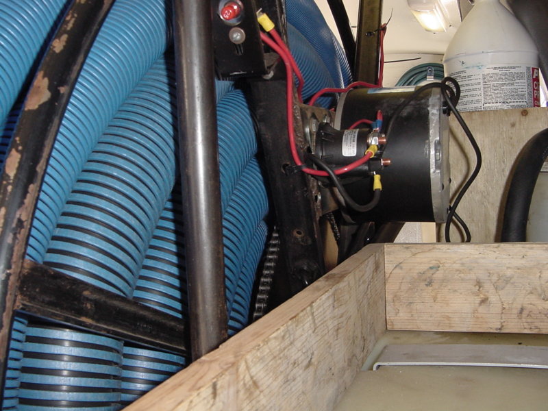

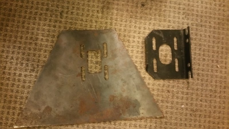

This was my take on what Keith did with the motor, sprokets & chain. It's a little hard to see but it is just 2 pieces of flat stock welded across the reel frame. 4 slightly elongated holes in the flat stock.

four slots and a larger hole for the motor shaft, we have 2 that are this way and 1 that is the way your is. We like the all welded bracket with slots to be much more rigid and not trouble free.
Justin's bracket is MUCH more solid than any other I've seen. I wanted to avoid any design that involved loosening the 4 motor bolts because of the billet they thread into. One big bolt locks it down after swiveling into place.

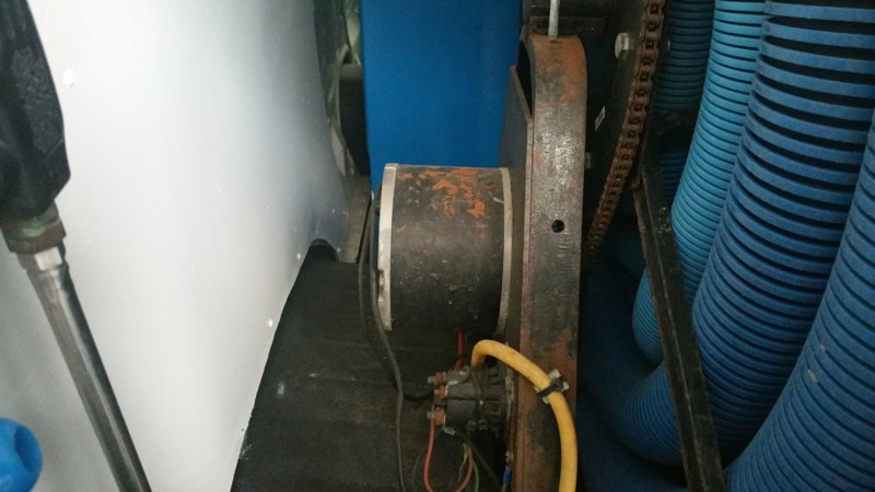

I have never touched those 4 bolts..
I don't like that the hoses will be dripping on the motor when it's raining or when dealing with snow..
Mine is all rusty, and it's higher and to the side..
Reactions: JS41035

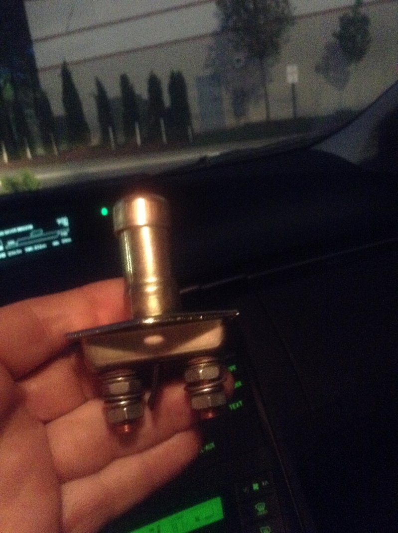

Can you show us a pic of how the solenoid is used as a switch?
J
JS41035
I'm out of town right now. But the solenoid allows me to use a much smaller momentary switch. The small button on the end of the flexible black gooseneck tubing simply (when pushed ) gives power to the left side of the solenoid. That closes the contacts and allows the heavy current from the battery to flow to the motor. The small switch could never handle the load that the motor needs. If you didn't use a solenoid relay, the push button would have to be much bigger (capable of handling the max load the motor might need). Lots of reels use those with no problems. I just had Butler envy.
The solenoid has two BIG terminals, facing left and right. Left to battery positive, right to Load (starter or motor). It also has 2 smaller terminals in the center. The one on the left is the trigger, the one on the right is a low current output you won't need.

Wire any small trigger switch with one wire on the same post as the battery lug on the far left, and the smaller trigger post left center.
DC motors can be reversed by reversing the motor leads. Test direction before installing, you won't need power out.
Chevy vans have a spare 50amp auxiliary connection I'll use. Make SURE you have a similar fuse.
Tape and insulate well.
