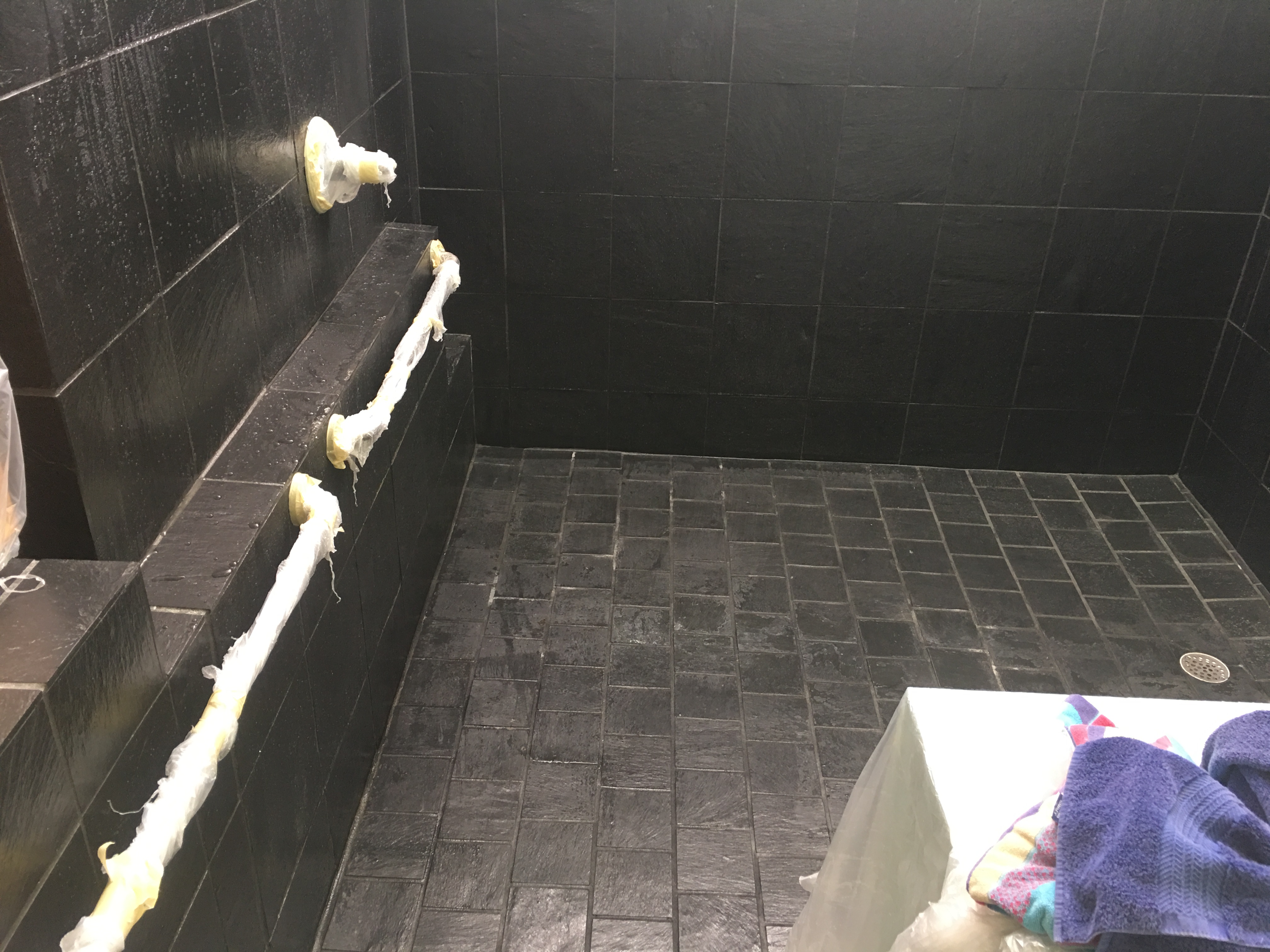

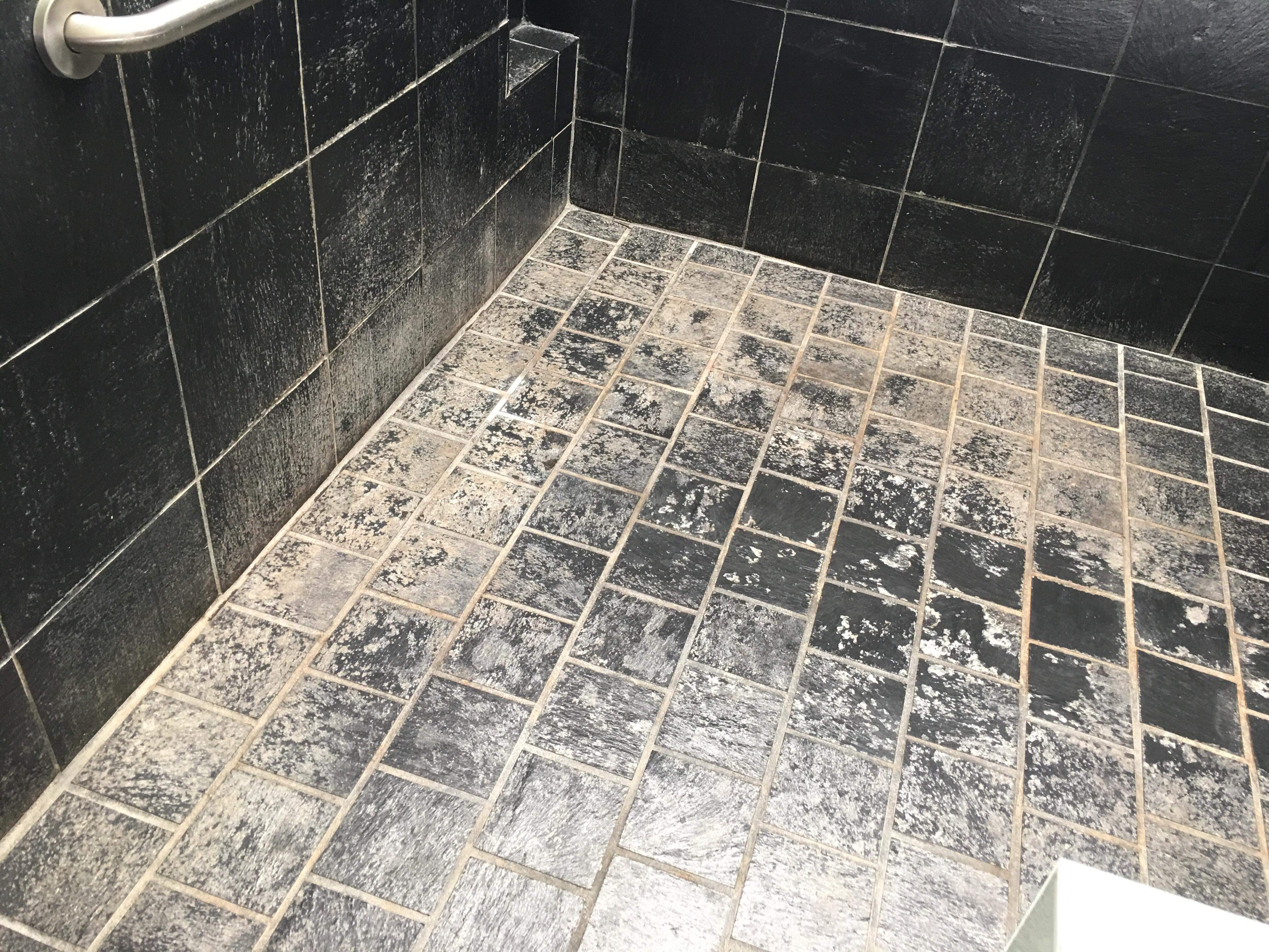

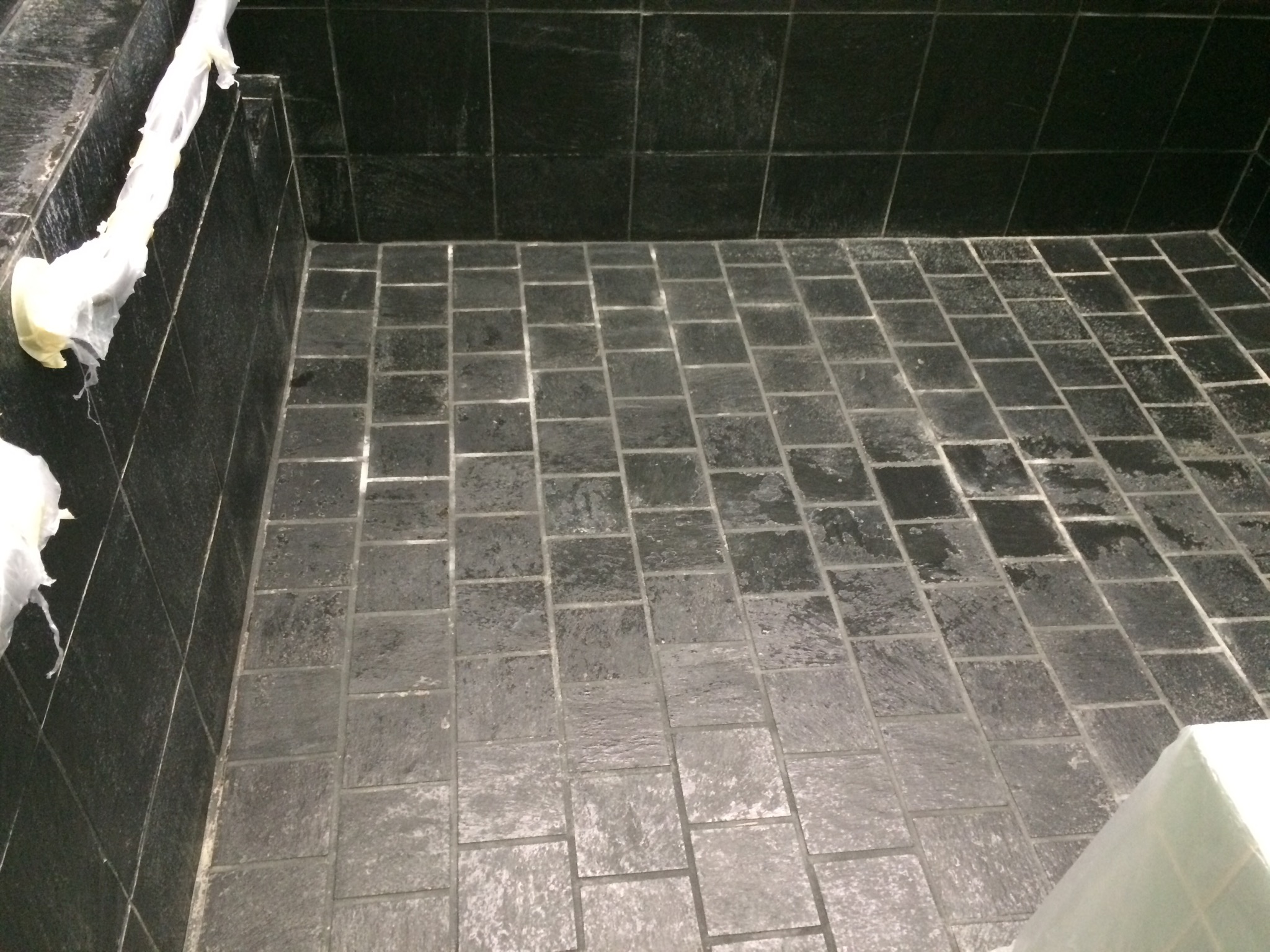

I started with 12ph tile spray/floor stripper, scrubbed, rinsed, another 12ph, scrubbed, rinsed, prochem acid, scrubbed , rinsed, acid again scrubbed rinse, back to alkaline scrubbed and rinse and it came out like this. As it’s drying it looks more and more like crap. I almost wanted to get some oil based black paint and roll it all over this crap
14,627
I’ll get another pic of it completely dry this afternoon.
Would a coating of enhancer help keep it looking black?
117,250
Enhancers are not coatings... it'll look good for about two showers and will go down the drain and they'll never know you did it

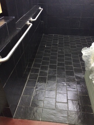

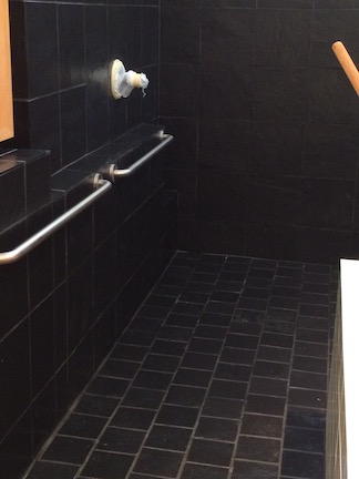

Update. This is after the impregnator sealer that they used on it. The last pic was just after the enhancer
