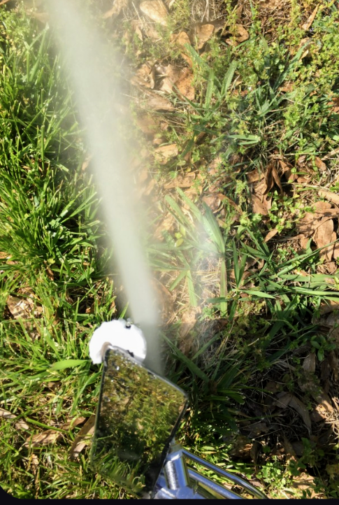

On another note concerning Matt's wand, the triangle shape, with its hidden/ surrounded jets is extremely handy for getting underneath all sorts of furniture and obstacles.
The old Bently almost pulled it off, but the jets were too far back, and soaked things.
117,270

Banana would imply that I sent him a curved glide..
Ive sold hundreds of the same design for the 12" & 14" WPs with no fruit factors....

I fixed it last night. I put the matter in my own hands, discovered the outside internal slots were too far out to the edge (keep in mind, this head is only 11.5"), which caused the curve when you pushed it in to fit it. So I cut those out and it now sits perfectly aligned with the lips straight, not curved.
So since this was your old design that you didn't make Mike, it might be good to take a look at one you have and experiment with it and see how much better it fits with those two outside inserts cut out. But what do I know? I've got work to do.

I have the SAME Glide on my 530 Matt.
Its fine.
Leaks are a good thing.
But taking away the walls between the bridges solves a problem that you're not noticing, yet.
Ive sold six of those in the last two weeks with no complaints.
Portable guys obsess on this stuff. Which they should.
You have air to spare on the other hand.

ok.
Go back and look at the picture which showed the curve.
The curve was created by you inserting it UNEVENLY.
done it myself many times on other wands.
Take it out and do it again, evenly.
But you probably gooped it before you noticed, right?

I put the glide on, the same way Trip did in his video on his thread. This isn't rocket science.
Concerning the generous discount you volunteered to me on that wand which I thanked you for, I thought you were looking for feedback in return, which is why I took the time and sent the detailed, accurate pictures and positive feedback with the other concerns, which you were not at all willing to accept.
Leaking is not good on a glide. You need all the suction coming from the slots for maximum water recovery, unless you're cleaning a hard surface (the purpose of the brushes on your hard surface glide) to prevent real lockdown.
I've used both methods and no air leak is better.
Trip is using a SSTI14, which a baby could plug a glide into. Incomparable
You're wrong. Leaks assist lift.
