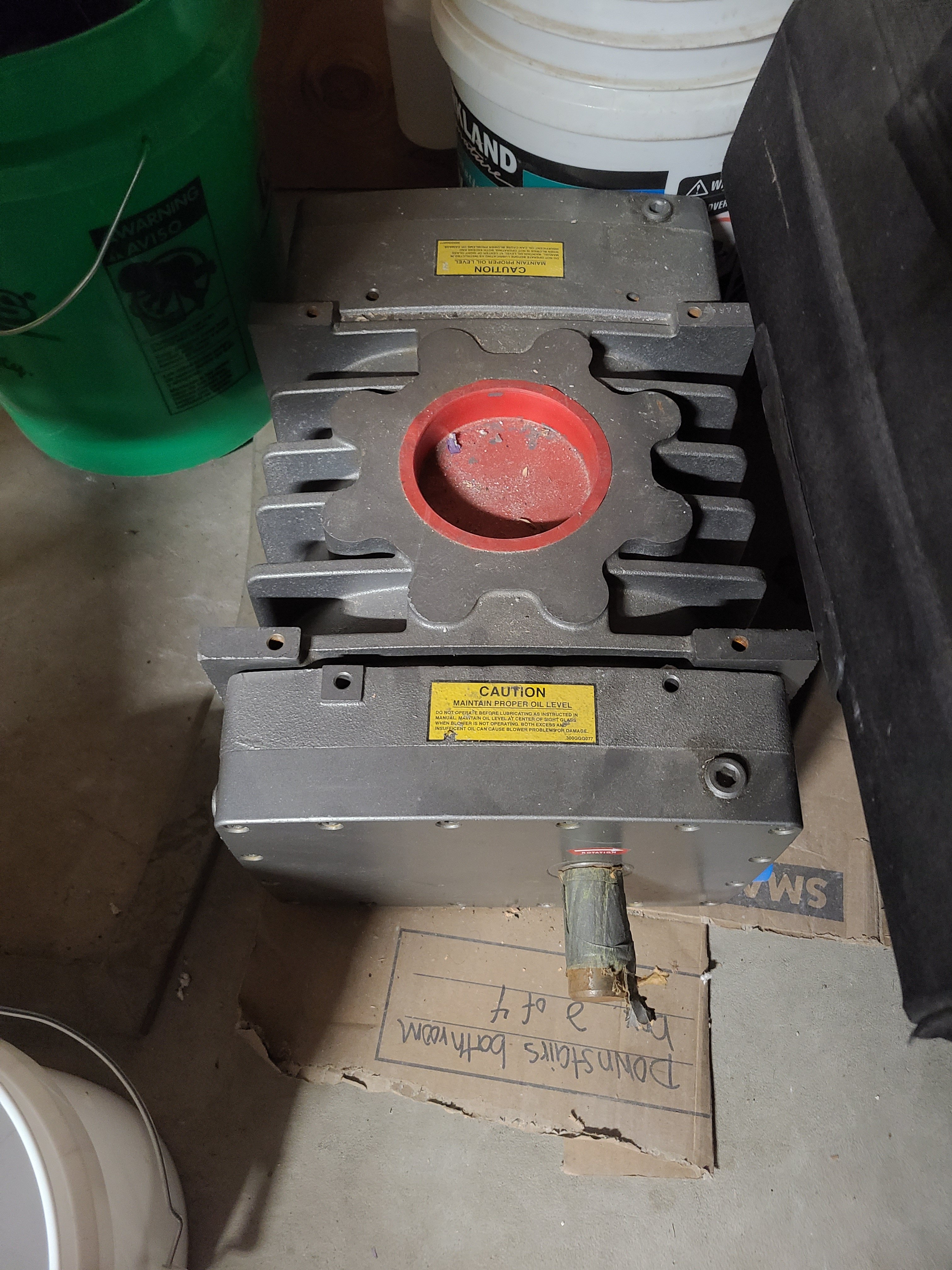

One we have been robing parts from but I have a new 40 hp Kohler and a 410 blower that I want to put on it so we can duel wand and put it in a big box truck with 500 gal fresh and waste tank we do some large commercial pre virus .

Might be a fun project. How are you going to quiet it down?

It will take the right size silencer for that blower. The problem is finding room to put it. Mufflers will not cut it.

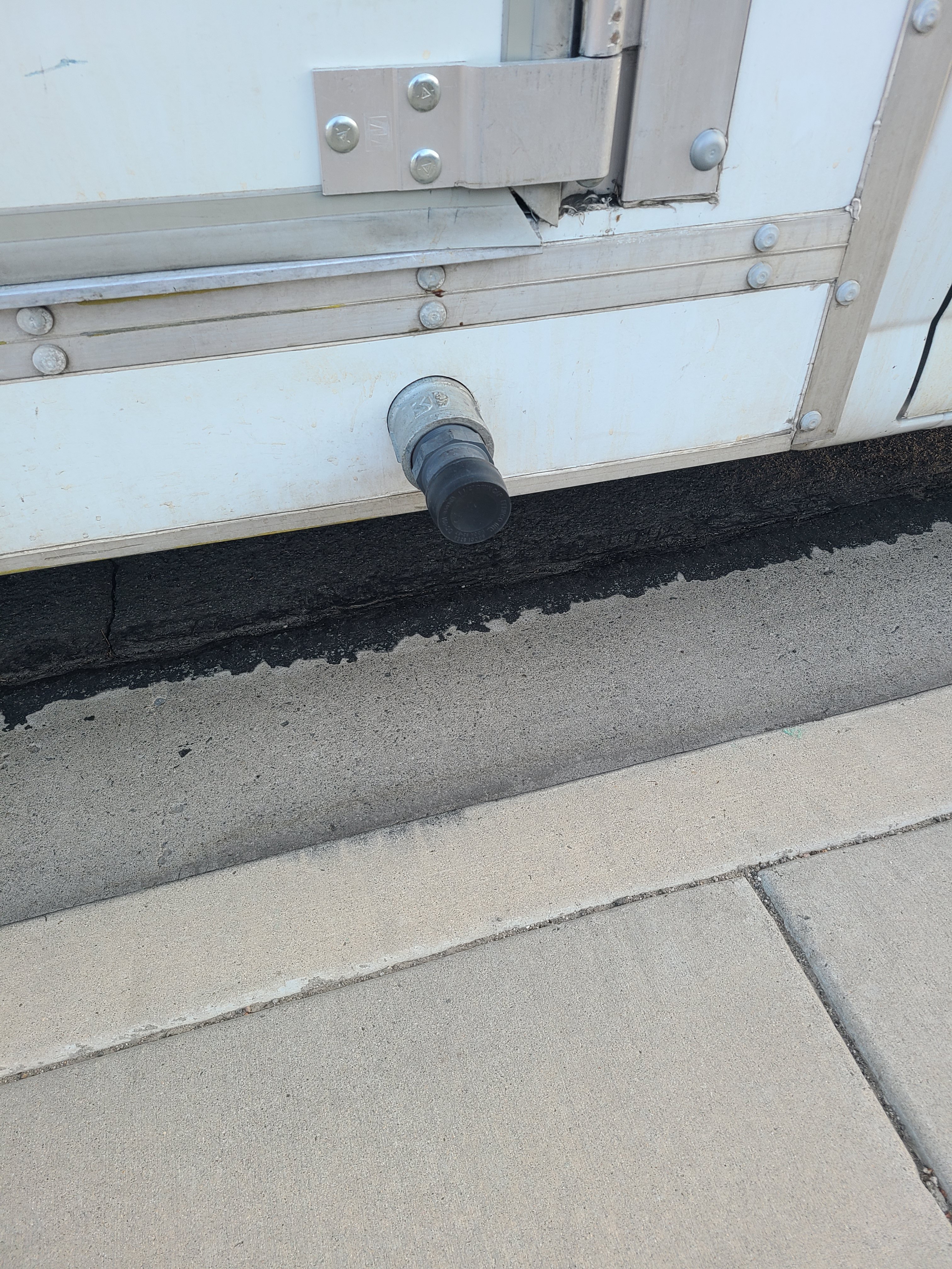

I am thinking Bout mounting stuff under the van .on my current box truck I have my dump line ran through the floor and mounted to the bottom so I don't get spillage in my truck supper nice to have will post pic in a sec .I am open to what it takes to do it right i will look into it for sure .
