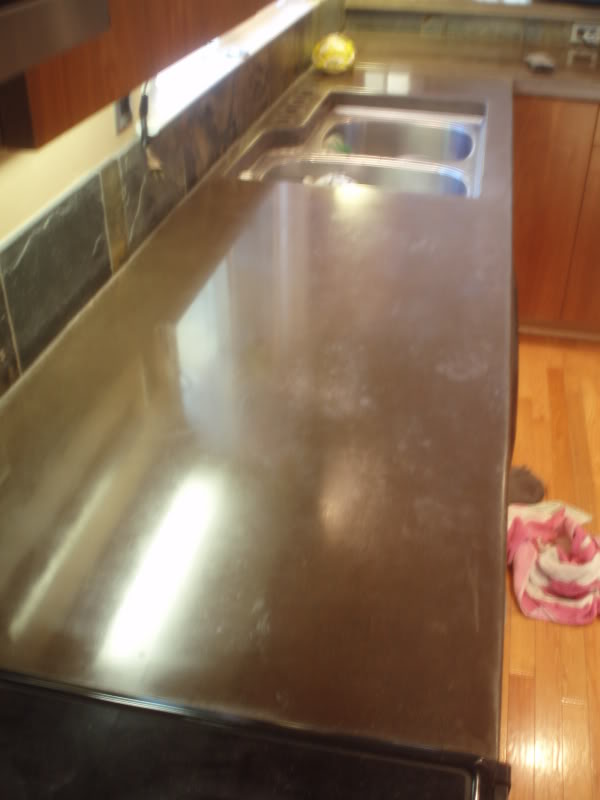

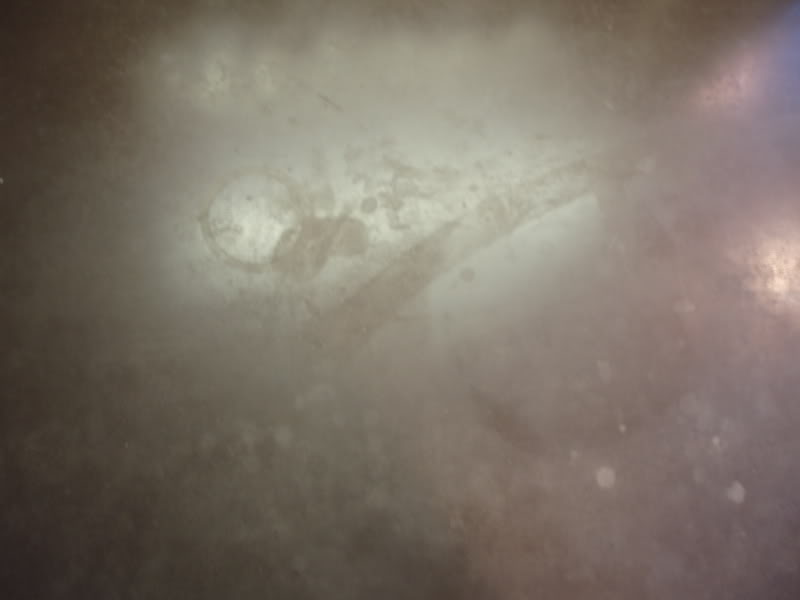

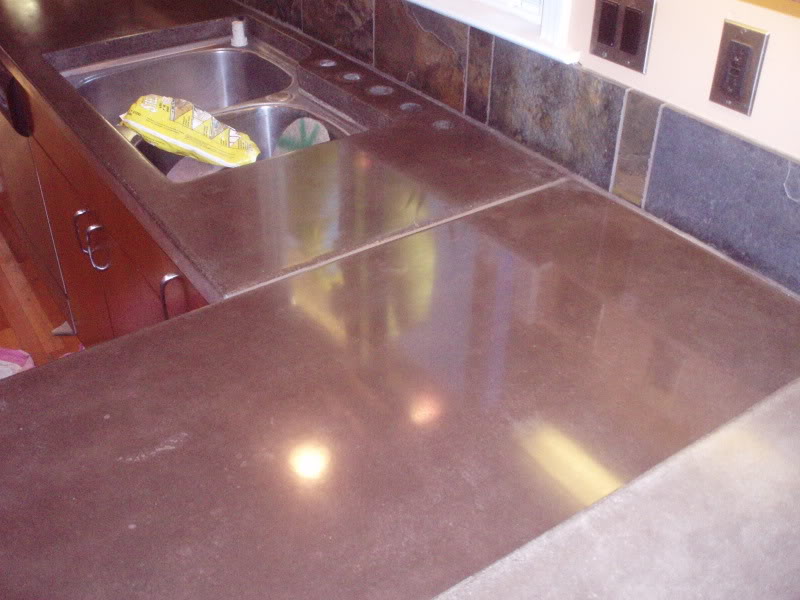

Before (five years old, only penetrative sealers, lots of deep etching but no stains.)

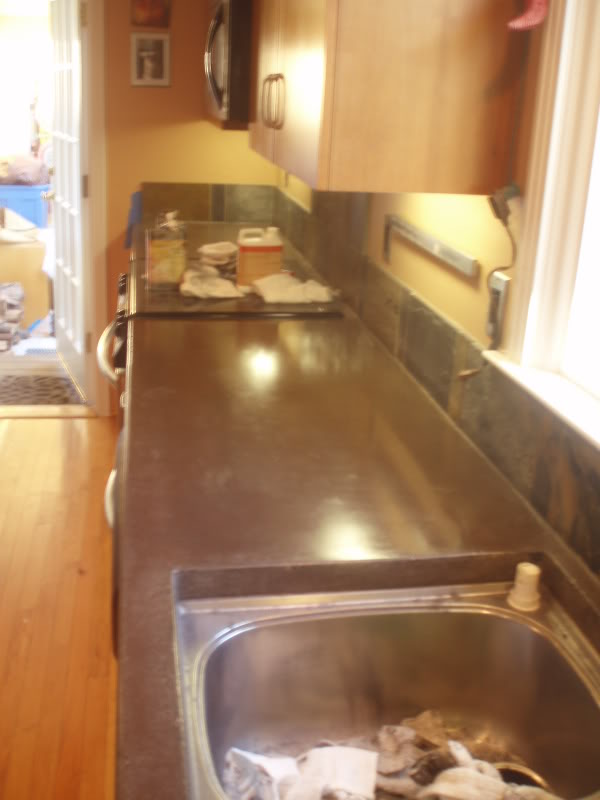

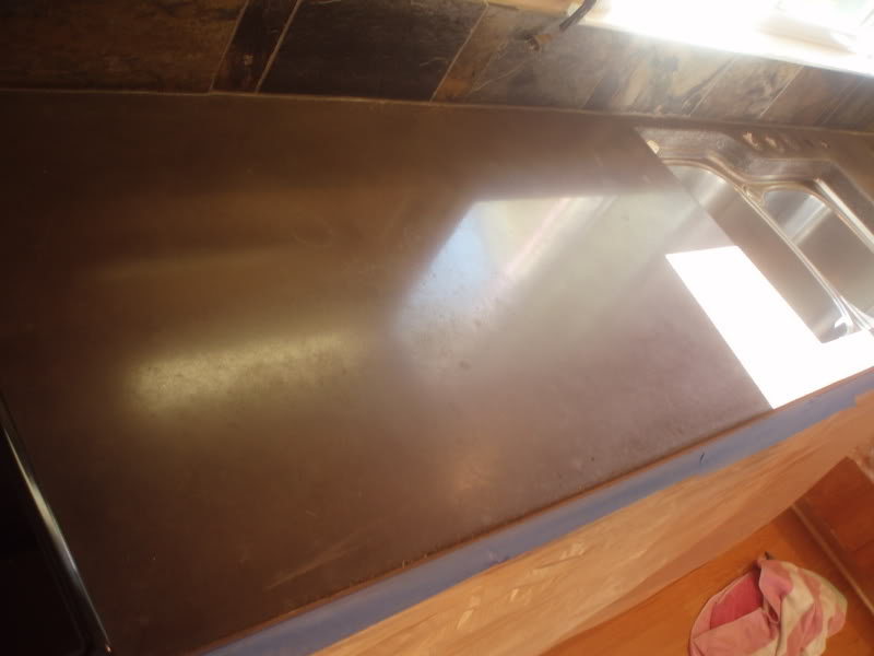

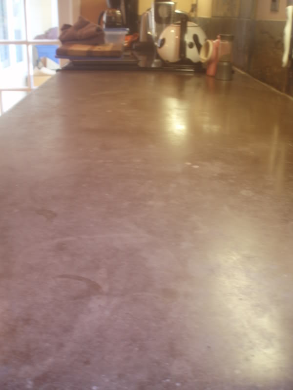

After a round of Monkey Pads (400 -11,000) Didn't get all the etching but looks way better.

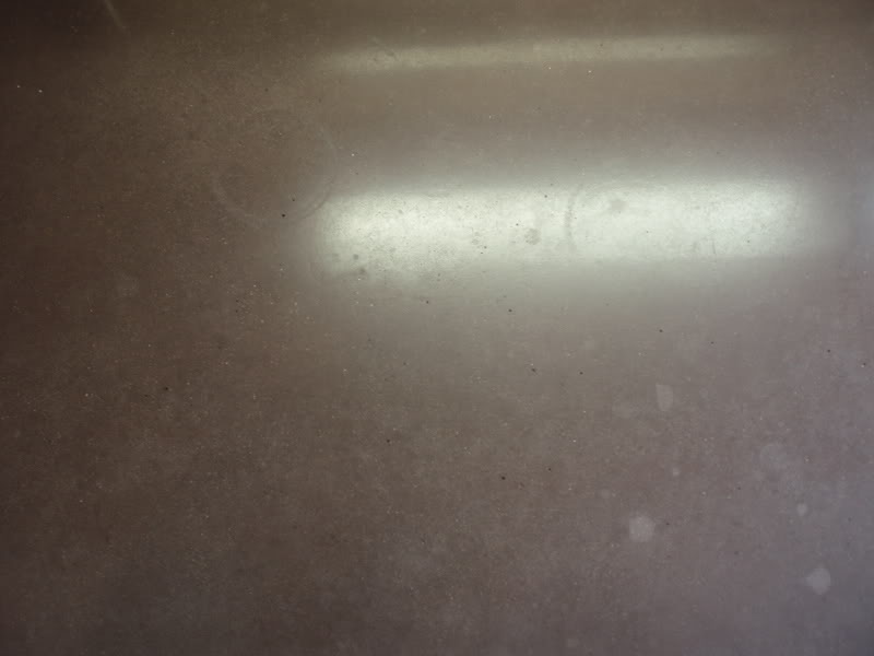

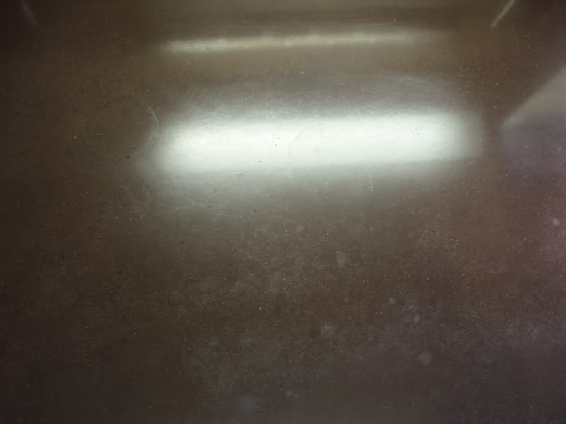

After Enhancing and Monkey Waxing.

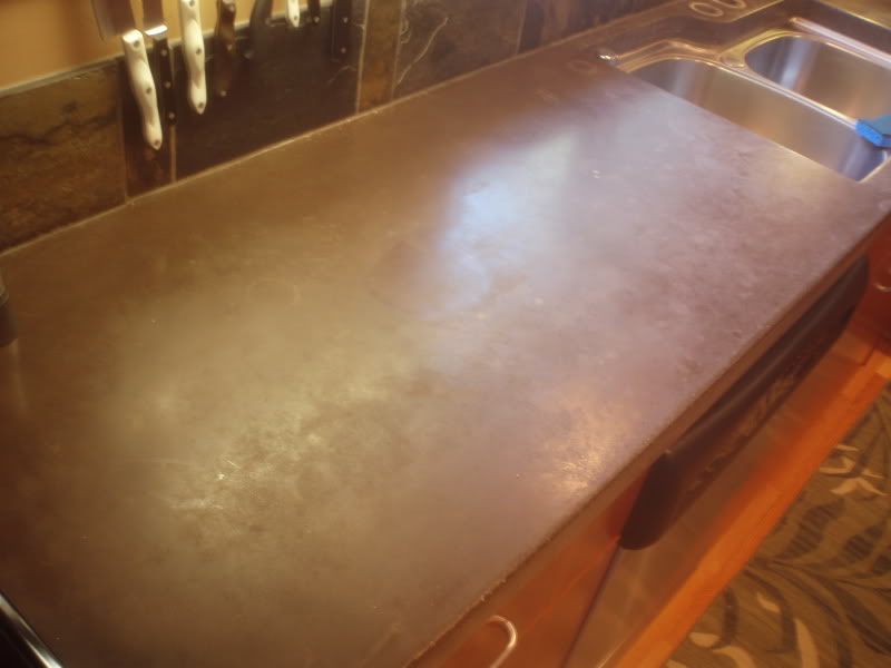

After Padding and Enhancing but before Waxing
After Waxing..
I'm hoping the Concrete specific pads dig a little deeper.
Have to be careful not to go too deep or you'll expose aggregate.
Etching is a fact with Concrete counters.
Got to learn to embrace the wine glass rings.

seriously looks good....shoulda got some diamonds and used a orbital on it, then you could have gotten the rings...
and a 11k shoulda made it pop more then that...

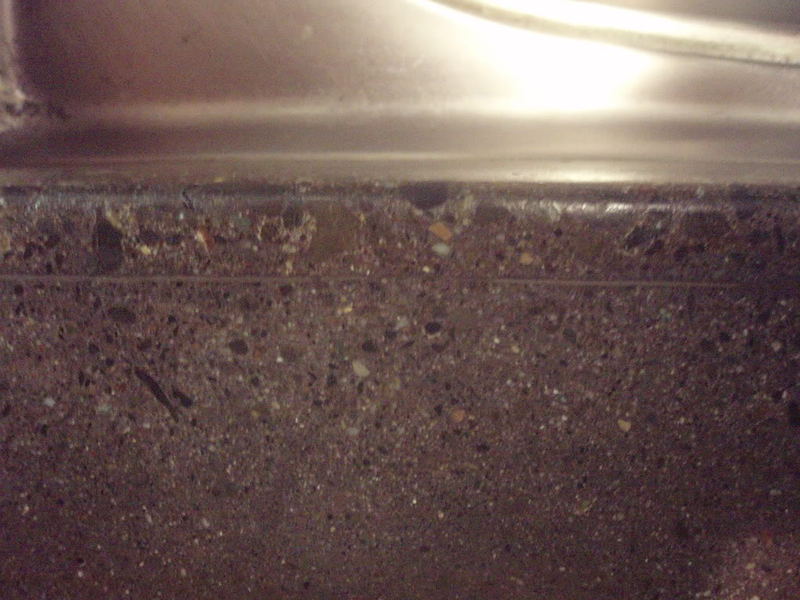

I didn’t know you also had concrete counters, very nice. I actually like were that aggregate is exposed. Take a look at my counters below. These pics are after installation, they’re about 7 years old now and really hurt’n to be re-polished. I went mostly with Chengs add mixes and water reducers. Everything every body was doing at the time was either with a bullnose or square edge and I wanted something a little more radical.
Take a look and let me know what you think.
