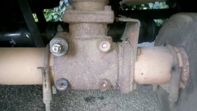

My diverter valve is TOAST
117,333
unless some one has a spare they are willing to part with I'll be plunking down big bucks on Monday for a new one.

Why not rip all that crap out and buy a Little Giant. Your blower will love you for it.
Man that looks like it went through many a Kansas winter with all the road salt they use here.
I didn't know you got corrosion like that out there. Sea salt?
117,333
Thats the weird thing
Cars out here dont suffer from corrosion like they do where they salt the roads or the ocean blows inland
That is weird. Sure looks like winter salt damage.
Nobody has a parts truck?

Diverter valves get put in the wrong place anyway. Put a stainless Tee in place of that one and then put a "Jake brake" type flap on the back end of the HX exhaust.
Hot exhaust gasses will take the path of least resistance.

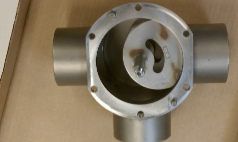

I just ordered mine last week. got the same truck and same old cast iron valve. I messed with it, cleaned it added grease fittings the whole deal still had probs. The new valve is stainless and is designed to work under a twice the heat that that one is. I look forward to installing mine. if your pod is ok your looking at about $700 or so. well worth it imo since no one else on this earth makes one exept areo. the will have to custom retro fit one with welded flanges to work on your truck. they did mine in a few days. Like i said well worth it.

i would have posted some picks but i got mine in about 3hrs ago and its already installed. Mike mine had two flanges welded to it so it bolted right in. looks like yours will need some cutting or welding. also i hope yours came with all the arm and linkage box etc... i dont think the old stuff will work on the new valave. i will see how it all works this week i got about 35k sq. ft to clean in the next couple days and dont want to be messing with no stinking (sticky) valve lol.

aerotech is hooking me up with everything I'll need.
I found the source of the moisture that caused this corrosion today so all is good.
