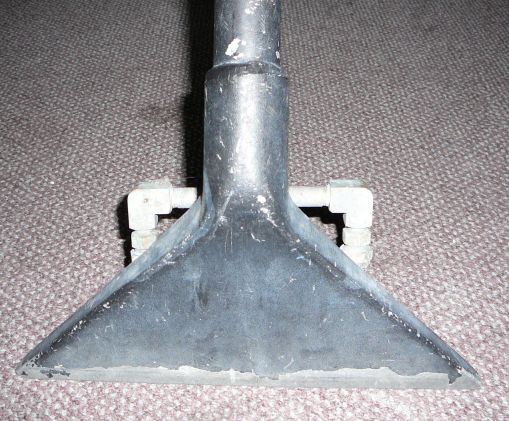

Larry Cobb
5,795
Larry Cobb
Jimmy;
Here you go:
It's a year old. Angle too sharp @ the edges for good airflow.
Where do you want to start the bidding at ???
Center Jet fixed, pretty much straight down.
At least our stainless wands don't have all the paint falling off.
Larry
15,253
What a poorly maintained wand obviously used by some HACK employee or doofus CC er down in TEXass.
I don't see any stainless steel glides on there Larry!

I wouldn't use that wand in a home. Scrap aluminum maybe.

Larry Cobb
5,795
Larry Cobb
Jimmy;
They must have fallen off (slip on design).
We weld them on the stainless wands.
