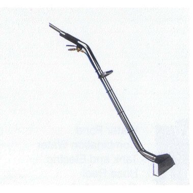

The short of the story is we are running 2 crews and they currently use the 16" evolution wands which I am not a fan of. I need to upgrade the wands to something better. Is the 14" Devastator the go wand right now or would you get something different for employee use? I have it narrowed down from all the reading I have done on here to the following 4 wands. 14" Devastoator, 14' TMF, 14" Sapphire SS and yes the 14" Joe Bristor wand. Any help would be great and remember these will be used by employees. Thanks.

The Sapphire and 12s and 14 are pretty much indestructible without any headlights vibrating brushes swivels windows soil and moisture detectors and orthopedic grips and if they don't know any better go that route or the Prochem titanium.
My chimps beat the shit out of our swivel wands and it drives me nuts
I am really looking for the best cleaning and something durable. How's the cleaning performance on the sapphire 14" SS wand and I assume you sell the best slot glide for it?
117,351
Both sapphire wands clean 99% as well as the devastators they're just missing them two nifty features..
The stock glide that comes with them is made by PMF and is good enough to wear out then try one of ours which will make them a little easier to push
