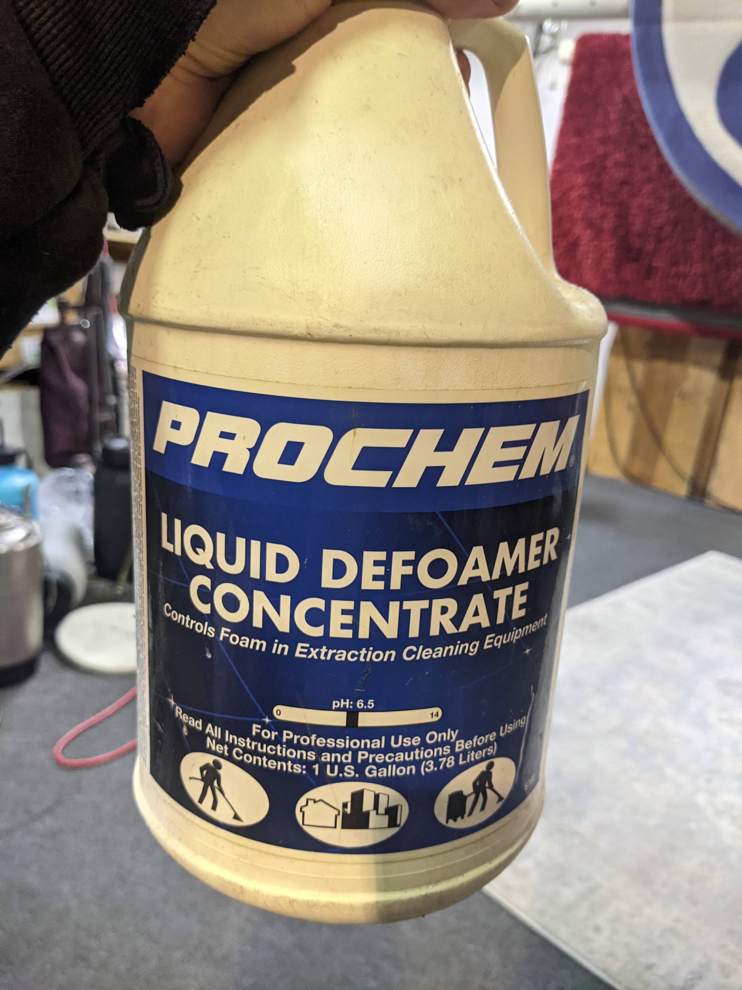

For severe foaming, do what Jim suggested with the sponge but also spray through your vac hose with a liquid defoamer. You may have to do it often with something as severe as that. I've done similar when a customer dropped a bottle of laundry detergent. Get some in your waste tank before you start and keep spraying through vac hose periodically. A spray works better than a squeeze bottle. Do not put the defoamer on the carpet.
Reactions: Jim Pemberton
27,863
This products works well. Pay attention to the instructions.
