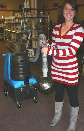

Just finished some testing on our new Hi-Lift Breeze Extractor.
It has a ported vac manifold with new two Hi-AirWatt 3-Stage Vacs.
. . . Breeze Extractor Sealed suction is 237" (>17" hg)
Sabrina . . . is our Front Office Manager.
The bowling ball is 14 lbs.
Larry

Larry we did that in science class in 7Th grade with a shop vac and funnel

Very impressive, Larry. Mytee New Machine will actually suck up the bowling ball. lol

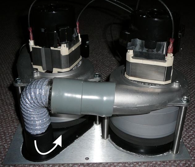

Here is a photo of the vac system:
The arrow denotes one area of porting we performed on this module.
Larry

If you get a chance, add an air hog and 100 ft 2 inch and pick that bowling ball with a popsicle stick breaking the suction laid flat under one side of the cuff. You might have to add a second air hog to do it, and even with 4 3 stages it may not pick 14 lbs. If you can pick that ball at a 100 ft with broken suction, you've got a hell of a strong setup.

Larry,
Why are using the 148" instead of the 154"?

Larry Cobb
John LaBarbera said:
Larry,
John;
So that the vacs can operate in series, on a 15 amp circuit,
with the 2.8amp pump motor.
We are also testing another vac motor.
The 17" hg does test your recovery tank strength.
Larry
P.S. The 154" is what we use in the AirHog 8)

Larry, the hose and cuff look a little cobbled up.
How about a nice 90 with some rubber connector boots or something?
are the sides of the blue rotomolded tank collapsing or is that just the shape

Kevin;
The important flow parameter is the hose and connector going over the vac motor outlet and manifold inlet.

The only tank under vacuum, is the grey round recovery tank.
Larry
