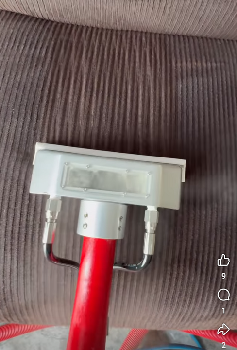

New upholstery tool devlopment is coming along..
115,878
I have additional ideas for the Glide, once I've determined the final design, it'll be sent to the tool fabricator for them to make the titanium head around it.

What tool do you consider good for contuouring?
A single narrow slot tool I can partially block off while cleaning tight corners, piping, etc.
Also a open spray for misting panels if necessary but I always did 95% of my upholstery with a portable.
It also depends on whether you are designing a TM tool or a portable tool.
Some features are good for one but not the other and you will never satisfy everyone with one tool.
I'm still partial to a stainless open jet tool Jim Pemberton sold me probably near 40 years ago but have 5-6 different tools depending on the need.
This tool has both of those features, AND the ability to take off the gliide in seconds if needed, which other than cleaning eges of steps and wanting to avoide tackless damage, I can't think of why anyone would want to.

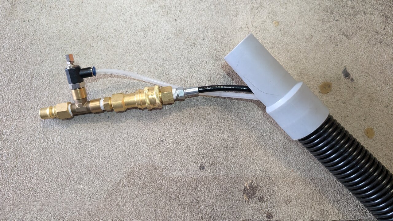

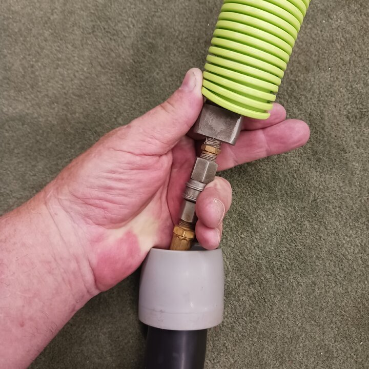

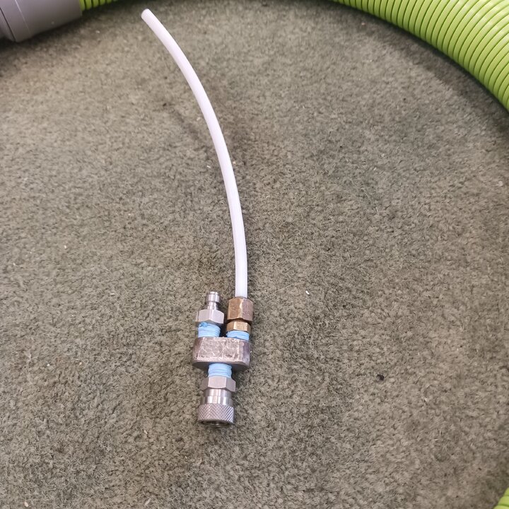

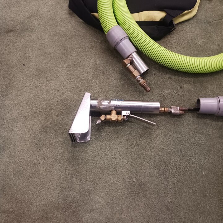

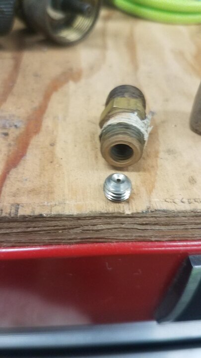

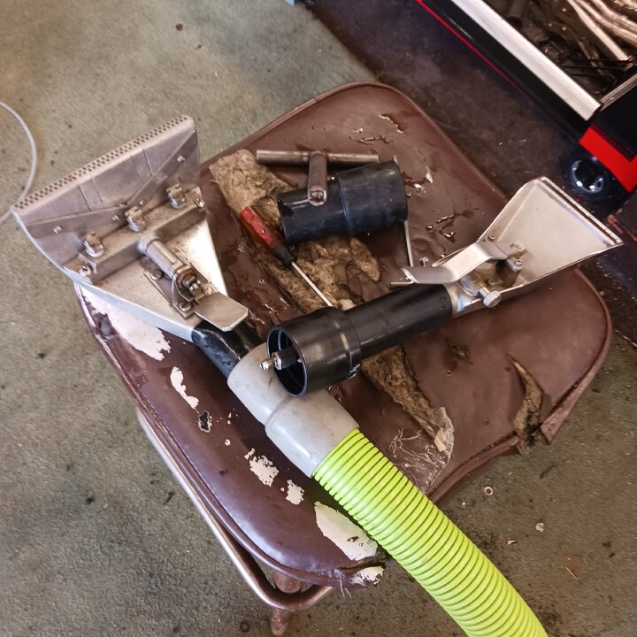

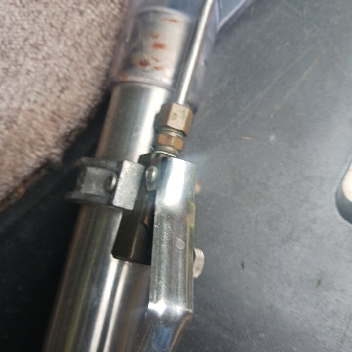

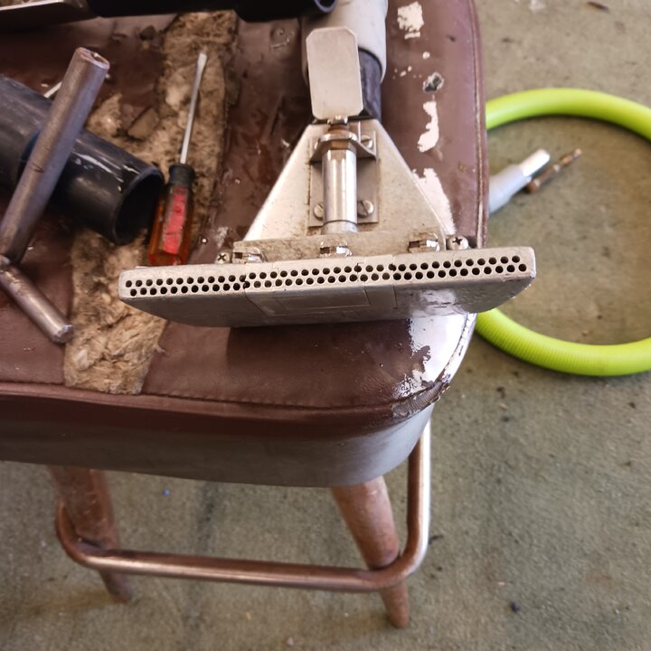

That bypass appears to be where the hose connects and youll have significant heat loss when you stop squirting solution for any length of time. Where as if you put a continuous bypass closer to the head your solution will stay hotter on a standard older prochem tool and a newer sapphire scientific tool i use a piece that i fabed up from kleanrite solvent attachment parts a small 2×1/8by 1-1/8 stainless manifold block 1- 1/8 mpt×1/8 fqc 1-1/8 mpt× 1/8 mqc and a kleanrite 1/8 mpt ×1/4 compression fitting internally threded for small bypass orifice to bypass at the attachment instead of the end of the hose works best added benefit is it is easily removed if necessary the bypass cost about 30.00 to build with off the shelf parts and can be made to work with any tool with internal solution hose so if you set the tool down to prespray or get useing vacuum for any length of time you dont have to heat up 10 or so feet of internal solution hose just squeeze the trigger and have nearly instant full heat! Better yet if you could find and use a valve that squirts when you squeeze it and bypasses when you let off the trigger. I assumed that was how the prochem tool worked with its little valve on the side but sadly not true . It bypasses but only when you squeeze the trigger

Going to be a hard sell telling people they have to take their cuff and hose apart to get to the bypass which in your case doesn't even have an adjustment so you're going to be filling up your tank Non-Stop

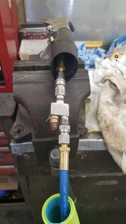

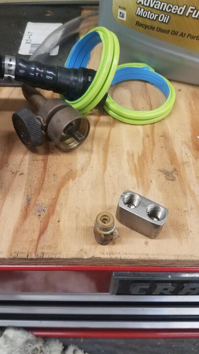

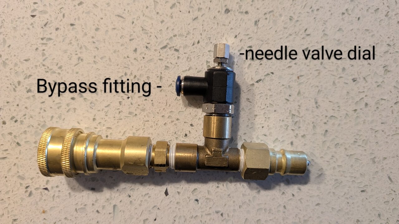

I understand, for me , i pump so the amount of soulition going into the wastetank isn't an issue as far as removing the bypass ive only done that once. That was because i had to use my own water supply (waterpond) to do a large sectional. How about a valve like this one, this attachment was my inspiration to build bypasses for all my internal hosed attachments. It bypasses continously at the valve has a needle valve to adjust flow of the bypassed solution and can be turned completely off. As a mater of fact i thought that the prochem tool did the same by looking at it in the catalog and was really disappointed that it didn't. This is not my go to tool i use it mostly for rv and automotive interiors. But I do love how it keeps solution hot!

Where do you find upholstery so grungy that you need 200+ to clean it?
I use pto's so i really don't have super heat i get around 200° at the truck when doing upholstery (frankinstien does have a hydramaster salsa unit installed) before when attachments had external supply hoses it wasn't that big a deal but now with 10+ feet of internal solution hose it doesn't take but a minute for the solution to cool and can take awhile to get the temp. up again . I don't care what anyone else says i prefer a consistent temperature and hot water cleans better than tempid or cold. Ive used the same attachments with near head bypass and end of hose bypass and no bypass. For me closer to the head is best. I actually use a modified (tee'd off for external m&f quick connects) dust downer at at the end of my stair tool when i have 200+ feet of hose on the ground to keep the solution hot there too
