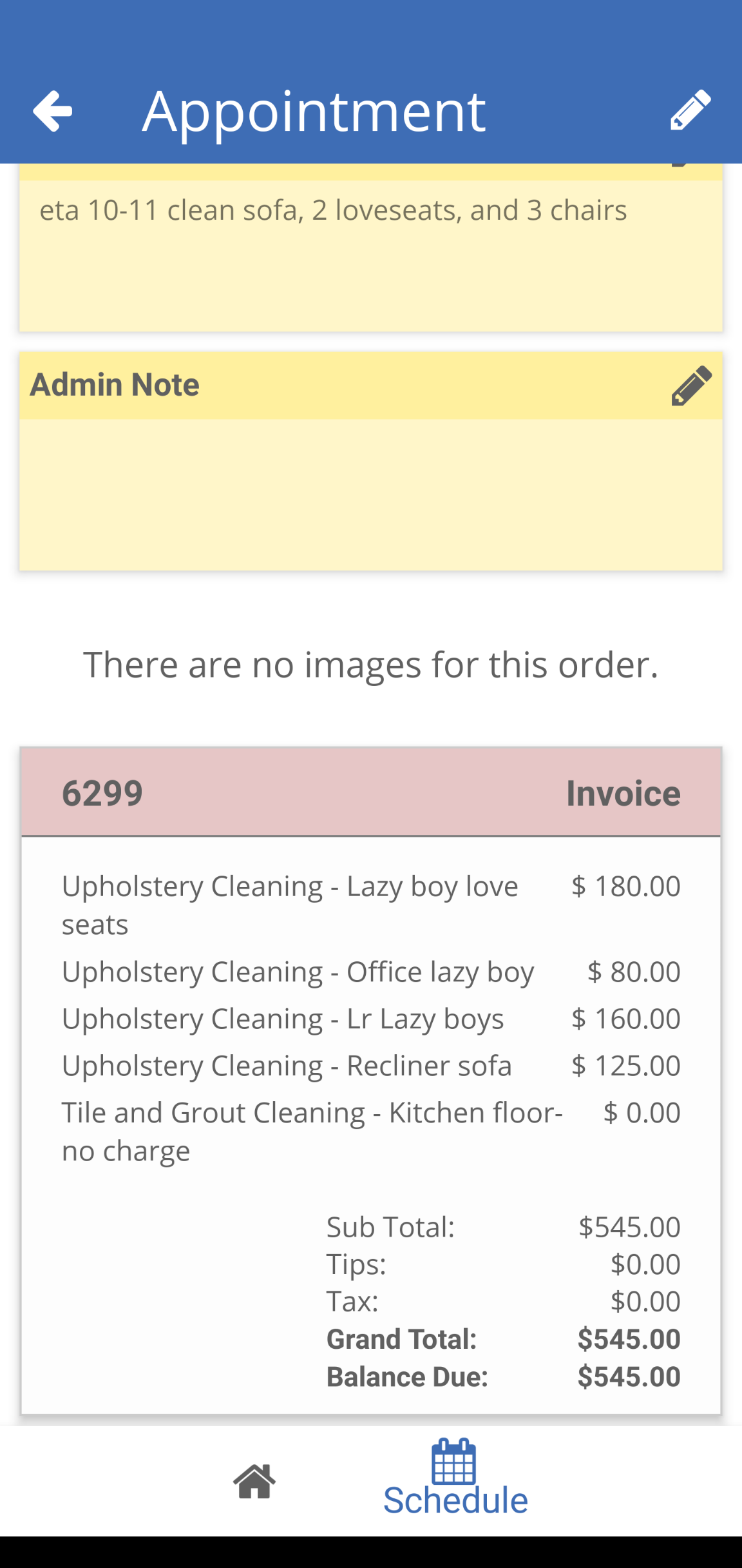

Today I went out to clean some furniture, screenshot below..

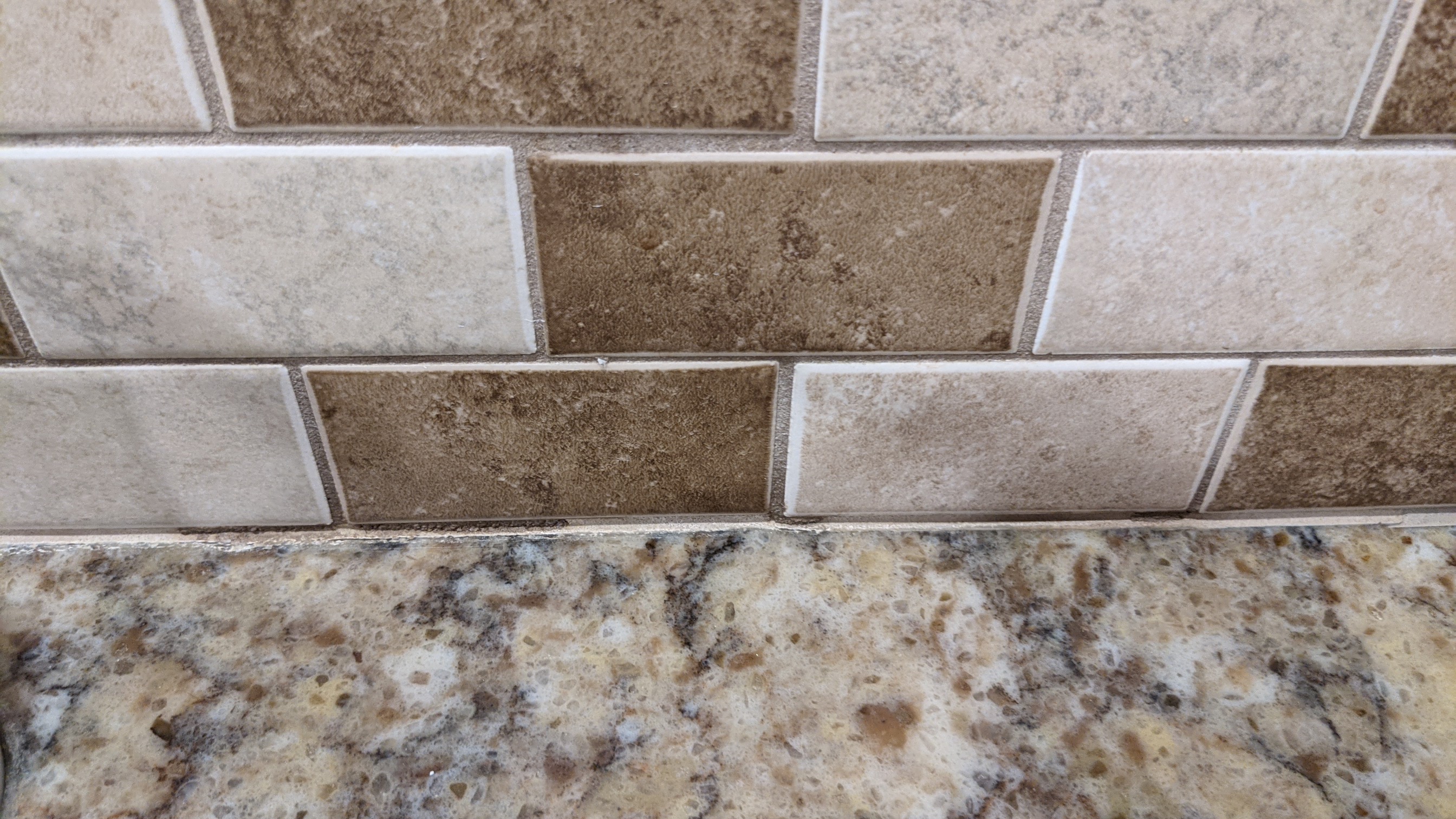

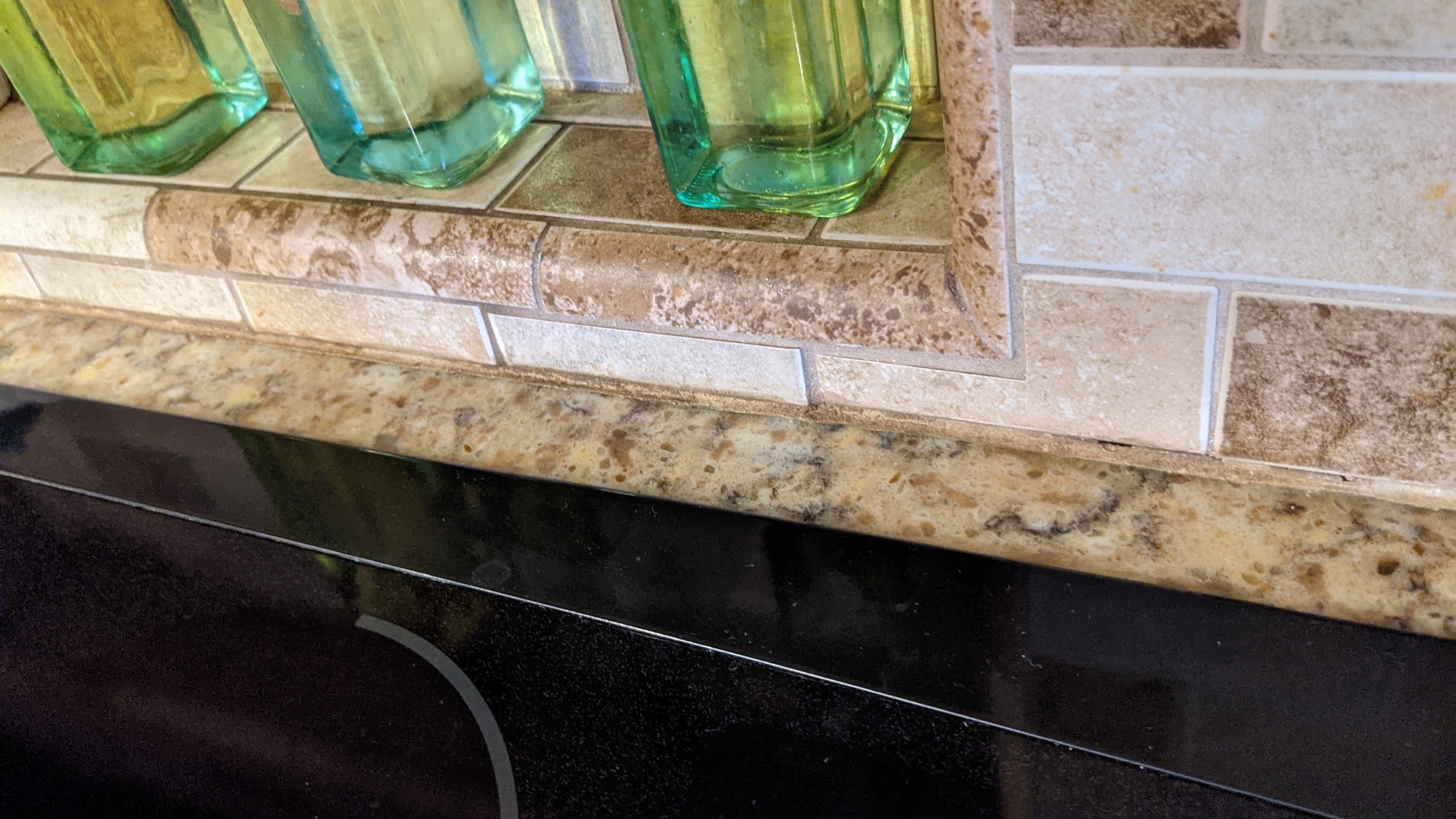

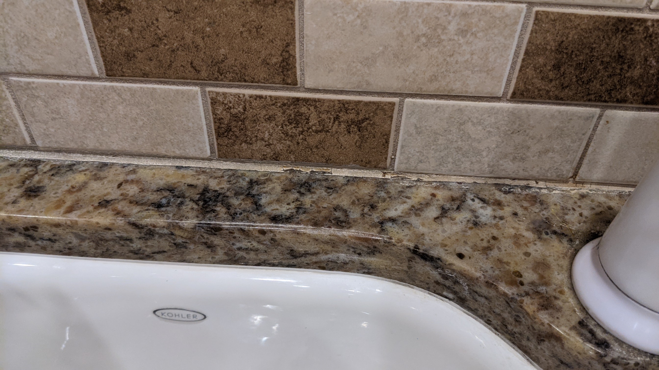

Halfway through she said "are you still interesting and redoing our caulking on our kitchen counters that you mentioned the last time?"
See pictures below..

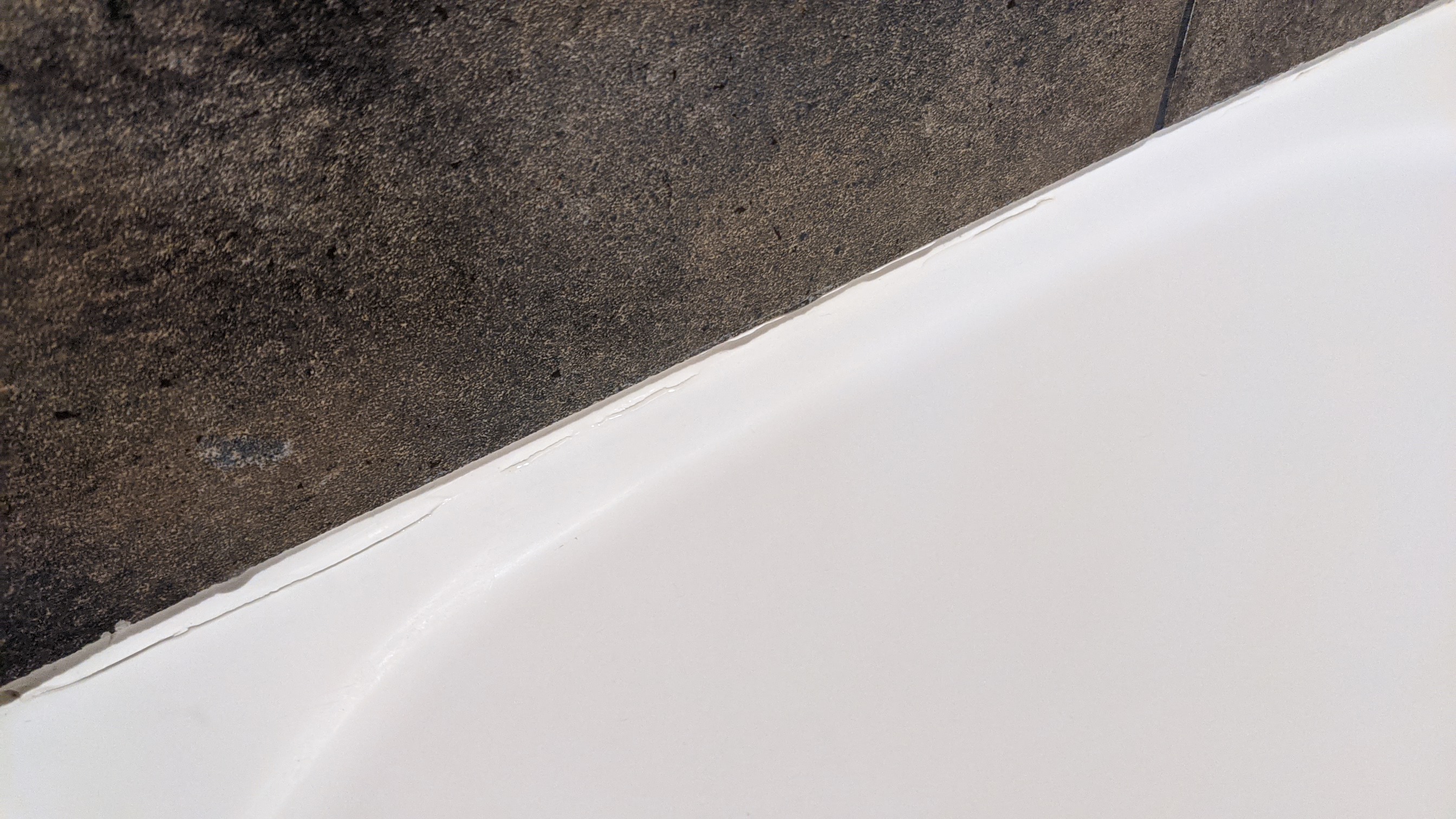

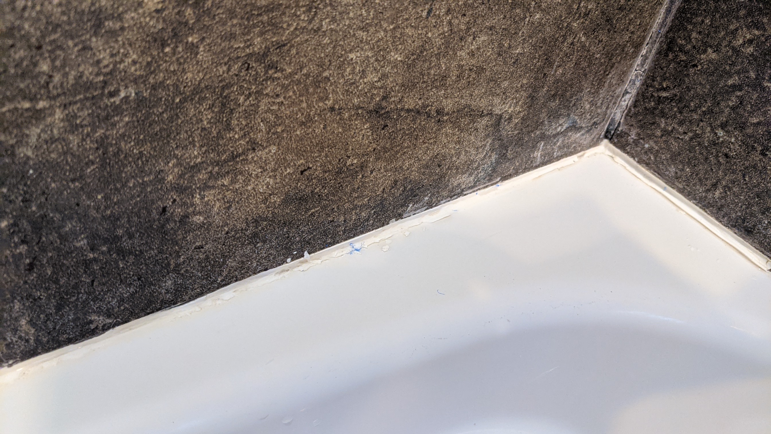

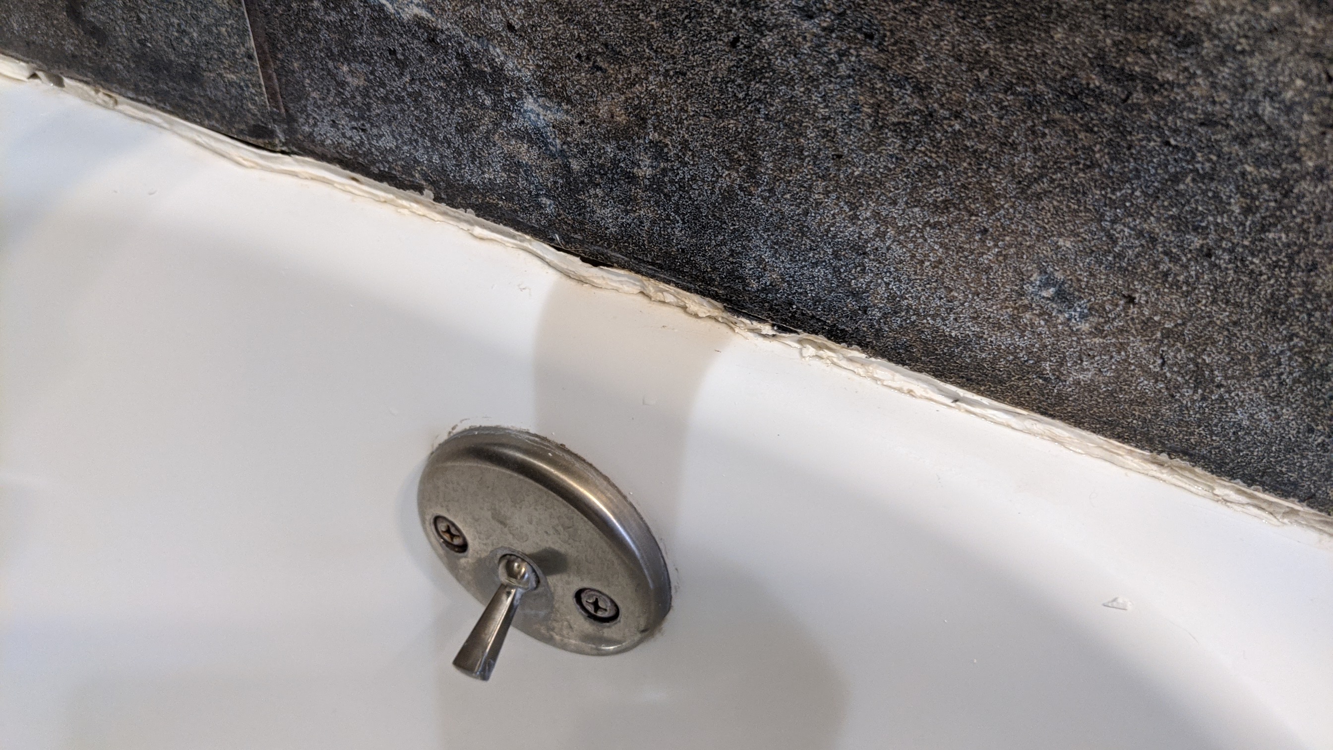

See picture below..
Turns out the original caulking which was color matched to the walls lasted about 2 years and then the flimsy fiberglass bathtub they chose and it's inherent flex caused that product to fail so she took it upon herself to put some dap siliconized caulking in, which failed within 2 weeks...

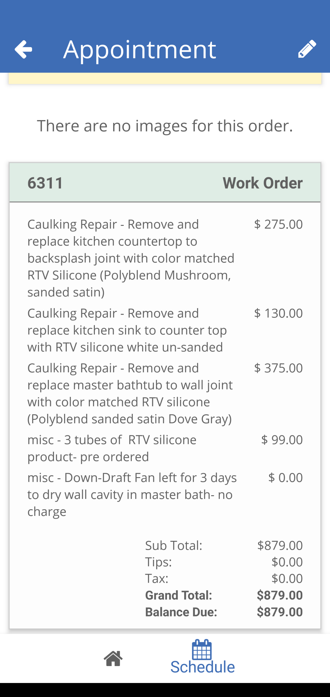

Once I told them about how I go about it with removal sanitizing 3 days of drying and filling the bathtub up with water before I install the RTV product she then agreed to go for that too..
Nice little up sale for a home with no carpeting installed.
As you can see on today's invoice I cleaned her kitchen tile today for free so I could test my brush glide and what do you know, I got a $50 tip...
