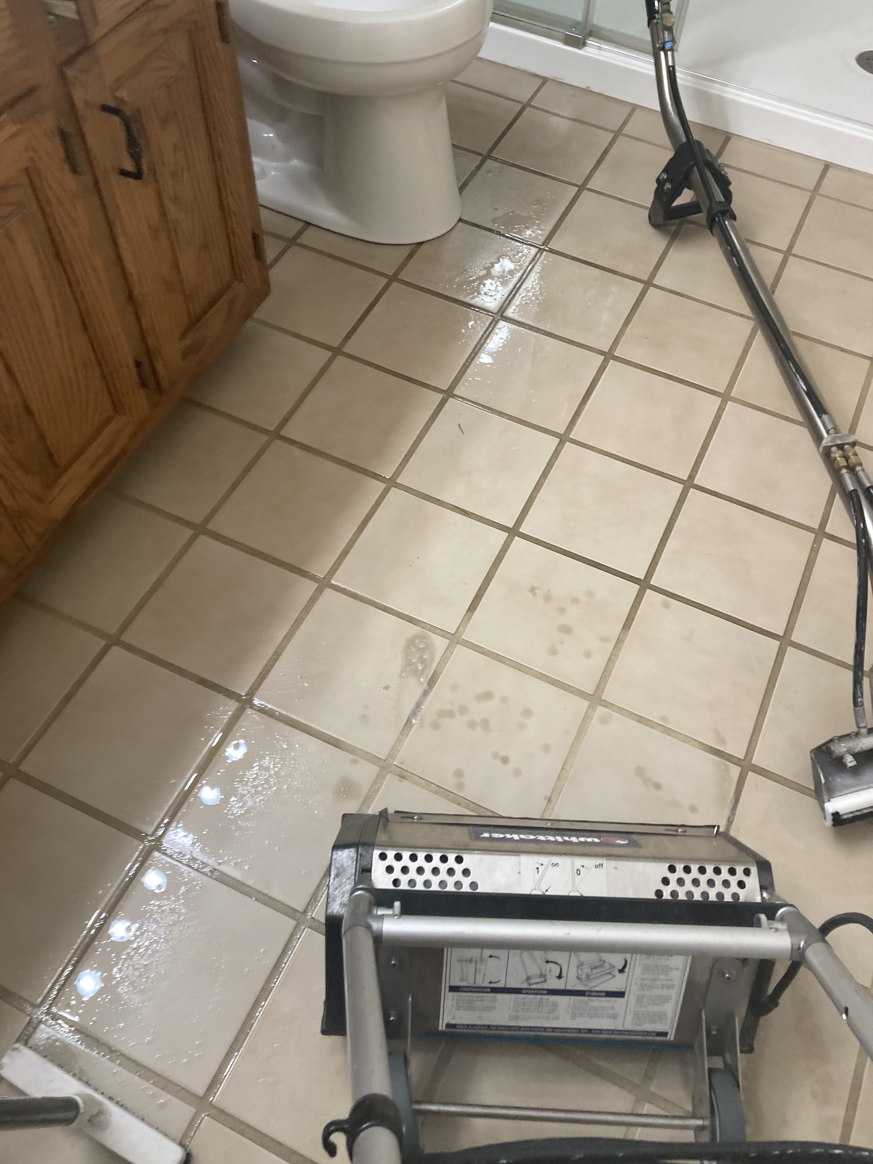

The brush glide on my 12” Dev wand is great. I did two bathrooms and about 1500 sf after my turbo swivel crapped out on me. For what it’s worth I’m gonna notch my wand for sure. The swivel is pretty dope around toilets and baseboards.
