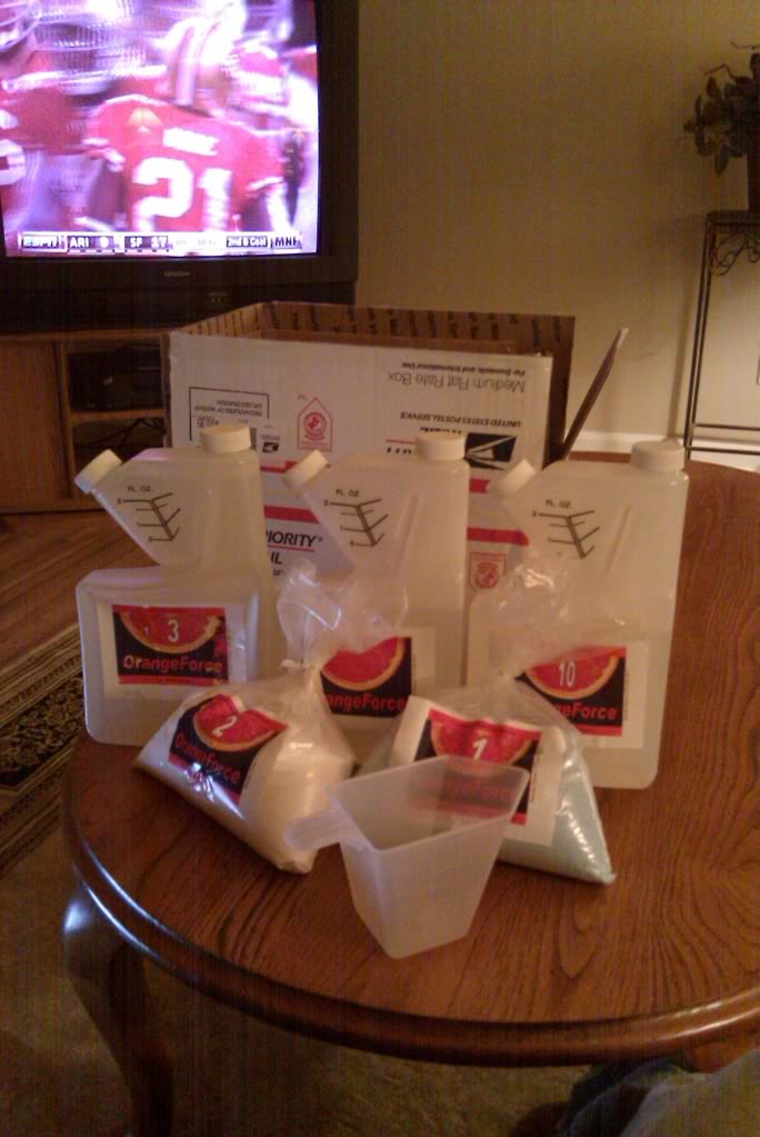

Sample pack just arrived & it was a pleasant surprise, the packaging, containers & instructions are nicely done.

I mixed the chems like the paper said. I have a 2 gallon TWBS sprayer. I used 4 oz of #1, 4 oz of #2 and 2 oz of #3 in the sprayer. I double checked my metering on the rinse because I had to replace a hose on it yesterday. I set it at 4 gallons per hour.
If I goofed something up, I would like to know. I am looking for a good prespray to replace the stuff I use now.

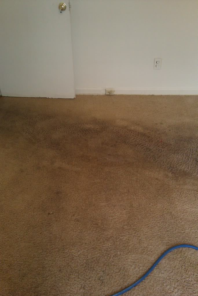

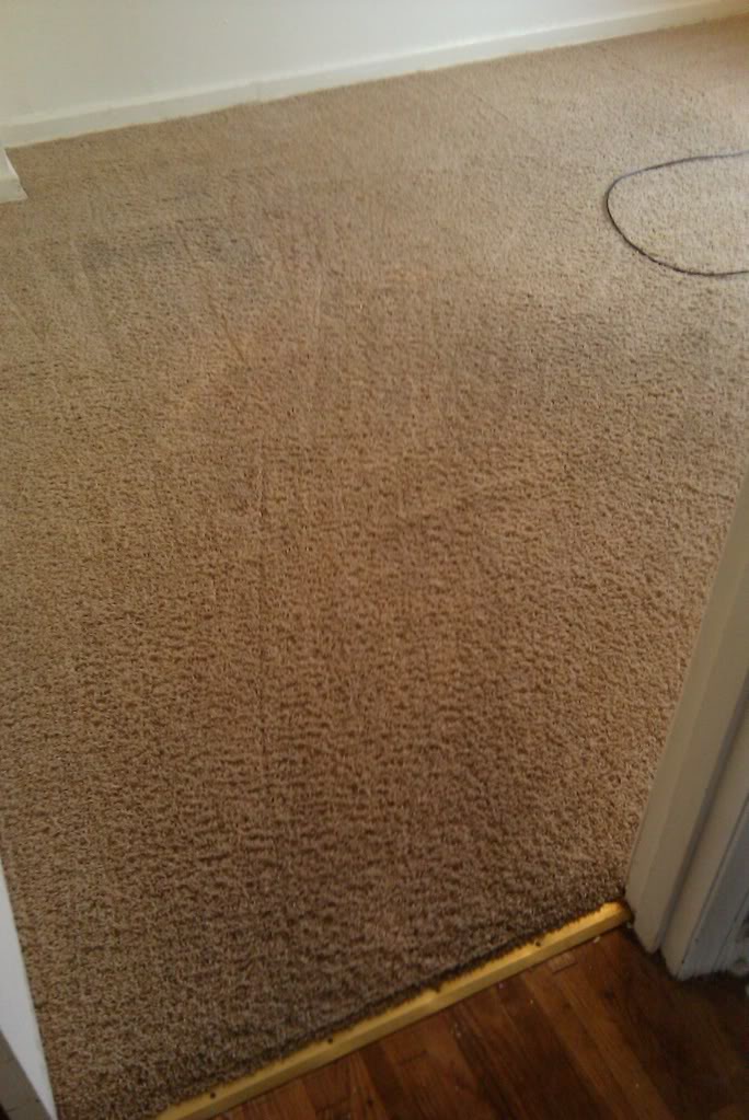

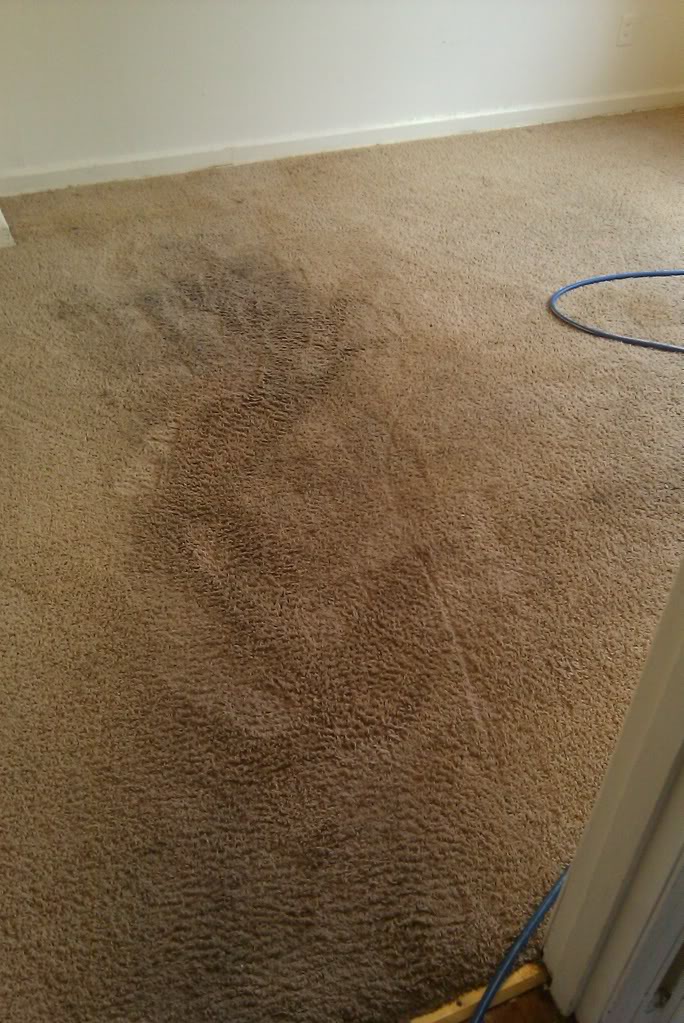

Curt did a good job on the sample pack. If it cleans even halfway decent, I will order some product. The sample pack has enough chemicals to do 4-5 jobs. Everyone else that requested a sample should order some product. Will it replace my Powerstrike/Powerburst combo? No way. The powders and liquids smell great and I think the chems will do a great job. I can see myself using this combo on some jobs though. I did this rental with week old pb/ps combo at 4 oz each in hf. Power was off so spray and suck with less than 5 minute dwell. I believe a good emulsifier and heat will clean most residential carpets so adding this pre-spray should get good results. Again it smells fabulous. I will post pics of Curt’s product later. Prochem ps/pb combo results with no pre-scrub and limited dwell. It works for me.
