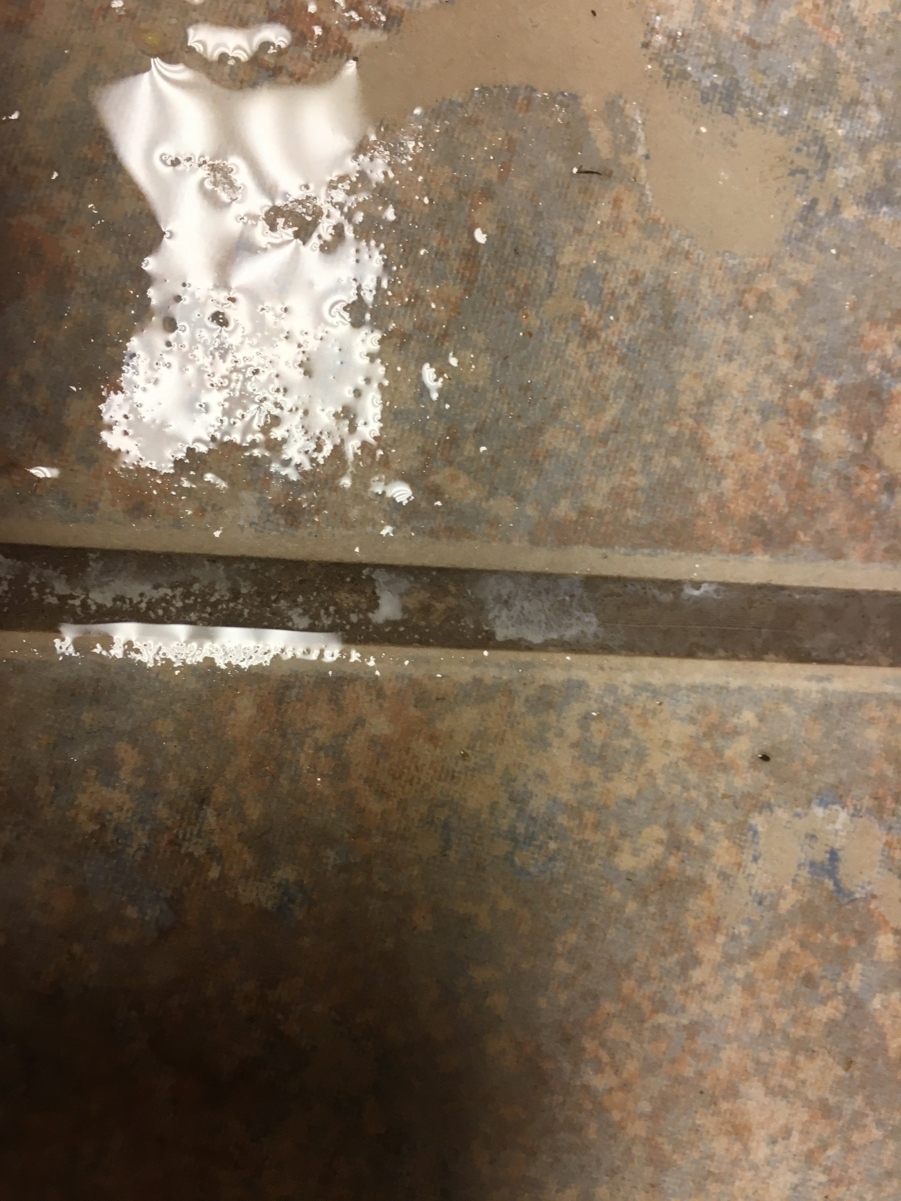

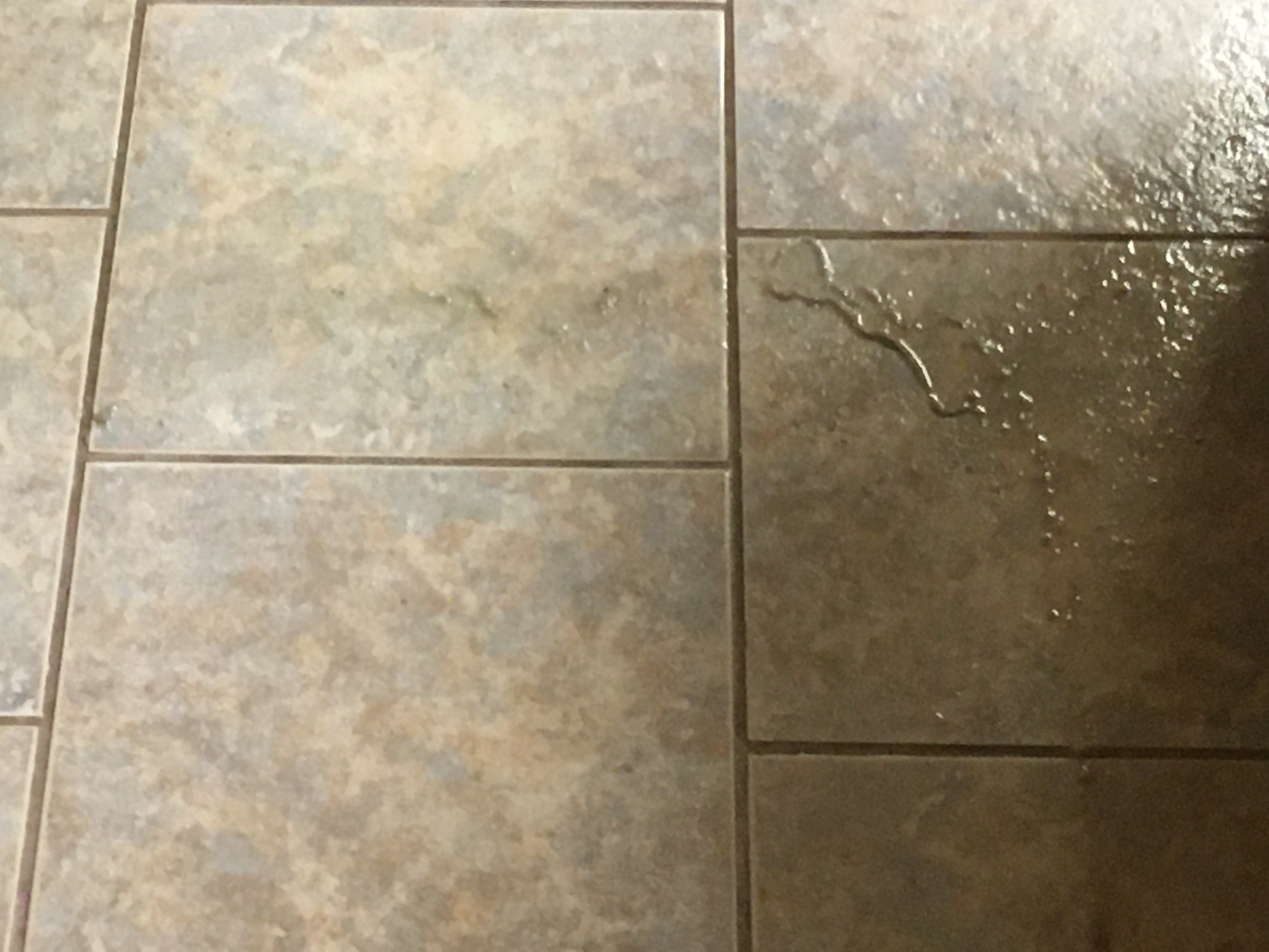

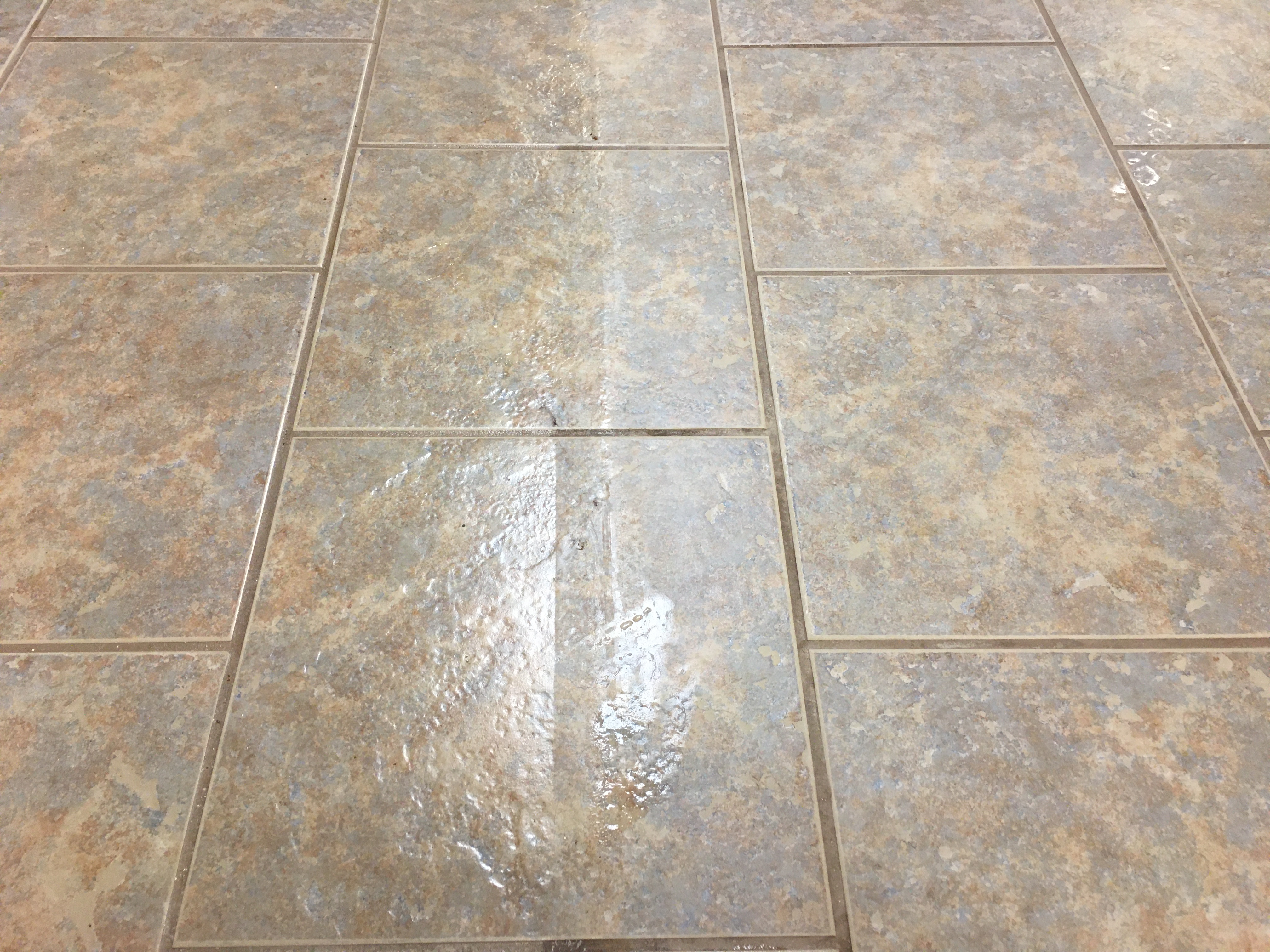

I hAd about 1k sq ft of t&g I had to strip. Turned up the acid rinse to rinse out the stripper
