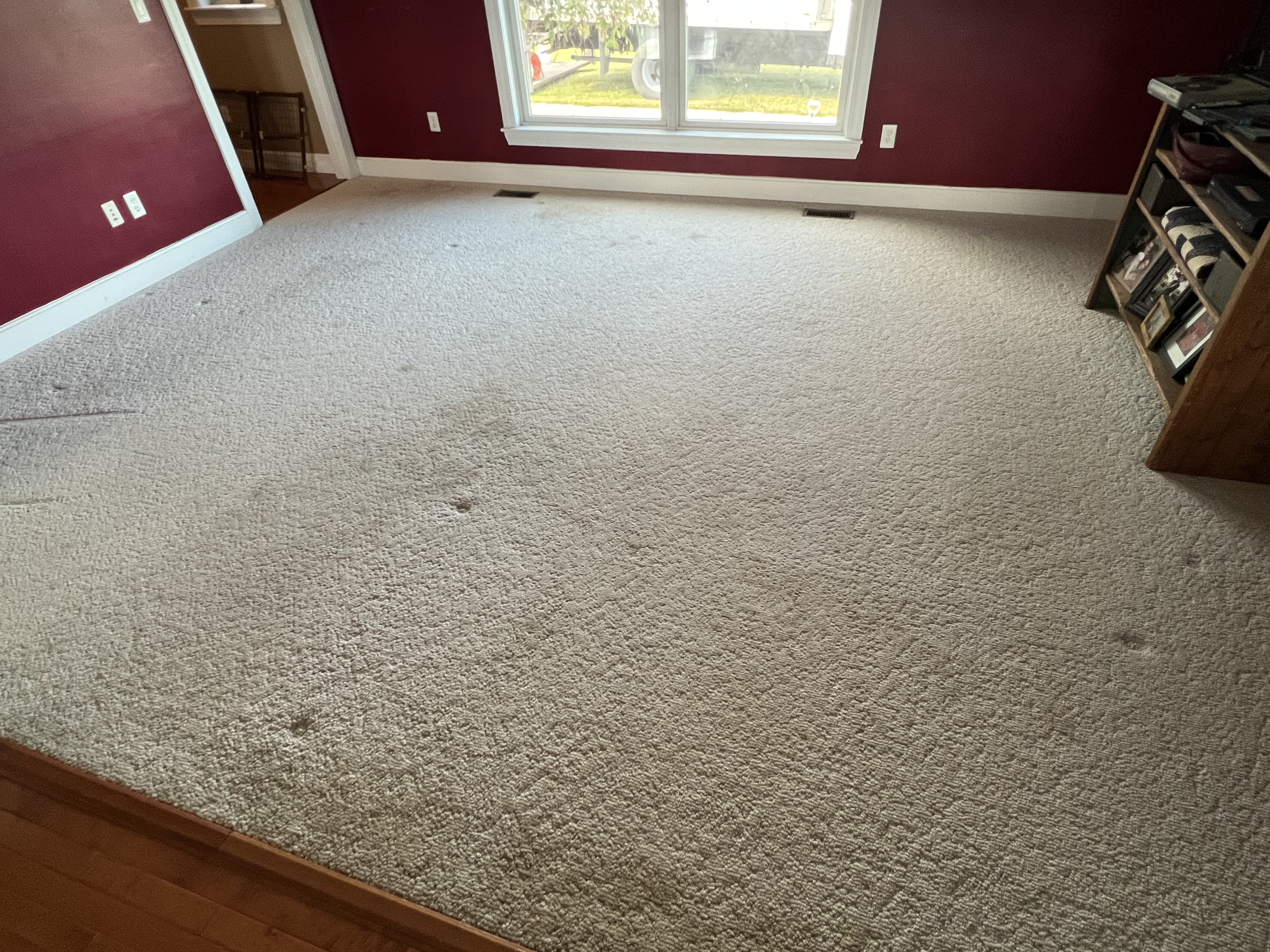

Slow dry times.
Wicking
Browning
Return visits and unhappy customers.
I easily avoided all of these issues yesterday morning on an older, white, dog urine saturated, residential carpet by using plenty of peroxide and a microfiber under the Phoenix.
I knew from experience that there was a strong chance of this stuff reappearing if I tried to HWE it. Because it was bone dry in 30 minutes, I reduced that to zero chance.
Why do I still own a truckmount again?
108E5119-77D8-4F69-8278-A3BDAEDB9D31.jpeg A6C37CDC-CA50-4C0C-BC4E-297BB2518E89.jpeg
115,962
View attachment 118302 View attachment 118303
